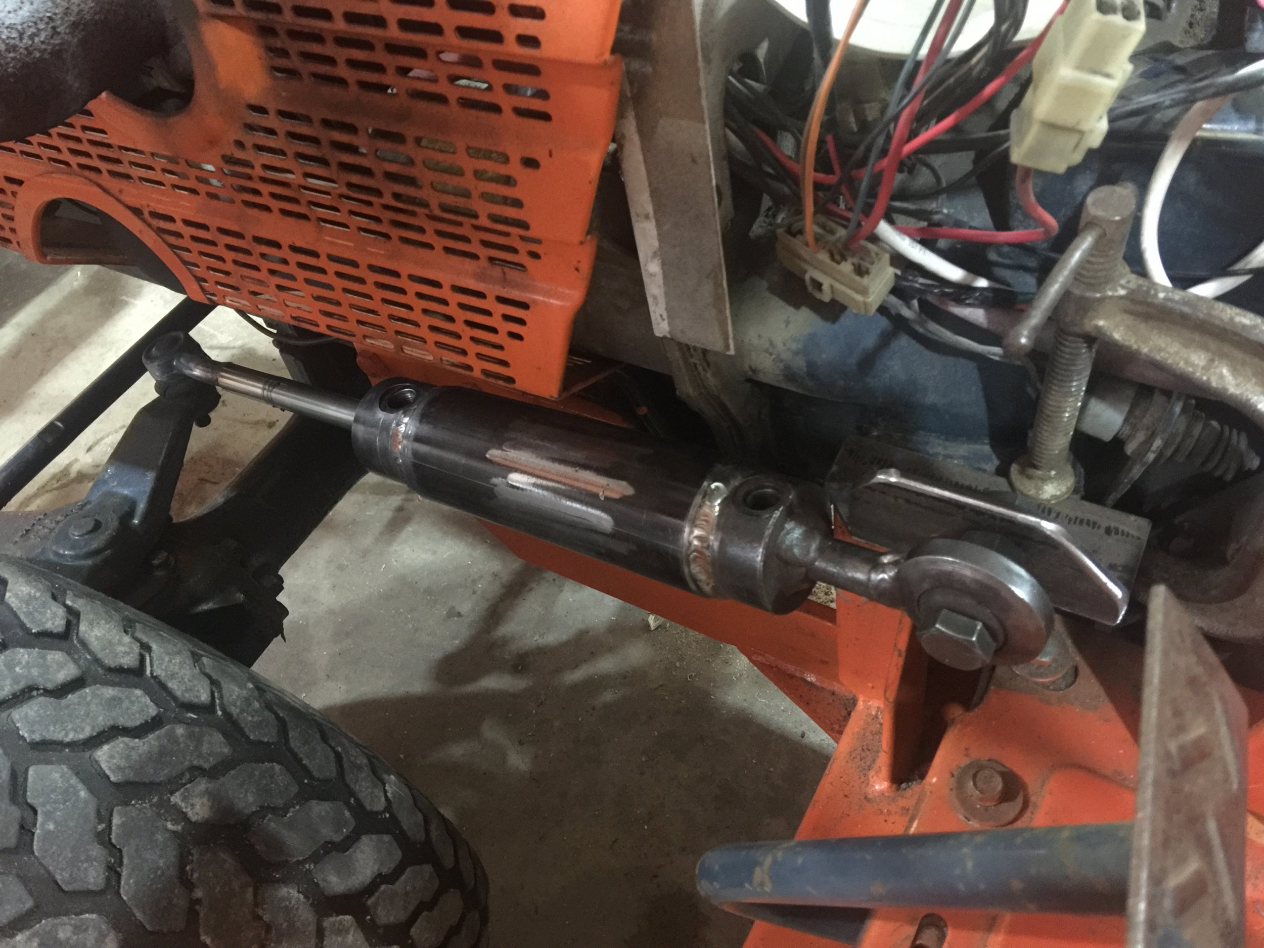

I used a cylinder from a John Deere 318. The cylinder was too short so I bought some honed pipe and extended it to about 8” of stroke. For the end I cut to old manual steering ball joint and welded it to the cylinder rod.

Holding up great. I don't have an hour meter on it but I use it regularly. Power steering is fantastic, no leaks. I'll say it's a bit quick, i think because the kubota has a higher flow rate than the JD318 for power steering. I'm used to it though and I like it. When I get on hte b7200 with factory power steering, it's painfully slow.
That has to do with the ratio between what your steering orbitrol puts out per revolution, and the volumetric capacity of your steering cylinder. So your steering cylinder is a bit small compared to thr JD 318
