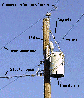

I always thought they carried somewhere around 14,000 volts through them, and then the transformer dropped it down to 240. I also thought that both power lines where hot. The Chief of the Fire Department told me that the top line was hot and the bottom was neutral. I guess he's correct because I still have power to my house with just the one power line. I just don't understand how this works and was hoping somebody could explain it to me in simple terms that I will understand.
My guess is there's a 7200V single phase running on the top wire down your road.
The bottom wire is ground. That's the broken wire.
The single phase 7200V wire feeds a transformer for your house (or several houses if you have close neighbors).
From that transformer there are three wires running to your house.
1-120V
2-120V
3-neutral
You still have power because the transformer still has 7200V from the top wire.
Where is your transformer located?
   / Power Line to my house was broken #25
Like this...

Looks like this, except the power lines end at my place. I am the only home on this line. I had it installed when I built the house.
It's 2:30 pm, and exactly 24 hours since I called 911. The line is still on the ground.
I'm trying to find the number to call Oncor myself.

Did my explanation about why you still have power make sense? It's sometimes hard to put it in writing VS voice conversation.
Also, where's your transformer?
