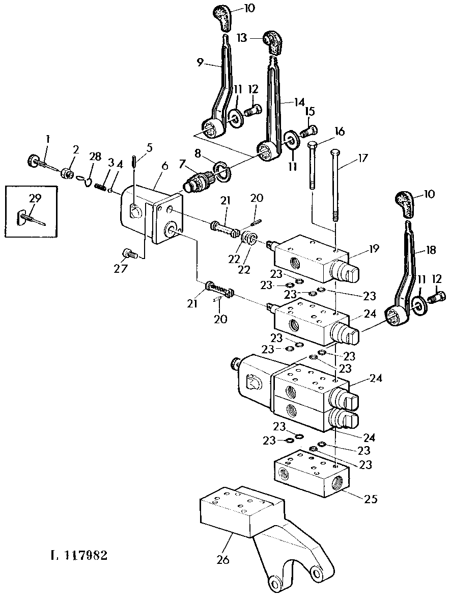

Well, this afternoon I made the first run with my splitter connected to the JD. This was principally to check it functioned OK mechanically.
To avoid adding complication I chose to connect the cylinder directly to the tractor's on board spool. Results were positive :)
Observations :
The tractor control lever will stay in either forward or back position without the need to be held there.
When the cylinder reaches full travel the lever stays put, but the pressure clearly drops off. What does this tell us about the hydraulic valve type?
This behaviour makes me wonder whether an external valve could in fact be used without any changes or additions to the circuit.

   / Power Beyond to run a log splitter on JD 1640 #18
Observations :
The remote lever on the 1640 should kick back into neutral after cylinder reaches its full travel either direction. I looked in parts catalog and I think your tractor will have spool valves.
