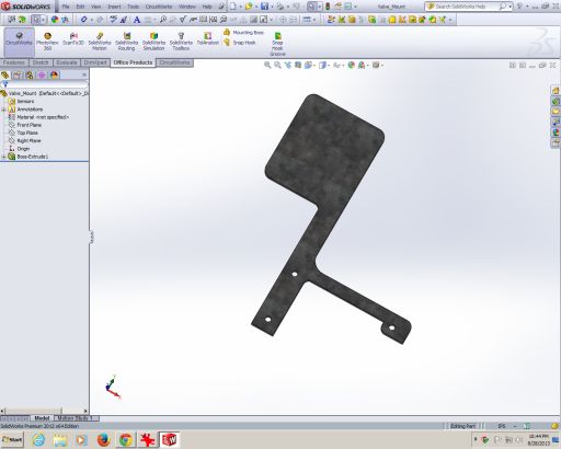

Have one hose with a bad crimp that leaks. Also a possible fitting leak, and the plan is to have it all working by Friday. Will post more pics at that time.

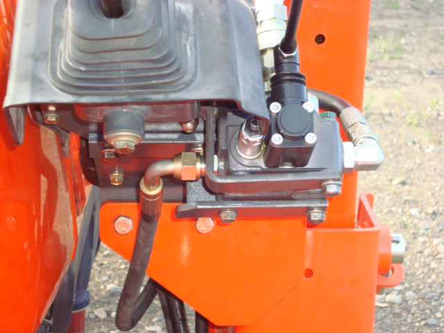

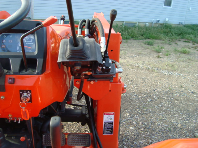

Rayster, I'm a little late to reply here, but I went the same basic way that I think your going and just simply added a Prince valve next to the FEL valve. Simple, quick, dirty and works well. (L3400)
Steve

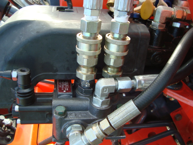

Yeah Steve, that is exactly what I have done. My quick disconnects are on the grapple. So that if I have a rear attachment I can just reroute my hoses to the back with ease.
Thanks for the pictures.

Rayster. I had a need for a rear remote and went this route.
http://www.tractorbynet.com/forums/hydraulics/279524-kubota-l-series-rear-remote.html
I had thought that if I needed a FEL remote then I would just run a pair of hoses to the front off of the ROPS mounted couplers. Then I built a grapple and decided that it wasnt worth the effort messing around with a pair of long hoses so I added the extra valve next to the loader valve.
If you get some sort of rear attachment that needs hydraulic power then you might find that adding a rear remote (or two) is far better then messing with some long hoses. Just my .02 cents. Post some pictures when your done, I'd like to see how you did yours.
