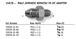

The aux still has the same pressure rating i'm assuming.. and could be used for a loader? i'm not sure really. But if so, couldn't I use this adapter
or this
The steering return into the sump is m22 1.5 as well.

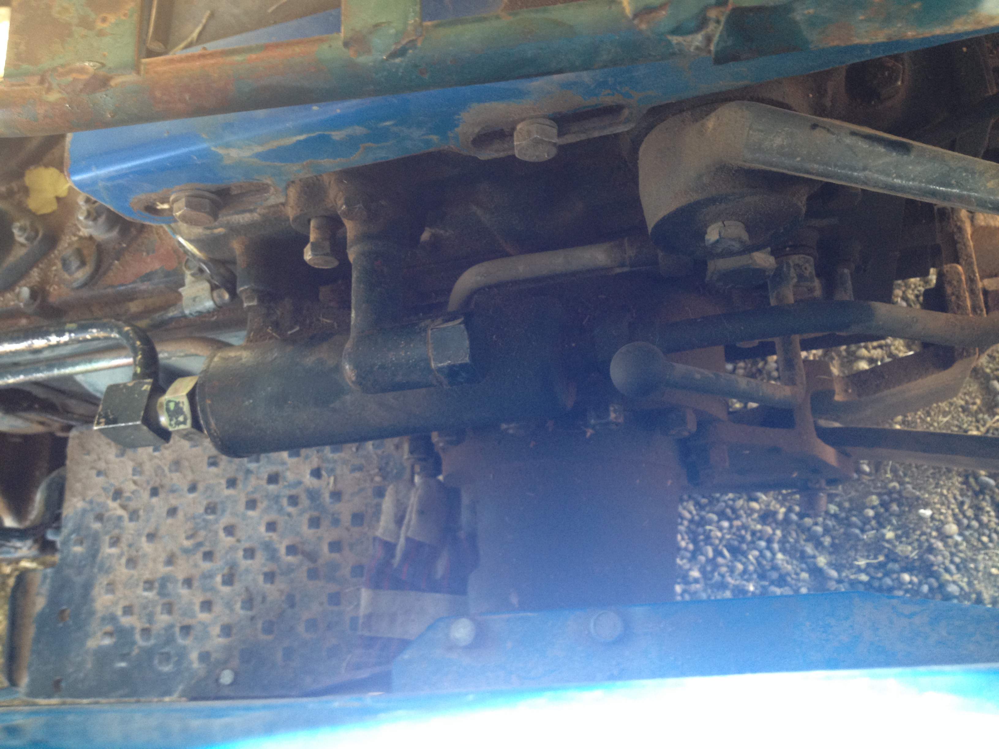

Would you plumb a loader in-line to the system via the pump that is used for the steering cylinder? On this tractor there is a rear which powers the 3pt and a front which powers the steering. The unfortunate thing is that it's welded metal piping from the pump in the front to the steering column valve. I haven't taken any pipes (hoses) off of it yet but i guess i'll have to.
Each pipe has a square box like end that feeds into the steering valve. No idea why but i'll start looking into it.
/ Power beyond 254 #7
The steering pump is for te steering only. It doesn't have enough flow for a loader, too. You would also need a priority valve so that the steering didn't fai when using the loader. So, bad idea. The other pump will run the loader and the TPH with no problem. Typically, one plumbs the pump to the loader and then to the TPH after the FEL.
