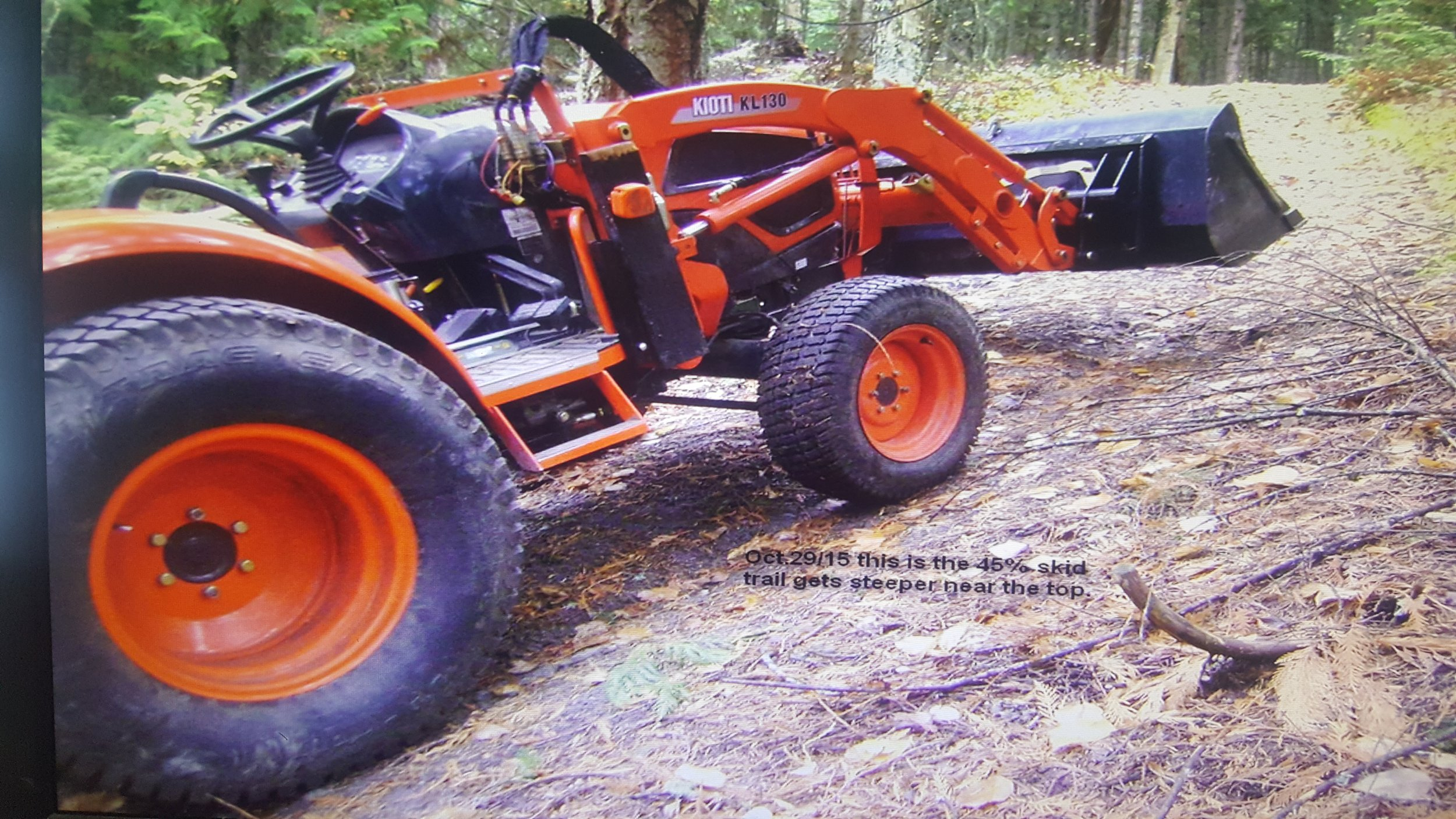

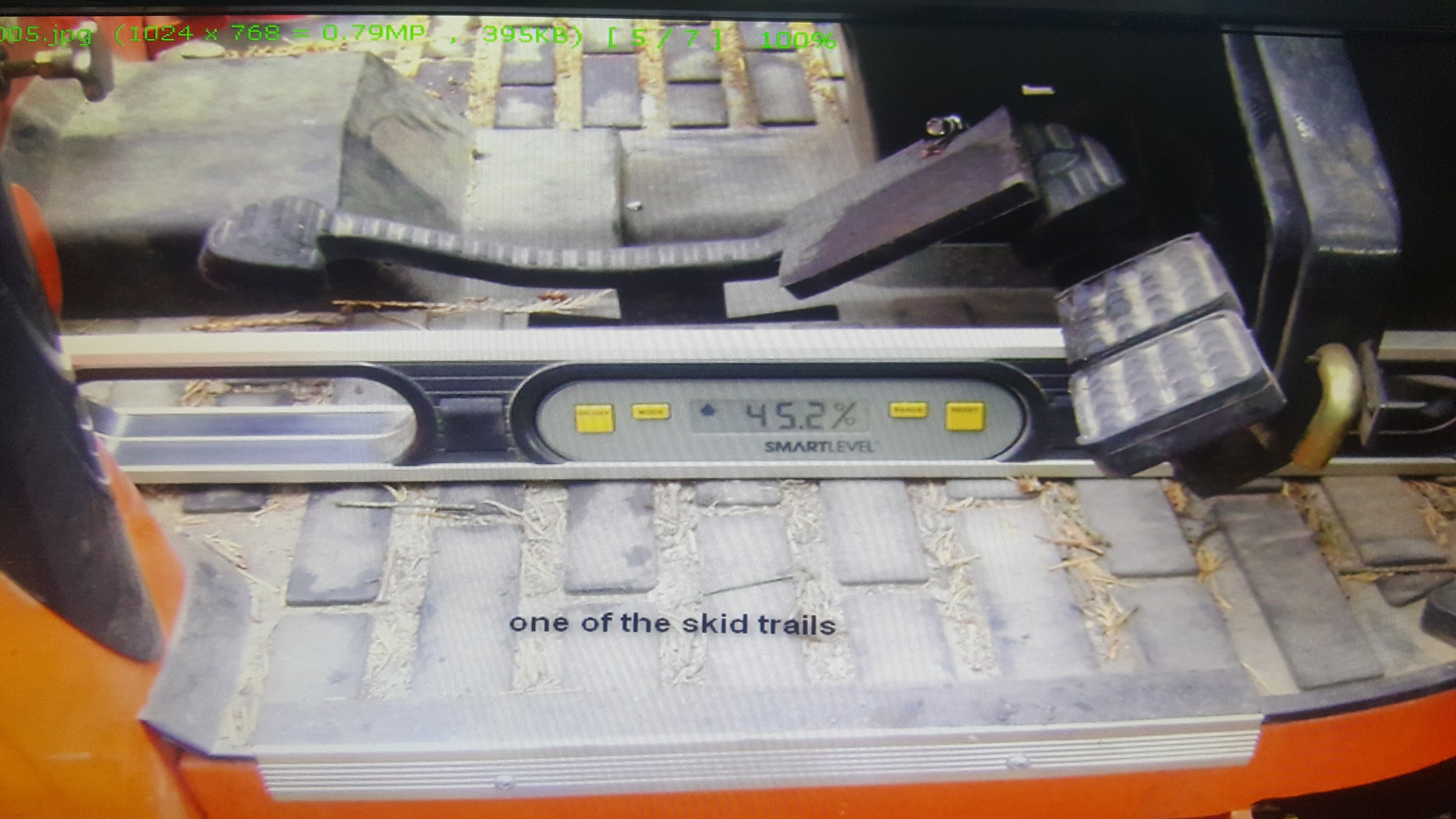

Did this on mine, night and day difference. High gear is actually useable, no issues going straight up my 25-35 degree hill in Medium, and the rotary cutter has no issue with 4-5' wetlands grass at full speed in Medium.

After watching this guys video and a similar one on a 25hp tractor with the “dull orange color”, I went ahead and cut the cap off the adjustment screw with an oscillating tool which was way easier compared to the dremil and grinding tools the other guys used. Anyway, I had used a big hill in front of the house in high gear to judge the increase in performance. Before the adjustment I could barely make it up in high while losing 500-600 rpm off the 2600 I started at. I ended up with the adjustment screw out 2.5 turns and now lose less than 50 rpm’s. I don’t notice any smoke but I can smell it more under load so I didn’t try turning it out anymore. I also noticed diminishing results the further I backed off the adjustment. I think 1.5 turns gave the most dramatic results. The tractor feels night and day to me now. It always felt heavy and sluggish before in anything but low gear. It now feels like the power and weight of this tractor fit. Oh, my tractor is a 2016 hst with 450hrs on it.
