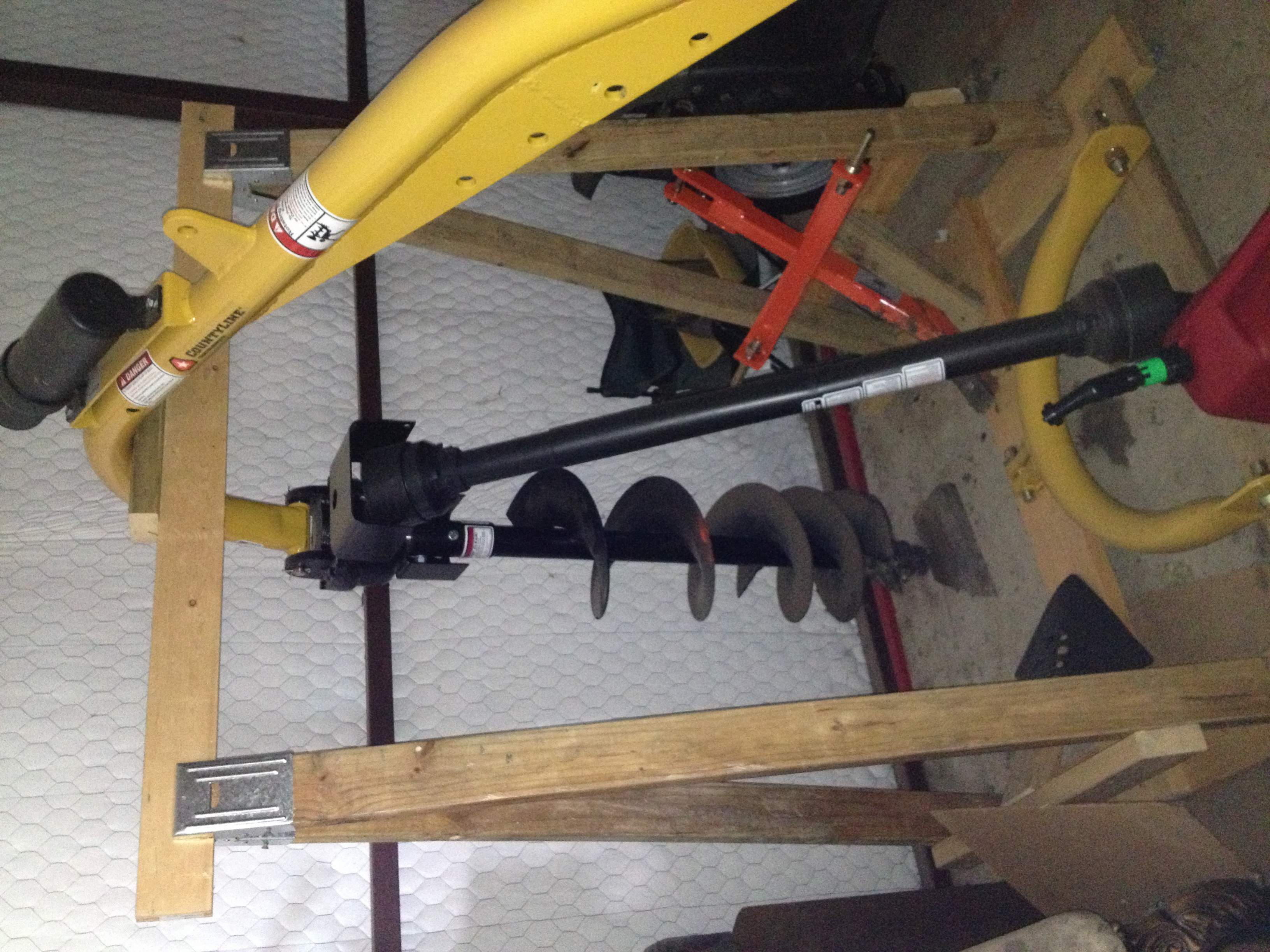

What u say is exactly why I cobbled this together in a couple hours with scrap 2x4s laying around.
Simple A frame with saw horse joints at the top. The top bar isn't attached, just laying in the saw horse joints. Once hooked up, I raise the PHD and remove the top board and drive off.
It's on casters so very easy to roll up to 3pt. It has just enough auger bit weight to balance it and hold it in place.
Not the prettiest but functional.
The other thing I've seen folks do is just drill it into the ground and leave it half burried. I didn't like that option :)
HTH

I like your invention Jwclark! We have the same Posthole digger.

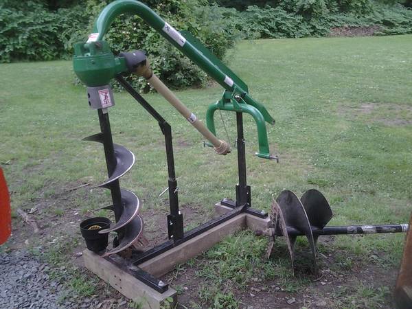

Here's a nice stand for a PHD. Not sure if its something fabbed up by the owner or if it was purchased with the PHD, but looks to be adjustable for different models or to allow it to align with various size tractors I would guess.
Not much material there, should be easy to duplicate. I think I would have made those 4x4s a little wider for more stability, at least as wide as possible on the front so as not to interfere with the rear tires. The rear 4x4 under the auger could easily be a foot or more wider.
Since this is a CL listing (not mine) I have included one of the photos in my post so when the CL Ad is gone there will still be some image here. But there are multiple photos from all angles in the CL post to evaluate building your own from.
P.T.O Posthole Auger / Frontier
Edit: did some searching and it turns out this stand is made by Rotomec. Here's a link to their manual which covers the stand, the optional downforce kit, and their positioning handle.
Didn't find a price though.
http://www.rotomec.com/usa/pdf/Rotomec USA PHD Accessories (US) 10-2008.pdf
