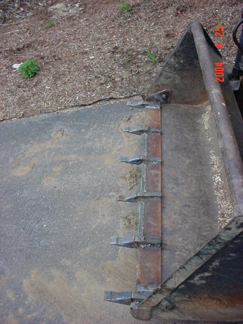

Here's mine. Welded two pieces of steel into a sharp "V" and welded shanks to it. Replaceable teeth are roll-pinned on.............chim

Chim:
What size steel did you weld together to form the "V" ? Did you grind the front edge sharpe?
Jim
   / post your pictures of teeth bars #26

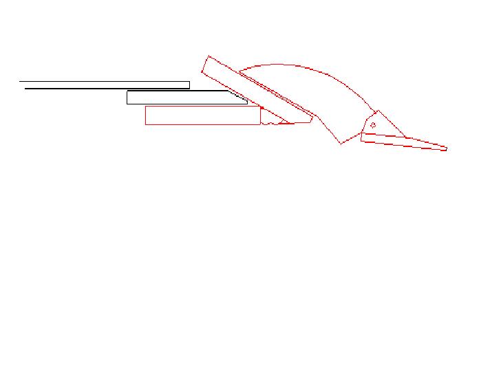

I used 3/8" X 2-1/2" flat stock I found lying around in the shop. The one piece (leading edge) is ground a bit, and the other is welded to it as in the sketch. H0ope this helps.........chim

</font><font color="blue" class="small">( Welded two pieces of steel into a sharp "V" and welded shanks to it. chim )</font>
I like Chim's version with the "V" as it protects the bucket's edge. Good job Chim!

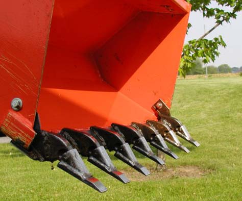

</font><font color="blue" class="small">( I made this tooth bar. Got the shanks and teeth from the Case Heavy equipment dealer. With so much talk about toothbars I just had to make one. )</font>
Jim, nice job on the toothbar. I went out his weekend and bought the same shanks / teeth / pins from the local case dealer. Will get a strip of 3/8" steel next week and hopefully mine will turn out as nice as yours.
Did you use a stick welder for this project? I'm pretty new to welding and have a wire feed welder (Lincoln SP175T -- see here for info) that I'm not sure would be suitable for this project. What do you or anyone else think?
