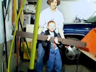

well, here is the picture book of mounting the forks
   / POST YOUR PICTURES OF FORKS? #29
They're not too heavy for my best bud
Or my beautiful, helpful model/w3tcompact/icons/wink.gif
They slide right on...
Install seperately to any width
The load binders slide into the hand holds -
no eyes or chain links on the top!
Both installed and under tension - less than 2 minutes,
light enough for a 6 year old to carry!
The final product!!
