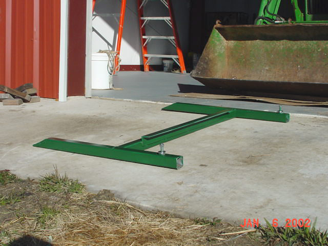

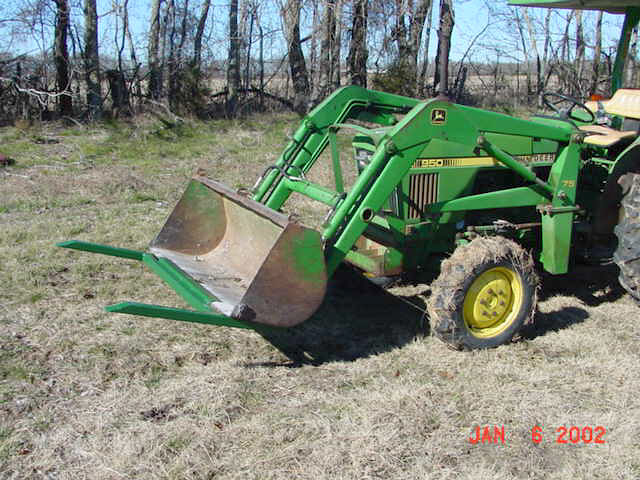

Here is something I made cheap, simple, and quick. About $15 dollars new steel and about 2 hours work. See also next attachment. I don't have a quick attach FEL. My bucket had 2 holes already in it (hmmm, reminds me of a song /w3tcompact/icons/smile.gif). I used those to determine my spacing. I just needed something to make carrying logs, lumber, brush, etc. easier.
   / POST YOUR PICTURES OF FORKS? #18
The forks are made of 2x2x11ga sq tube and 2x2x3/16 angle. I don't know the lifting capacity, but I can stand near the end of a fork with no noticeable deflection. See one more attachment after this.

That a pretty good solution, low cost and easy. Now you just have to paint your bucket to match your forks! ;)
