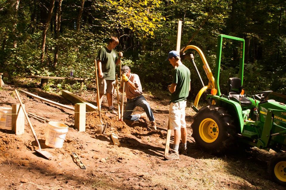

Hey all, I'm working with my son on his Eagle Scout project. Replacing benches and need 27 holes dug! Borrowed the neighbors PHD and have had some limited success thus far. For our next work-day, I want to improve our accuracy so we have less "tuning" to do by hand. Any experts with tips? I know the top of the auger moves away from the tractor as it swings down through it's arc and we tried compensating for this but maybe this caused more problems than it solved? I should mention, the benches are for a campfire bowl and are on a slope. Tractor is facing directly down-slope during operation. 12 inch auger for 6X6 posts, 48 inches deep (max of PHD).
So far our process has been to start the auger on the mark and move the tractor forward partway through the hole. I suspect some of our problems are accuracy of marks but anything we can do to help the auger dig precisely will save time. Any and all tips welcome!
A couple of photos: Worksite. Worksite visitor. My 2 sons, Eagle and Eagle candidate
