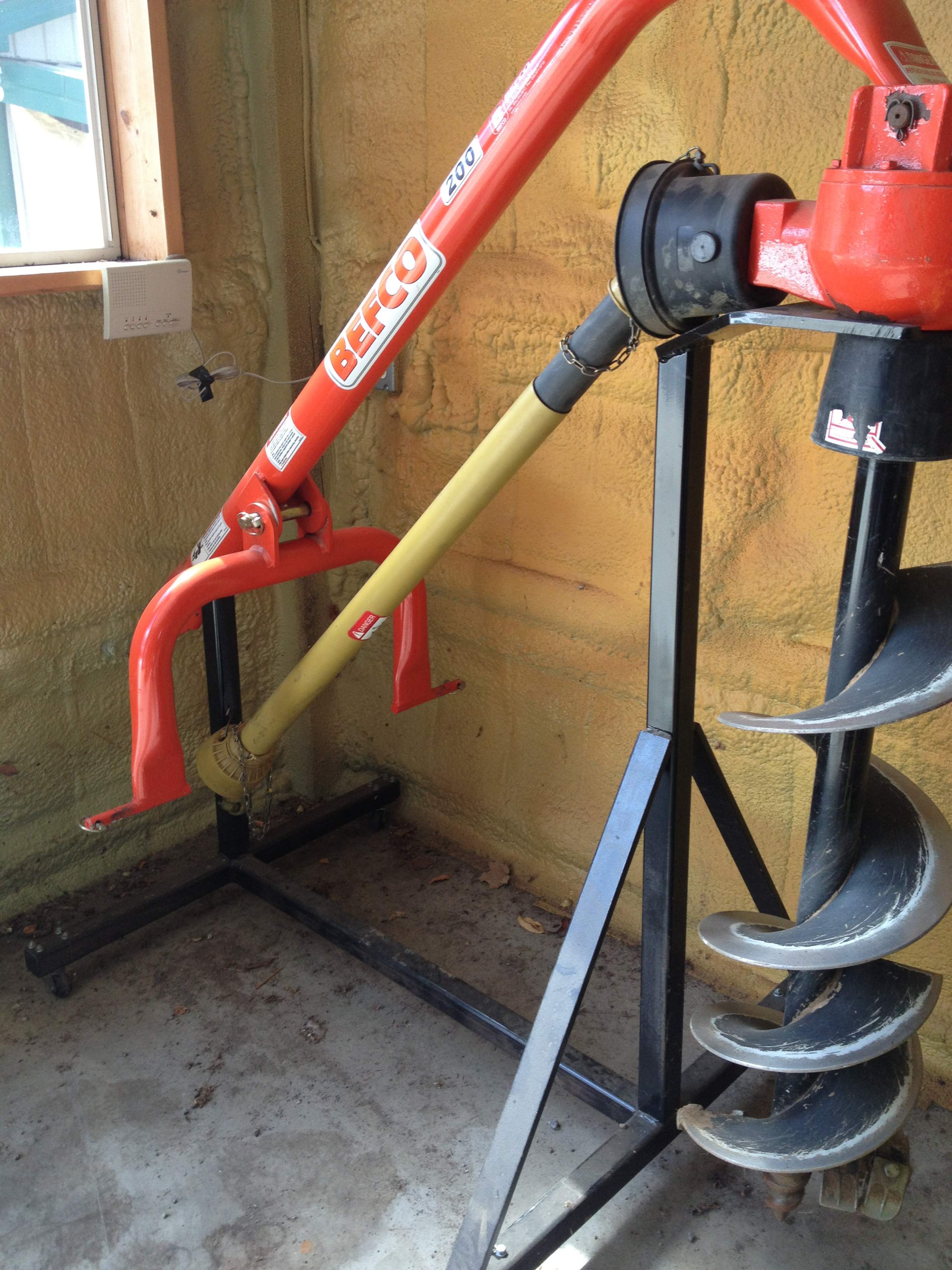

So I mounted the post hole auger on the tractor this weekend for the first time. It was a bit of a struggle. Does anyone have a picture of a stand you're using to make this a bit easier.
Here is mine with wheels.

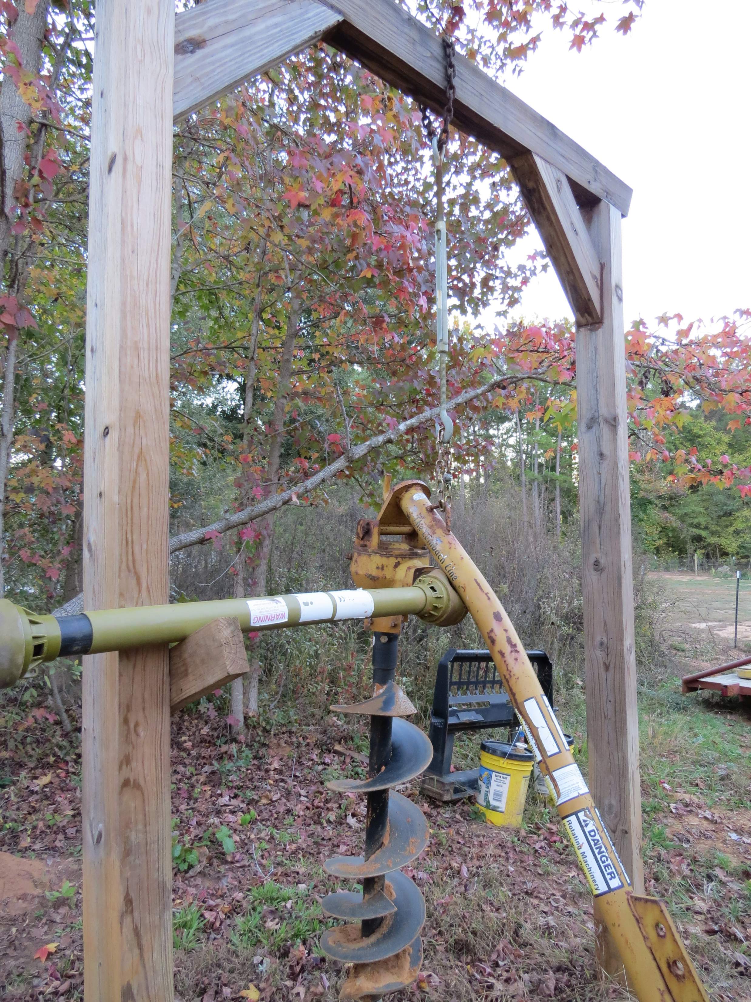

I've done my from a tree branch, some rafters and just drilled it into the ground in the past. This is my current setup.

/ Post hole auger stand #13
There are lots of ways to do it. Mine works really well and is fast and very little effort to hook up, with the casters on the bottom it rolls right into place. I did not make it, it was sitting on the side of the road on garbage day, so I grabbed it. I believe it was for a store or drycleaner or something, for hanging garments on. Could easily be made out of plywood and 2x4's though.

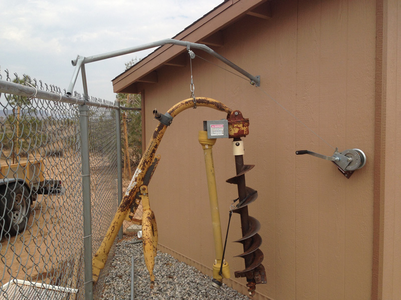

/ Post hole auger stand #14
I hung mine too with a winch for easy adjustment.

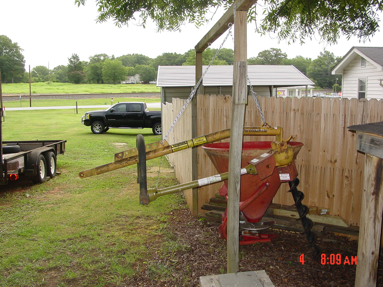

/ Post hole auger stand #15
Sorry, coming in this thread late but I wasn't able to get a picture of my stand until yesterday. I park my PHD like Eddie W. has his, suspended from overhead with a board. Imho, this setup works the best as it allows easy movement in any direction to help you get it lined up.
