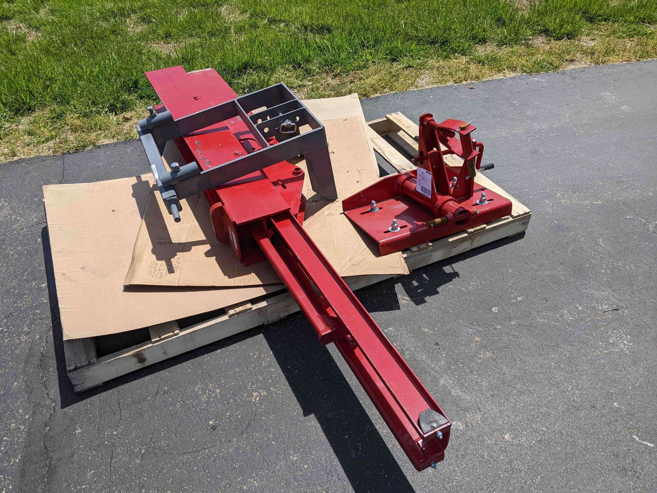

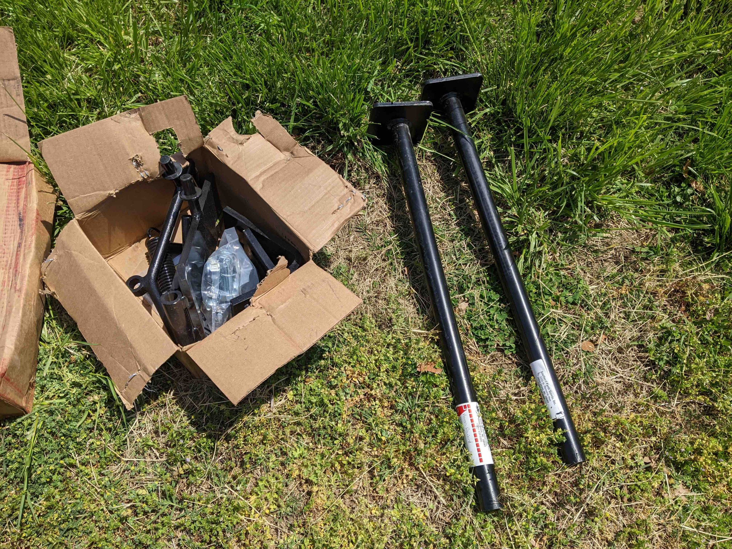

Well, I took the plunge and bought the HD-8 post driver. I'll post some additional info here for anyone else who may be considering this. The plot spoiler is, it works and I feel pretty good about it so far. I just drove my first three posts yesterday so it is too early for a verdict, but I think this could really accelerate my fence building. More to come...
/ Post Driver for SA324/424
I did a little research before I bought the post driver. I called Shaver and talked to (Adam?) about the limited category 1 concern. He gave me a measurement to verify on my three point hitch, and this made me feel pretty confident that I would have enough clearance.
I also spoke to an experienced mechanic at my local Yanmar dealer about using a post driver on the SA324, and he thought it was reasonable to try a smaller-sized modern post driver with the tractor. He seemed to understand exactly what the concerns were regarding the hydraulic system...the requirements on the supply and return side. And he thought it might not destroy the tractor!

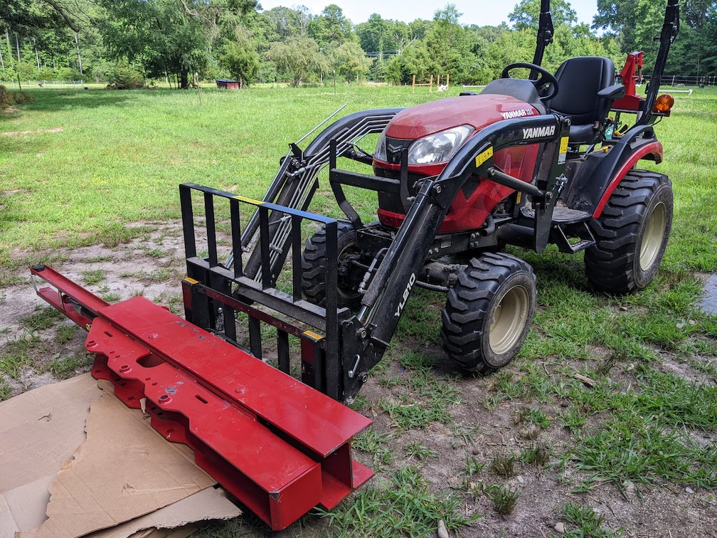

So, I decided to go for it. I couldn't find any used models in good condition. I found the best deal on a new HD-8 at everythingattachments.com in NC. It was just over $3.9k shipped to my house in MD. I thought I was going to need the tractor and pallet forks to get it off the truck, but while I was going for the tractor, the delivery guy maneuvered it onto the lift gate and lowered it to the ground.
The main assembly is long and heavy, and comes on a double size pallet. The paint was badly scraped in places. I signed for it, even though I had no way of knowing I had all the parts. I took pictures of everything. Then I maneuvered the long heavy red piece on the pallet and used the tractor to move it into the garage until I had time to assemble it. Here are some photos from the delivery day. In my next post, I'll talk about putting it together.

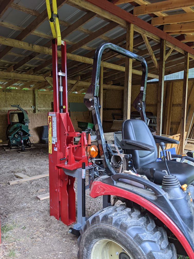

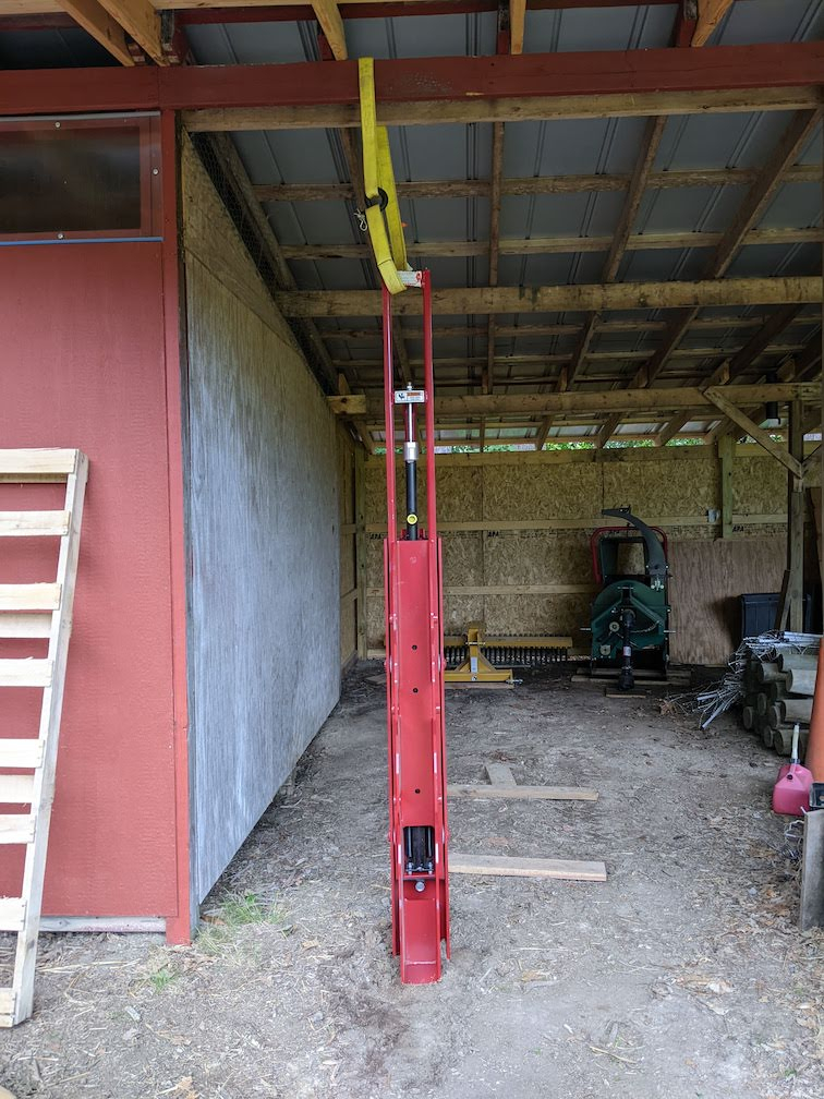

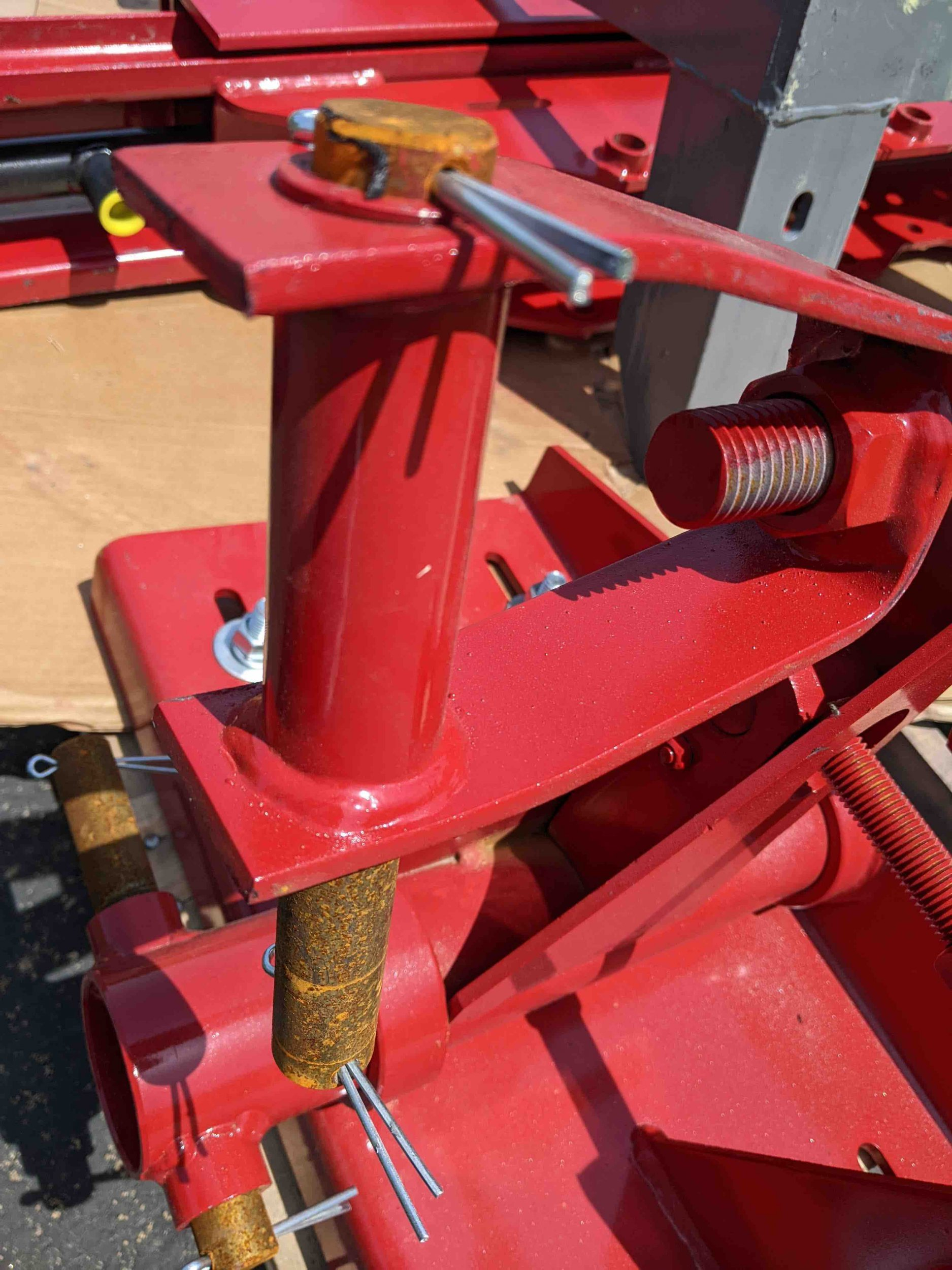

Assembly of the HD-8 took a little time and care. I bolted the base plate to the three-pt hitch mount in my garage. I couldn't do much more in the garage, or it would be too tall to drive out the garage door. I recommend thinking about where you're going to store it before you buy, and make sure you have enough height. I think I measured it at 96". The manual states 88" but this is incorrect. The manual has a lot of outdated info.
I used the tractor and forks to carry the main carriage and ram assembly on the pallet to the tractor shed. Then I swiveled it so I could lift it up high and strap the top to a beam. This allowed me to safely position the main carriage upright for attachment to the section already on the tractor hitch. It wasn't too hard to attach, and I was able to do it alone.
There are two large pins that attach the tilting assembly to the main carriage. You can choose between upper and lower attachment points on the main carriage. The lower ones are apparently for driving 10 ft posts, or for attaching to the front of a small tractor. The upper points worked great for me. I have at least a foot of ground clearance with the 3-pt all the way up. And I can lower it to just fit under the overhang of my shed. I couldn't have asked for a better fit...what a relief!
In the next post, I'll talk about the hydraulics.

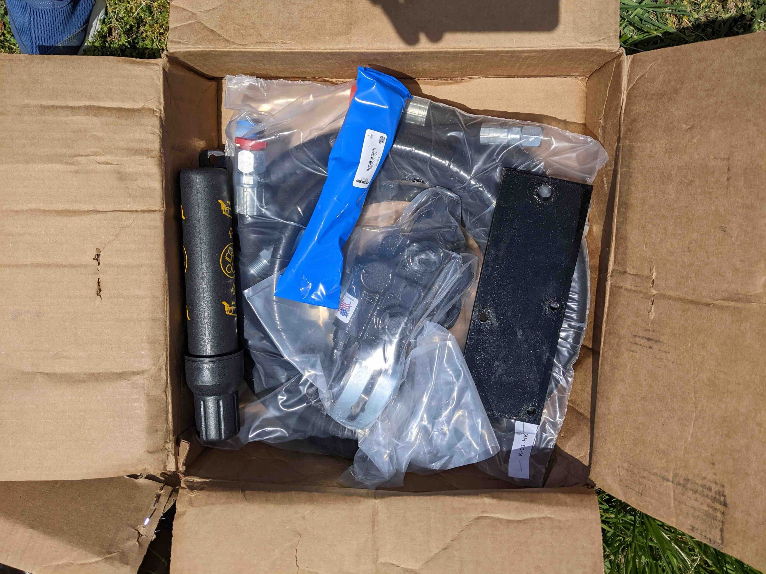

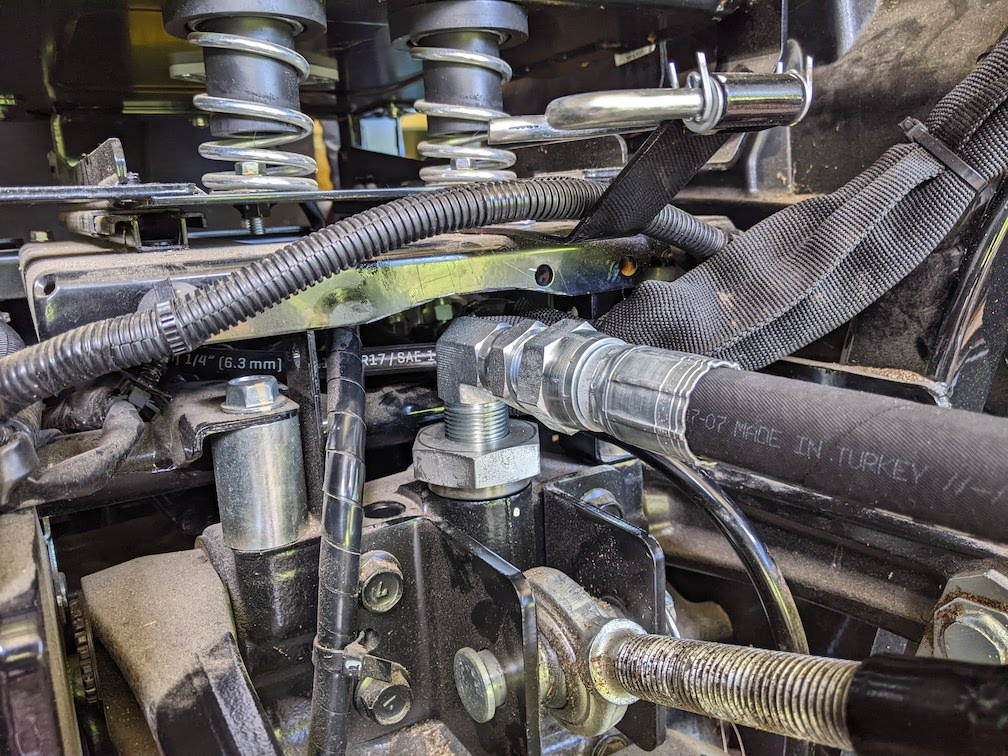

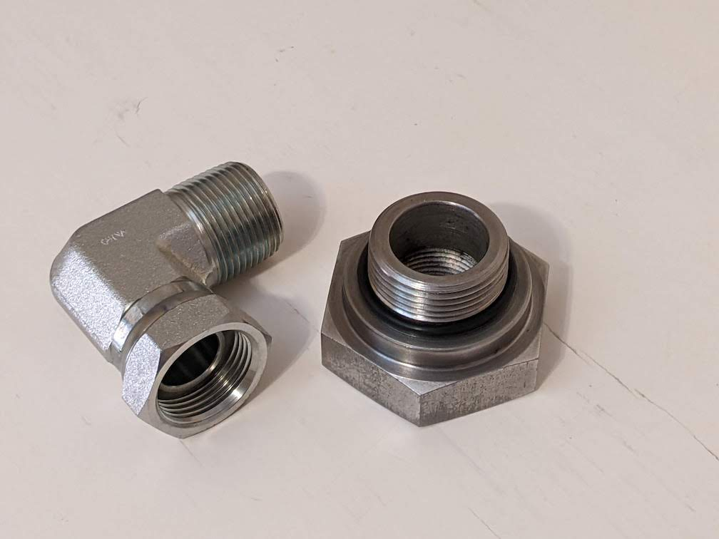

Before I installed the post driver, I had a dual rear remote valve installed by the Yanmar dealer. The mechanic and I discussed that a power beyond was really the ideal way to power a post driver, but I decided to get the dual remote valve instead, in case I want it for other stuff in the future. The downside is, I have to rig the lever up or down while operating the post driver, and accept a slightly lower flow rate. But it worked fine during my trial run, so I think I'm happy with the decision.
Shaver provided all three hoses needed for the HD-8, and the fittings to connect them to the control valve on the driver. I had to purchase a quick disconnect fitting to connect the supply hose to the remote valve, and also an adapter to connect the discharge hose to the hydraulic tank (in place of the cap).
Shaver offers adapters for various tractor models, but when I talked to them their list only had the old Yanmar model numbers, so I didn't buy one. The Yanmar mechanic knew exactly what I needed and called around locally to find an adapter. One end has male threads which match the hydraulic reservoir fill port, and the other end has female threads for a 3/4" hydraulic fitting. I also used a 3/4" 90 deg bend with swivel to attach to the discharge hose.
There wasn't quite enough clearance above the fill port to install these, so I trimmed a little metal to make them fit. See the pictures below. In the next post, I'll cover operating it.
