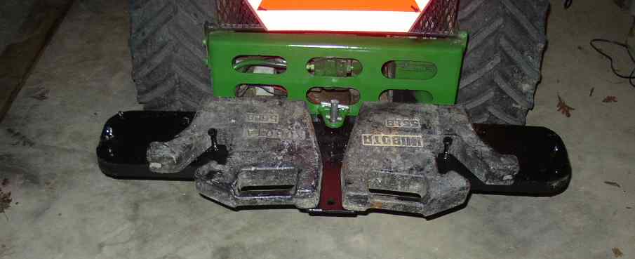

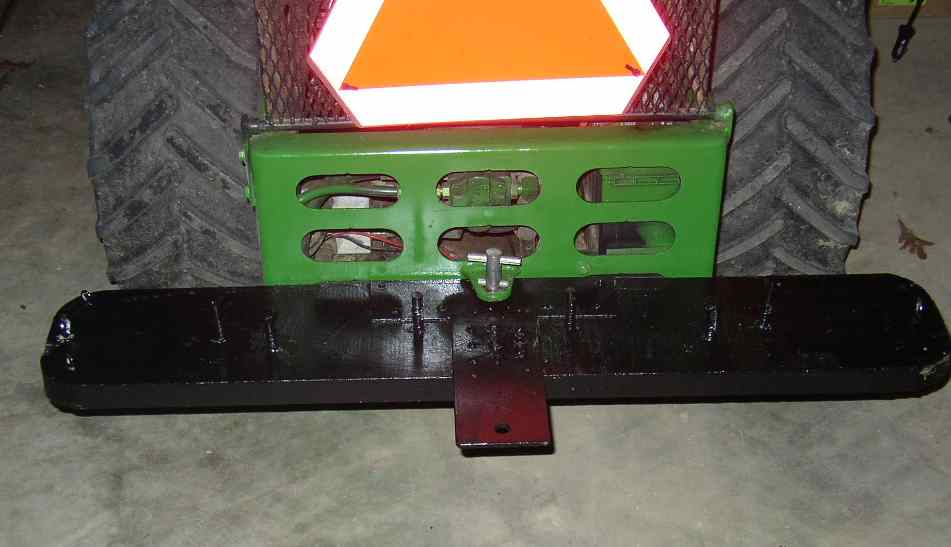

Just a reminder, per our conversation, put some weights on the back. Here is a picture of the bumper that I am going to give you. It is not as clean now as the pictures show, but it is in good shape. The weights are not included.
I don't think the repair guys did anything to cause this fuel problem. Just some trash in the tank. Bring the PT by and we can fix it. You can leave it here while you are at JMU and pick it up on your way back.
