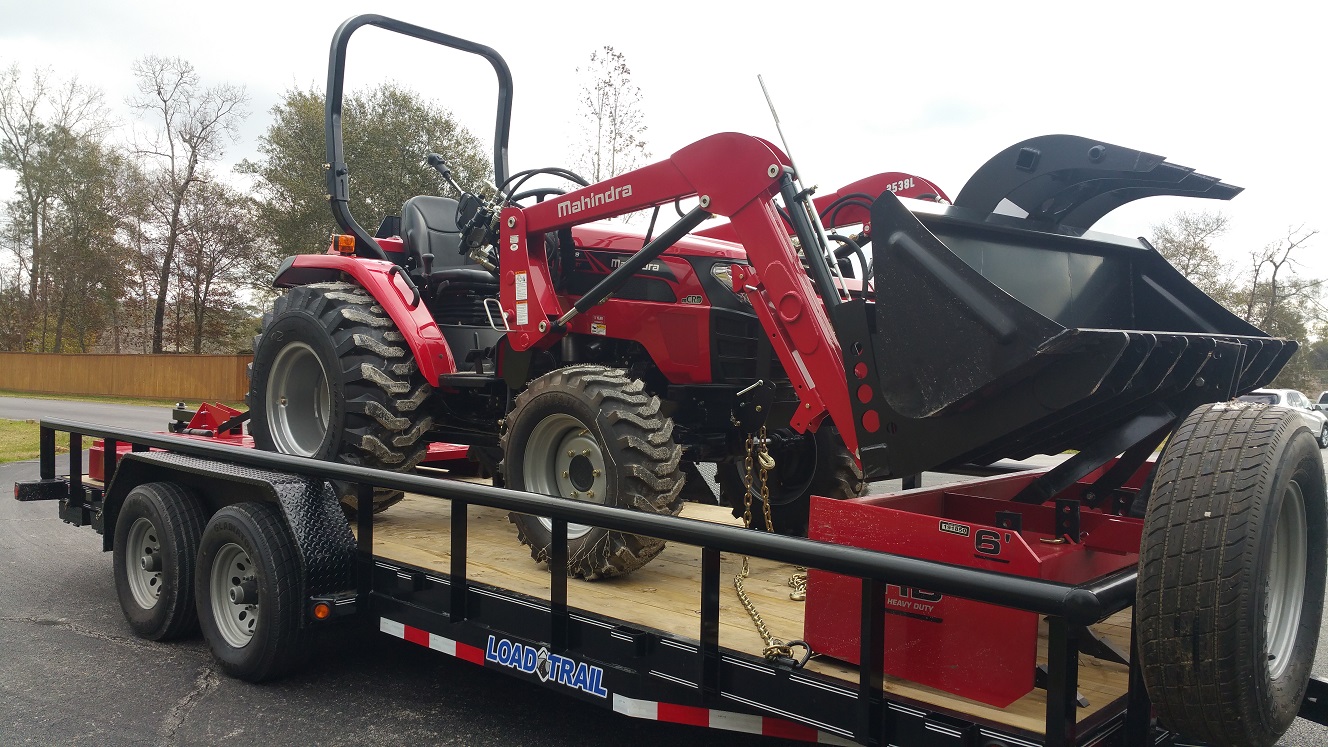

I only haul a few times a month and it's 45 miles each way on the interstate, but no problems so far. This Mahindra 2538 tractor is probably similar in size, and your truck should have more payload than the Ram. I think the Eco Boost has a nice torque curve and could perform like my Hemi. I just installed some helper bags for insurance, but you truck likely won't squat as much with its leaf springs. Make sure and get a trailer brake controller installed to work with your trailer brakes. You will need some type of WDH for that load on a half ton. Overall you'll need to not be in a hurry and leave plenty of room to stop or slow down as would be the case with any truck and a trailer. If you do a LOT of hauling then go with a 3/4 ton in my opinion.
The shot below is the full load that my Ram 1500 pulls just fine. The "Equalizer" brand WDH hitch makes it incredibly stable at Interstate speeds even when rough, and while dealing with traffic when goof balls are zooming in and out around you. This was an extreme tongue weight test and it was fine, but I prefer the balance of moving the tractor back a few feet to let loader/grapple lay flat. Then I just wrap a flag around the tail wheel of cutter. (It's a 20 ft, 10,000# rated trailer, and the loaded out weight of trailer, tractor, and all implements is just north of 8,000 pounds so I am pushing truck capacity.)
Hope this gives some insight that might be helpful. Stay safe and good luck!
