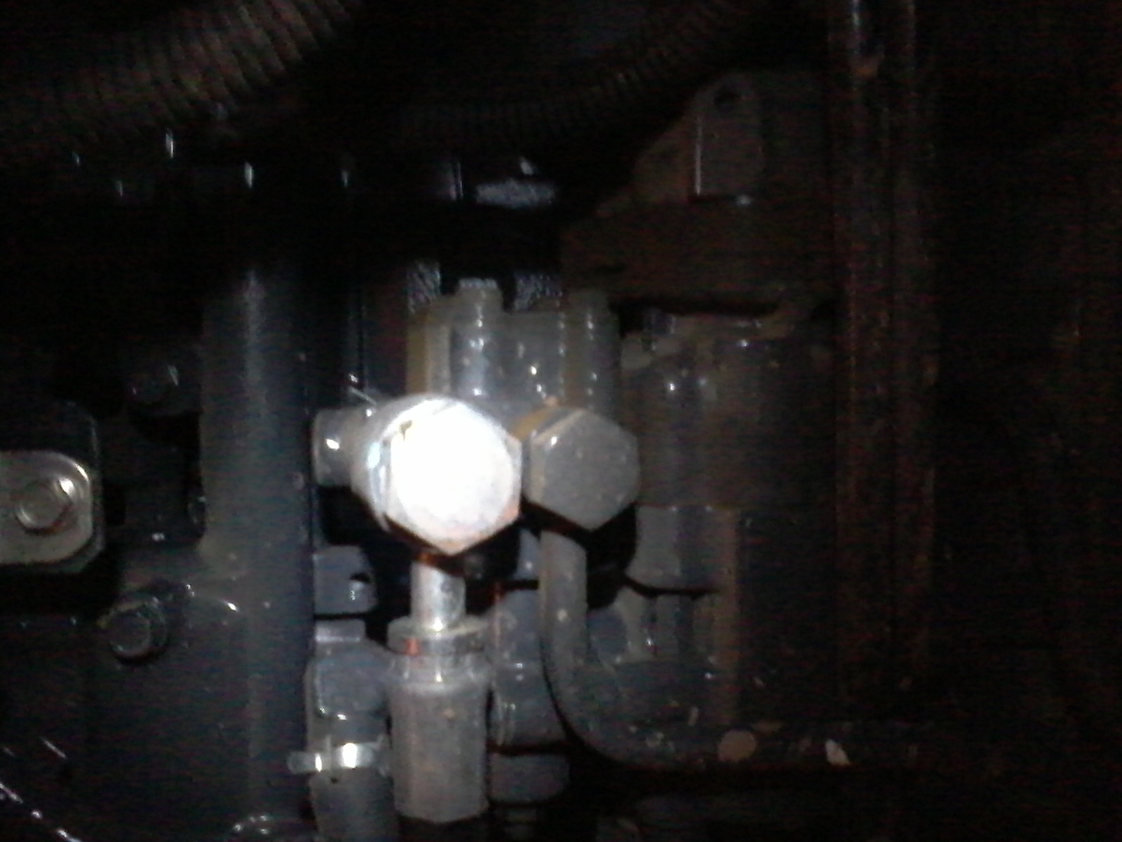

I ran out and checked for the hyd block relief and the rear remote releif. The only thing I could see are larger bolt head (7/8" to 1") at bottom of hyd block, one seemingly for tank line and other for power beyond line.???
And another large bolt head (looks over 1" socket size) at bottom of rear remote valve.
Just looks like all 3 bolt heads just thread in or out with no locking nut or such. Am I on the right track here? The relief on the loader valve looks like a set screw with locking nut. I can't find anything like this at hyd block or rear remotes. ????

Find out the tractor relief on the hyd blk and set the other reliefs to that setting.
I believe the tractor relief on the hyd blk is set by shims.
The other valves may be by adjusting screw.
Most relief valves are close to the IN port.
Show me a picture of the loader valve and the remote valve and I should be able to point out the relief valve.
On the adjusting screw type relief, you watch the hyd gauge and if the pressure changes, that is the relief you are adjusting.
You can positively identify the relief that is activated by looking at the tank port with hose removed.
When you fully retract a cyl, a relief will activate and route pump flow to tank.

BTY your tractor relief is the the bolt that hangs down the lowest on the hyd block.

We messed with the relief screw on the loader valve before. Turned it up full turn, then back to orginal place, then turned it down, and put back to orginal setting. There was no difference in clunk at any setting we put it at.
How many full turns might it take to get a noticable pressure difference? Maybe we didn't turn it far enough?
The "bolt" head I thought was the relief on the rear remote was not it. It was the lever valve spring action thingy, whatever it is technically called.
I was told the rear remote is a closed loop system tied in with the 3pt and the relief is located next to the knob that controls 3ph lowering speed. I found that.
So I guess there is only 2 relief valves on my tractor???

Your tractor is open center.
The thing you found by the descent knob is not the relief valve for the 3pt, that is the safety valve.
Your tractor relief valve is where I said it was.
In order to adjust a relief valve, you have to work the hyd to get max pressure.
You 3pt relief is at the bottom of the hyd blk.
Your relief valve setting is 2631 psi
