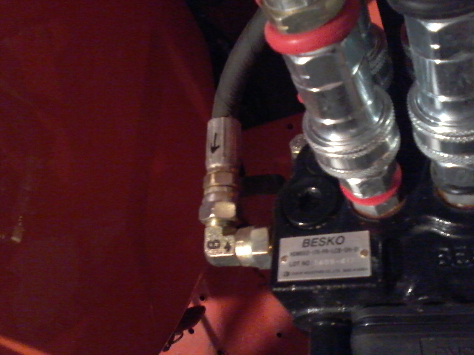

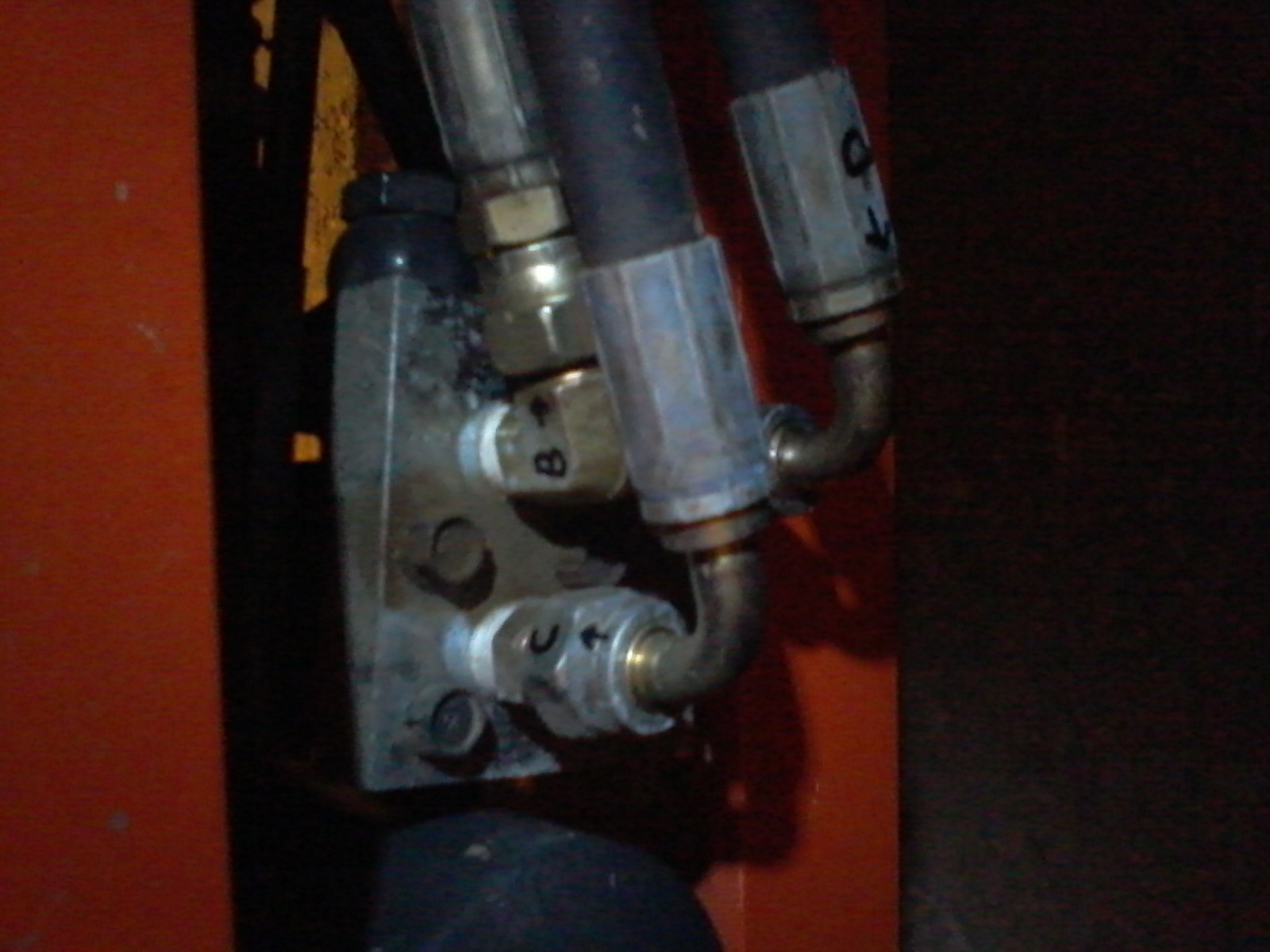

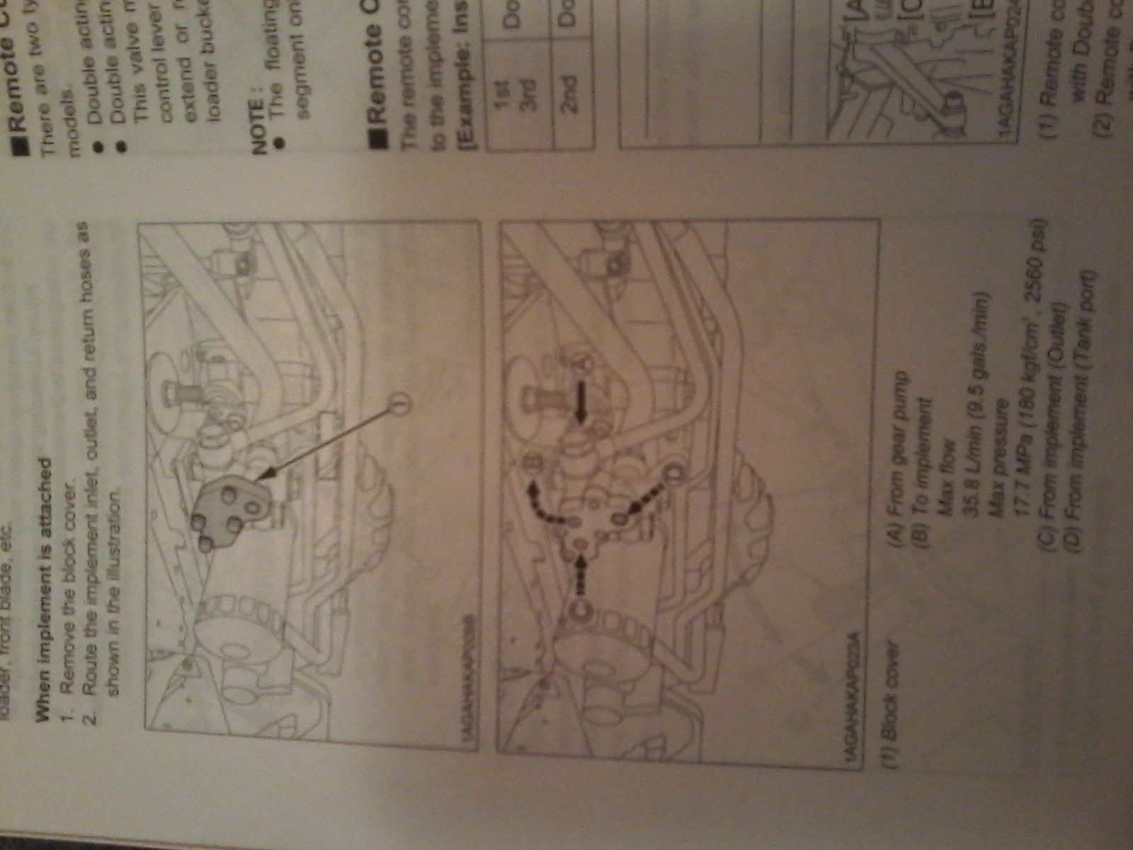

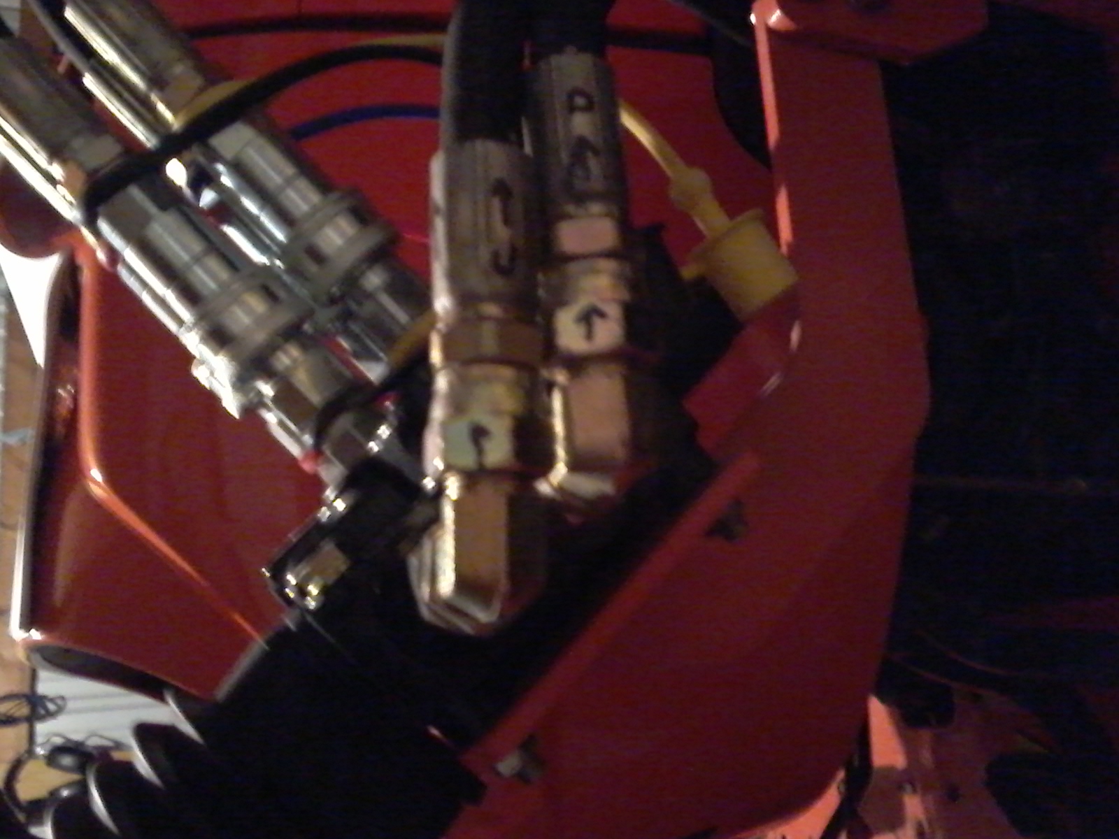

Ok. Here are some pictures of some of the main hyd routings. Sorry for the poor quality.
20150615_211559.jpg20150615_212100.jpg20150615_211612.jpg20150615_211633.jpg20150615_211713.jpg
I not too good at pictures here. I labled the lines according to what manuel says and the flow direction as the picture of the manuel states.
Could lines c and d be switched?
The lines for the remotes on back come out of rear case.

Could, but doubt that would cause the symptoms you described. As suggested start by measuring system pressure in the neutral position.

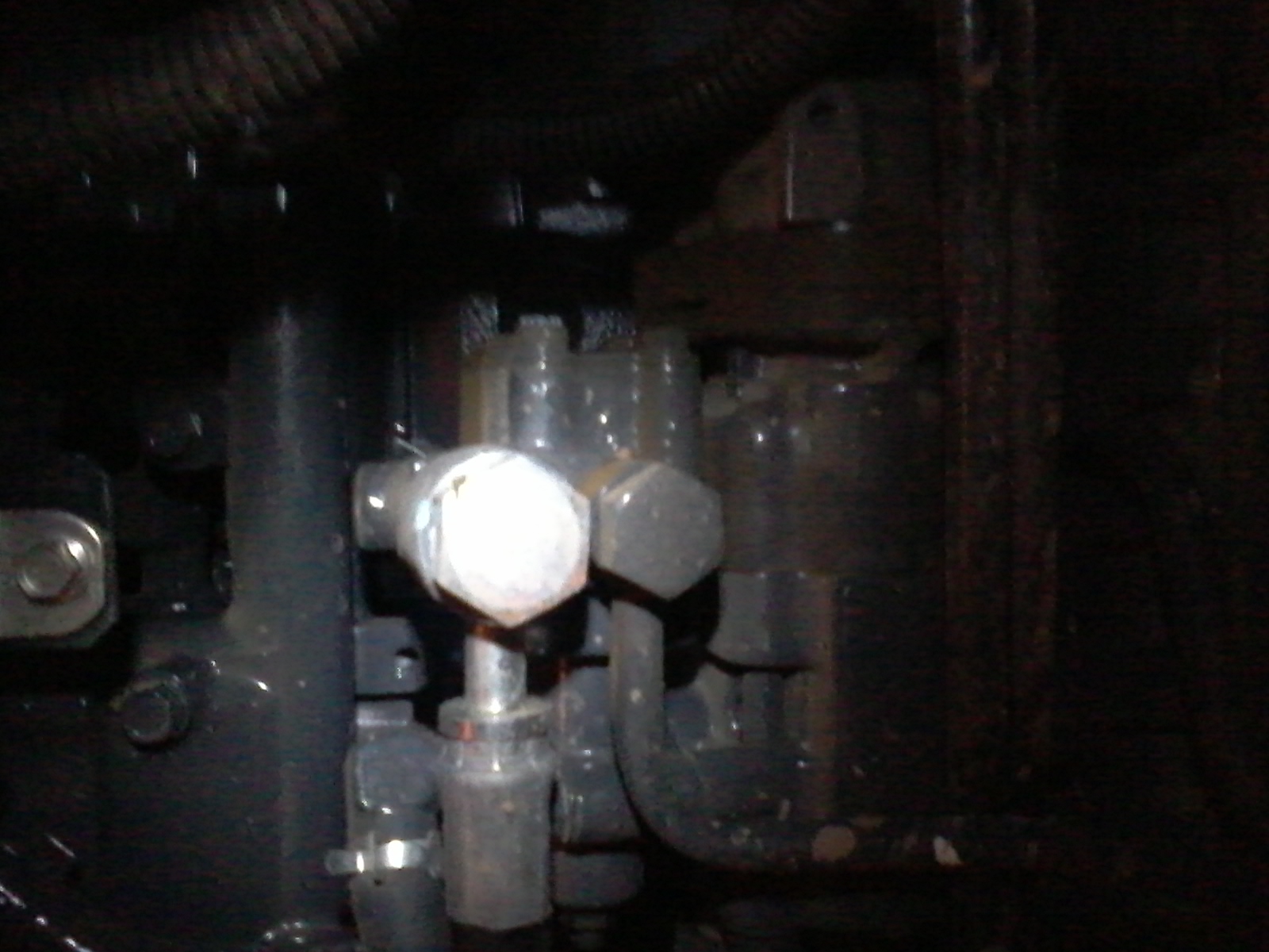

I can feel a pulse in a hyd line comming out of the hyd pump on side of engine with this static noise. I will try to get a picture of pump with that line. That pulse I feel is the static noise. Is this noise cavitation or could it just be normal?

Here is a picture of the hyd pump. Its the line off the shiny bolt on the left. For some reason picture is ratated once I post them here, so every picture is sideways. This line runs to the steering box under the consol. Could I have a power steering issue causing all these other problems?
