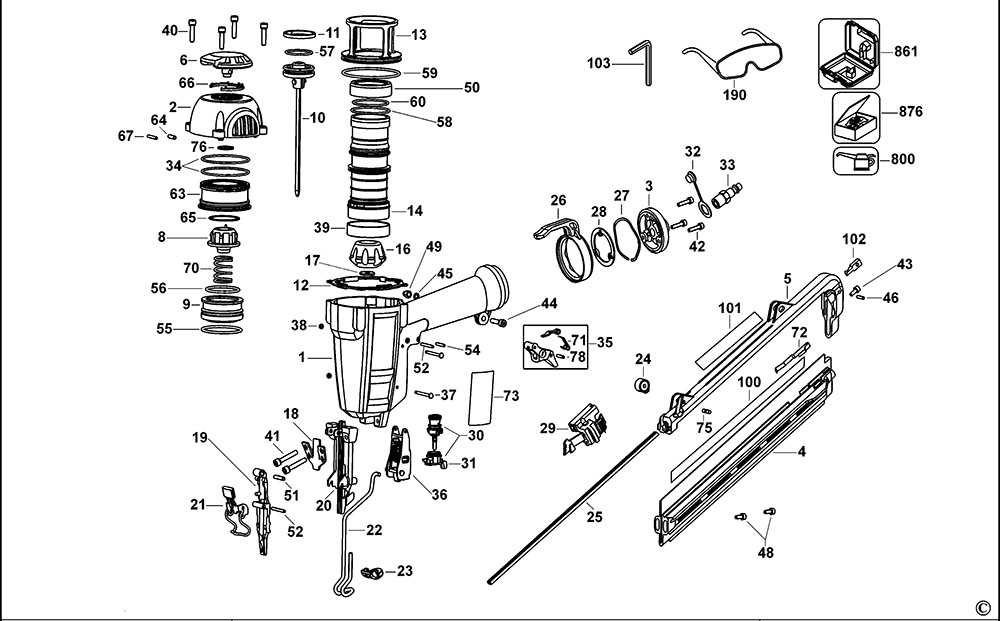

I've got one of these. Wife & I do various things around the house and I bought it new number of years ago. Not being used professionally, it's lived an easy life.
Yesterday, needed to scab a 2x4 onto an existing 2x4... just need 4-5 nail shots... pull out, get plugged into air compressor and I have a steady stream of air coming out the exhaust. No pressure to nail it in.
Compressor was running so I unplugged air, presumed there wasn't sufficient air pressure to reset the triggering process....and waited. Compressor turns off, attach air again.....and again, blowing steady stream of air out the exhaust. I put nailer tip to board (to compress triggering process) and pulled trigger.... nothing but steady air out the exhaust.
Just wondering, before I start taking it apart, if someone might have an idea of where to look first. I'm hoping it's evident when I open it up (broken gasket type thing).

Spray some wd40 in the air inlet and try it again. Most likely, something is stuck within the trigger assembly. Take that out first and clean it if the Wd doesn’t work.

I repaired a Paslode trim gun and a framing gun with new seal kits. It has been ten years since the last time I repaired one so i do not recall exactly what seal dried out. If you can find a kit then it then you are golden.

For everyone else, thank you..... problem is diagnosed. I took top off and in there, is (what I'll call a collar or seal) it's like 1/2" and circular. It was deteriorated and started to crumble. Did a lookup and seems this is a known thing to happen, a first place to look (unless you've never had to figure it out before!)
Already have replacement part ordered. It is (if you know it's the problem) literally a 5-minute fix..... remove 4 screws holding top on, clean out the broken gasket, insert new 'rubber' gasket and replace.
I inspected the other gaskets and I'm comfortable they're ok. This top seal, is clearly the problem.

Assuming that you are talking about what looks to be part 8 in your diagram, if memory serves, it is known as a piston.
I have two PC finish nailers and a roofing nailer. I had the piston crumble in all three. Just replacing the part in the finish nailers worked, the roofer not so much. The long pin that drives the nail does not retract. I have to maybe replace some seals.

I performed repair on same model nailer. After many years the plastic diaphragm fails regardless how much oiling is performed.

Ordered a rebuild kit. Arrived today. I already had the lid off the nailgun. Having never done this before, took me probably 15 minutes to pop the cylinder out, FIND the silly seal (that hides with the color of the cylinder), find the gasket INSIDE the circumference of one of the parts....
Given that this has always been well oiled, it was a bit of an oily mess.... no worries, just used a rag to 'dry' my hands.
Got all the gaskets replaced, put together, put a bit of a stream of oil in it since most of what had been in there is now gone. (kit came with some lubricant which was also used)
Slapped a couple nails, attached to air hose and it's driving nails like the bit** it is!!!
It really was supremely simple and easy. Kit came with replacement trigger but I didn't want to fool with it, so might just leave it be since it works fine.
