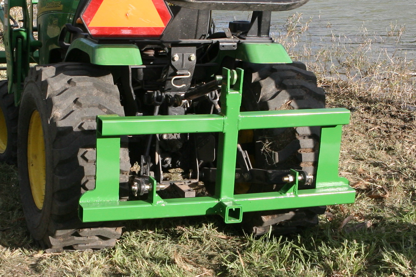

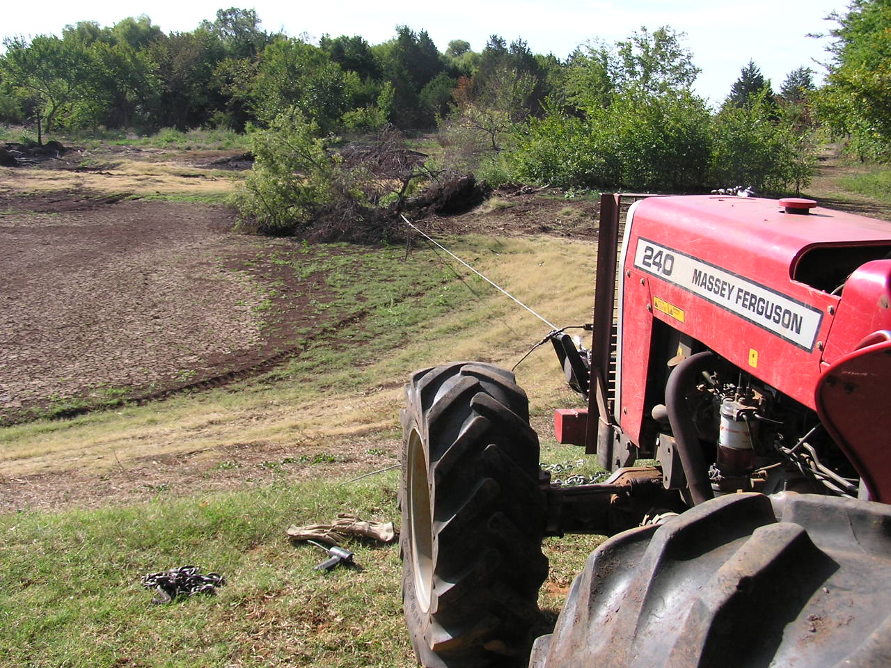

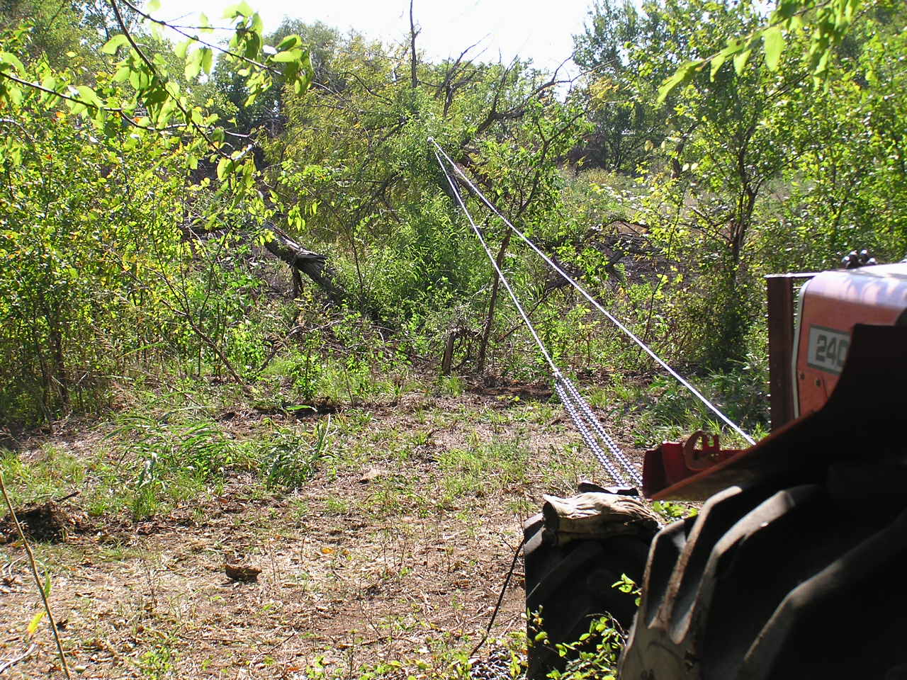

   / portable winch #4
I made a winch that was three point mounted,

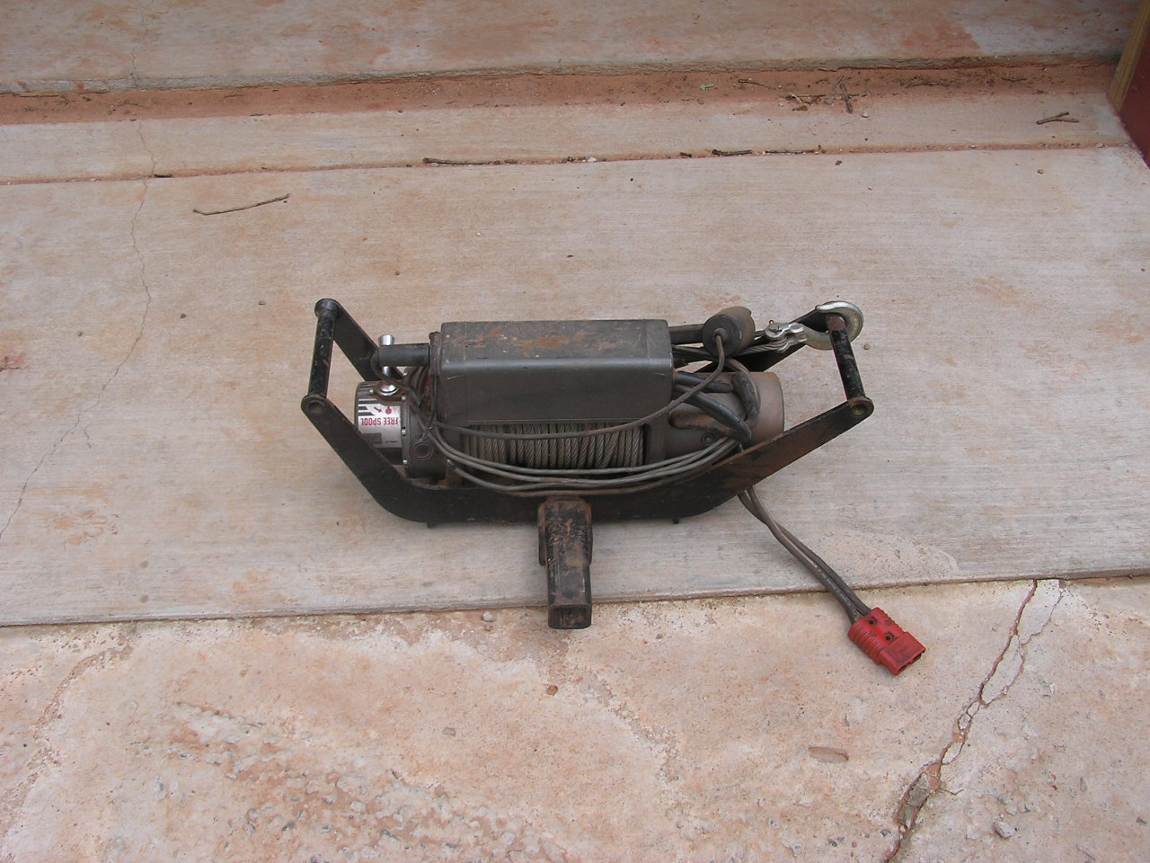

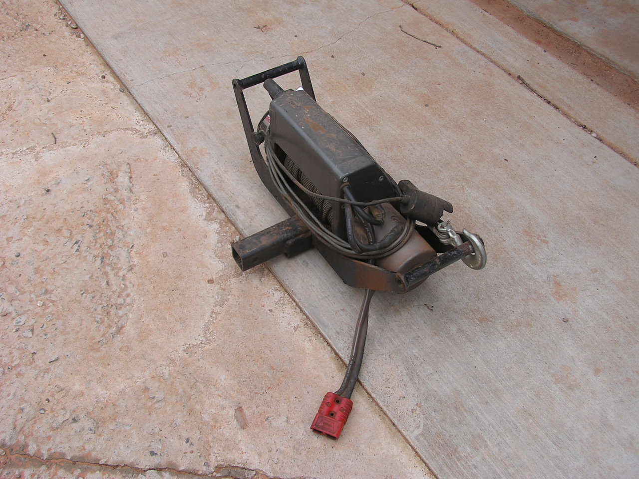

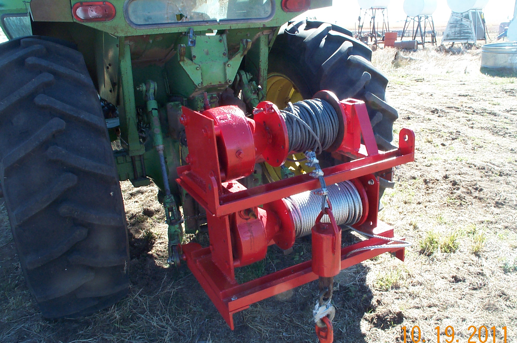

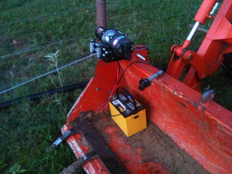

   / portable winch #5
Mine is lower capacity, but useful to pull my windmill pump. It als works good for pulling bushes in landscape. It fits in a receiver welded to the bucket.

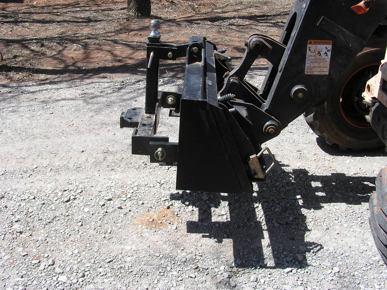

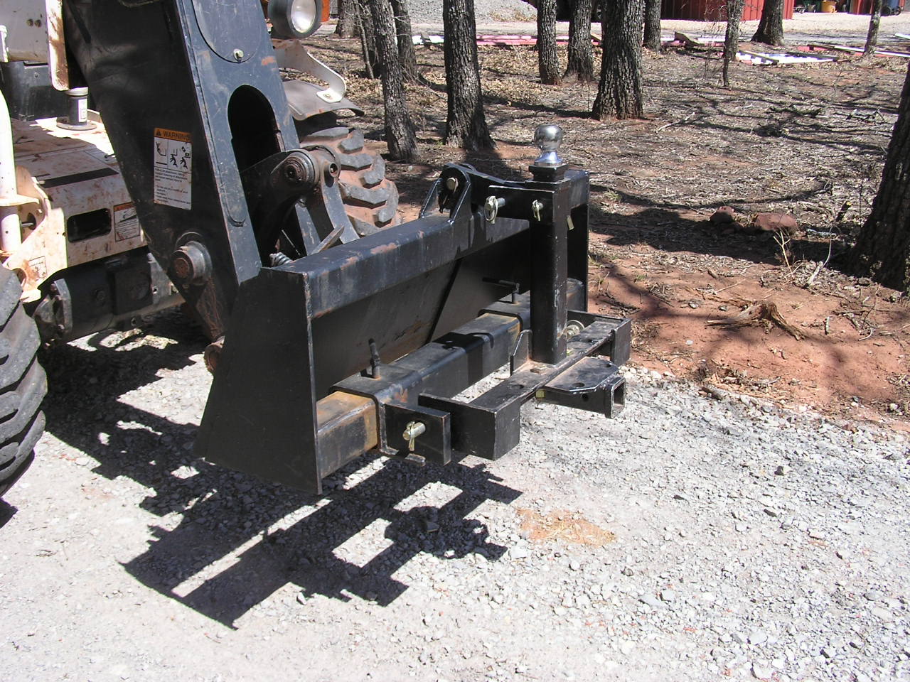

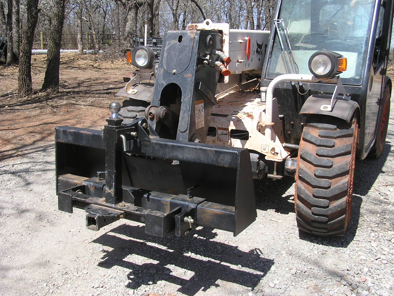

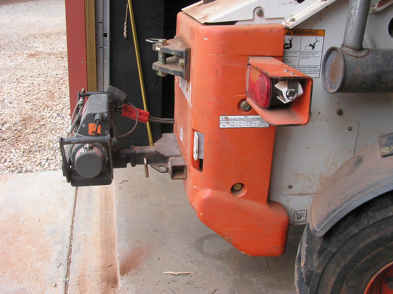

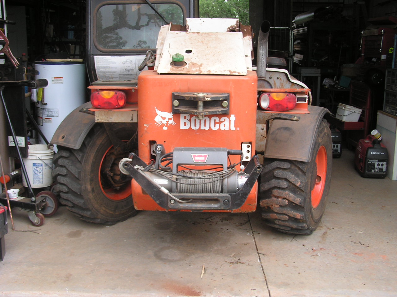

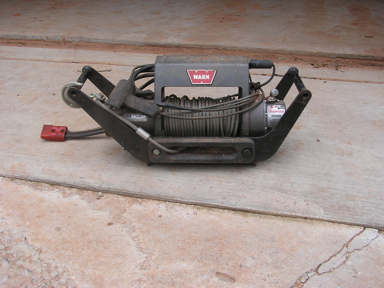

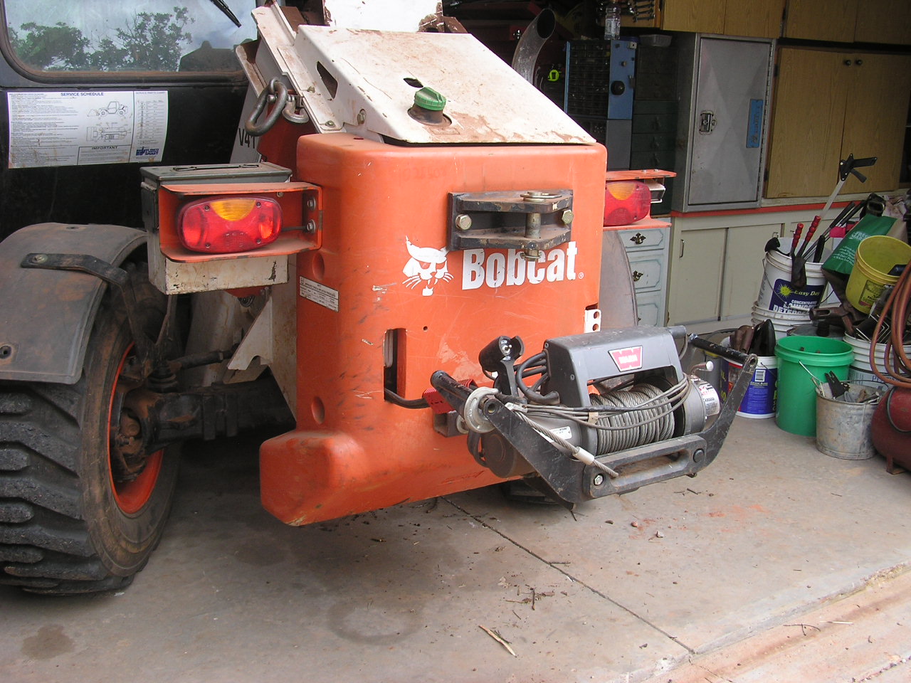

   / portable winch #7
I have a this
mounting on this
Winch works great, also have front and back receiver on my truck. It does come in quite handy.
   / portable winch #8
I have the same winch.
Welded a receiver hitch onto the front weight.
Used it many times, back when I had the tractor.
Sold the tractor, kept the winch. :D

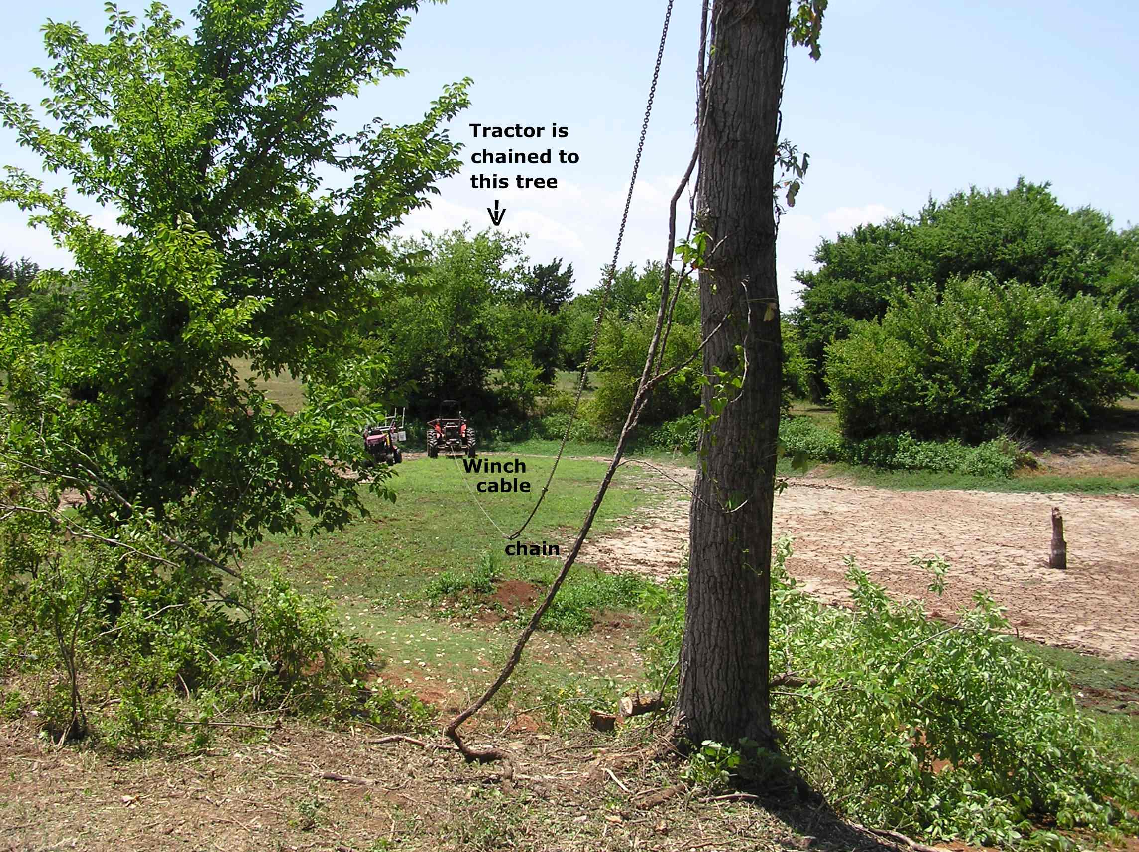

   / portable winch #9
   / portable winch #10

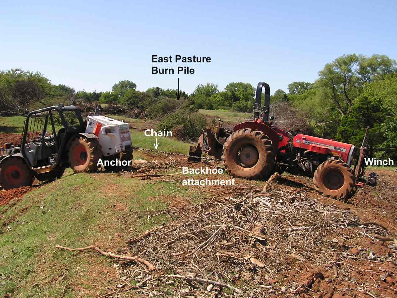

I also did a very close copy on my MT180D at the rear. Very useful to drag trees out.
Yep, now I can do the same with my V417 :thumbsup:
And on the front in this three point receiver hitch if I need it there.
