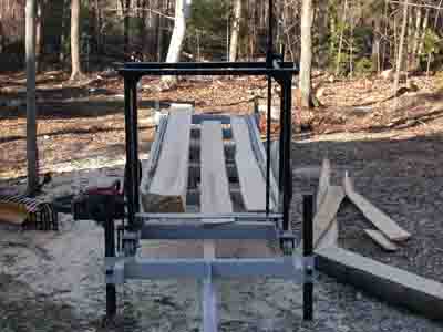

ok, one more try....

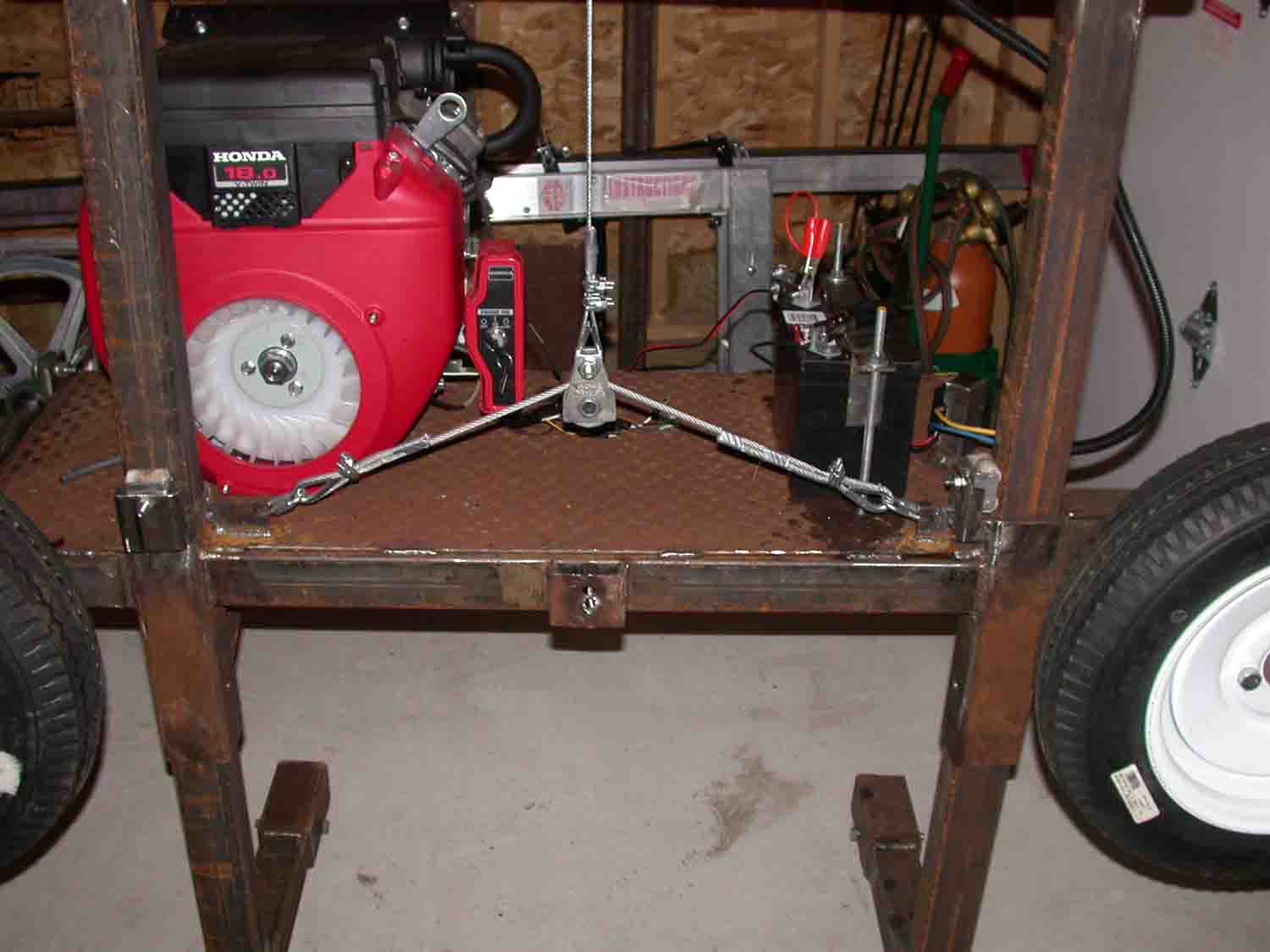

Scott:
I see what you did with the 2nd cable;
that makes the system WORSE as the flexable cable & pully on the bottom will let the HEAVY side drop
to correct the problem use a hunk of bar saw 2" x 1/4" and drill a bunch of holes in it, move the cable attachment point (single point) twards the motor. that is the heavy side. just tack weld the 1/4" bar in, and space the holes about 1" appart moving form center twards the motor. and use a clevis to attach the cable end from the lift to the 1/4" HOLES moving one hole at a time untill you can get it to lift easly. besure to clean off any burs that have been created by the 2.5" tube gouging into the 2" tube.

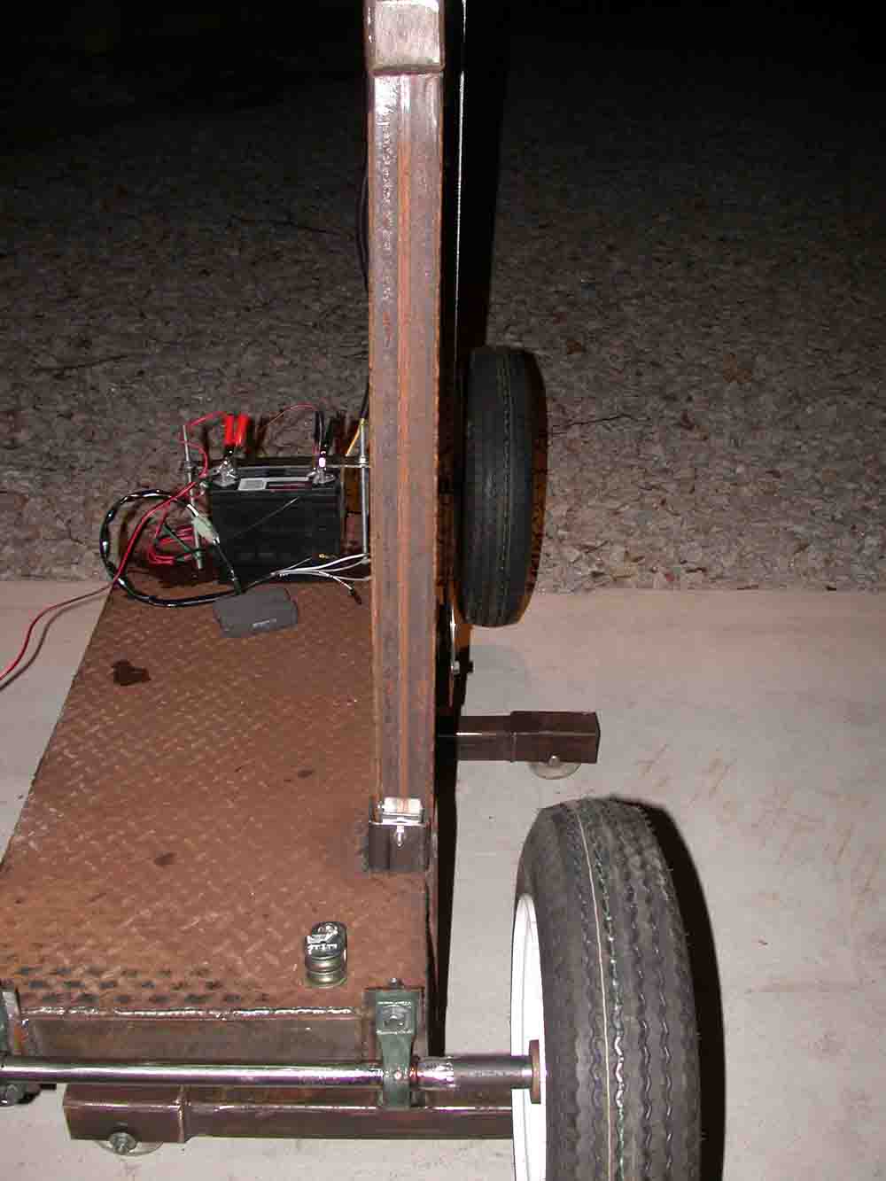

Is there any way you guys could attach a drawing of what your explaining. I think I know what you are saying but I want to make sure it is correct. Also, I have to add other steel (more weight) to this project, like the blade guards, gas tank, etc. This is additional weight which hopefully will not contribute to the binding. Here is a photo of the mill that I was trying to duplicate.

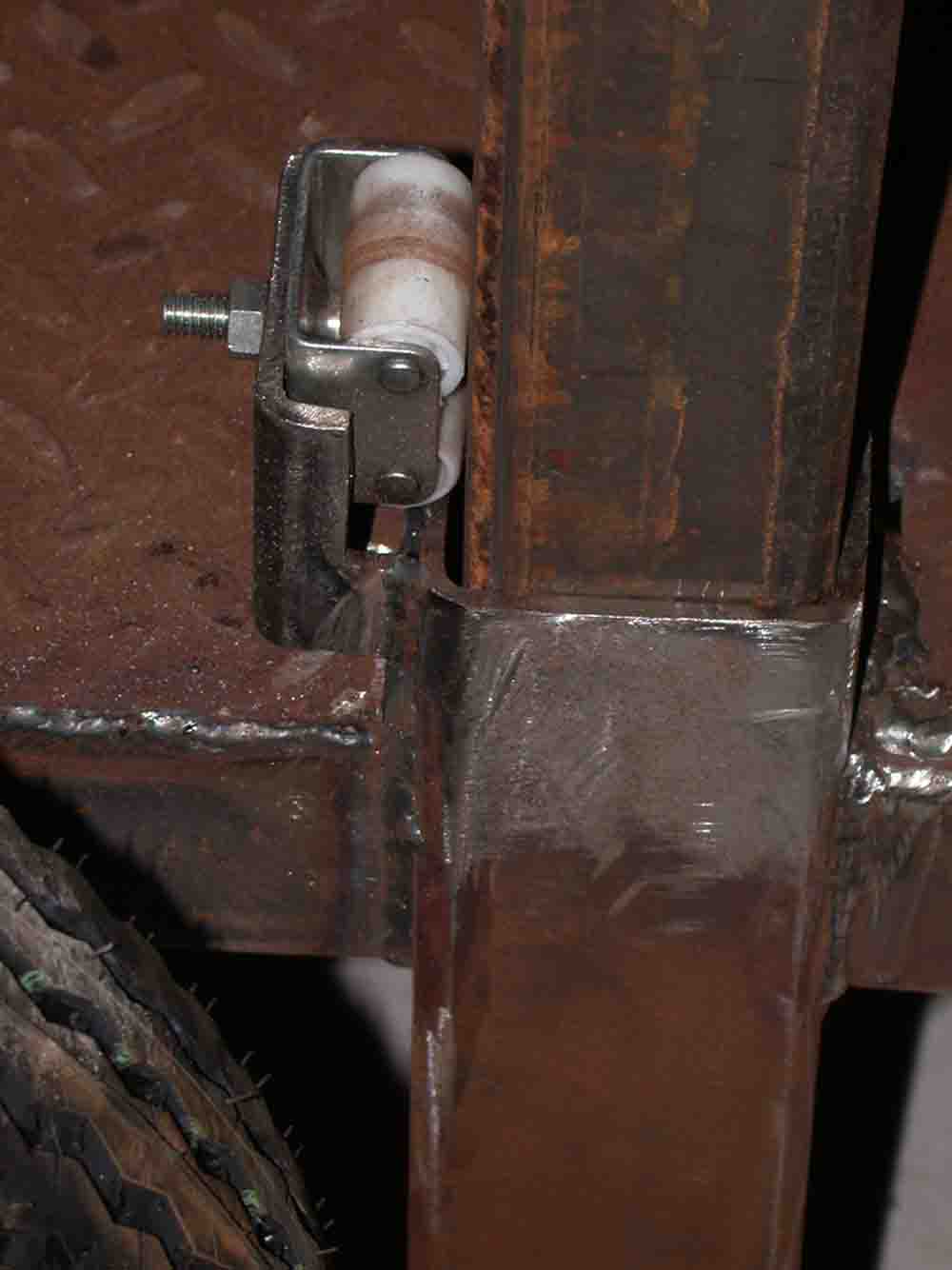

<font color="blue"> Pulling from both ends seemed to work well initially. Once I put the motor on it became unbalanced again </font>
Scott,
I am not sure the root problem is unbalance...
Unbalance would act in the direction that you have tried to compensate for with those wheels you have mounted on the sliding part of the assembly.
But from what I think I see in your photos, there is an even greater opportunity for binding pressure to be felt by the sliding sides of the square tubing, on the platform side [at the bottom] and the other side, opposite the platform side [at the top].
So when you put extra weight on the platform you may be causing a bind, regardless of where you put it. If you want to prove this, put the engine in the middle for a test. If you still get the bind it is not from umballance, but rather from the cantilever effect of the weight of the platform and what is it is carrying.
If this is the case, then even pullng upwards with two cables, one at each vertical sliding point, still may not cure the problem. You need enough upward force to overcome the friction of the binding points, which would be as Wharv said, at the top outside, and bottom inside [platform side] of the sliding pieces that the platform is attached to. Your little winch may not have the force to overcome the friction, regardless of how you try to pull upwards.
As others have said, the best solution is to reduce the friction. Even if you don't want to use grease, you might try some just to prove the theory that friction is the problem and to help identify where you need to put compensating rollers or bearings of some type.
You might also try lifting the outside edge of the platform, while the winch is in bind mode, to see if a little lift will cause the platform to unbind. The idea being that a little lift on the outside, would cause pressure to be relieved from the friction point at the top, enabling the winch to do its job. I think, but I'm not certain, that there is a sort of multiplying effect, and that a little lift to unbind something goes a long way toward friction reduction at the bind point.
If all the above seems like nonsense, just forget about it, but do take another look at your assumption that it is the unballance along the platform lenght that is the problem. My gut says it isn't, but like everyone else, we are only looking at pictures... /forums/images/graemlins/smile.gif

Henro, your absolutely correct. When the binding occurs in that one corner I can add a little upward pressure (just lifting it up with my hand) and it goes right up. I am almost tempted to weld a handle in the back where the binding occurs. If that’s what it takes to move this, than so be it.
This weekend I will try to round the top of the 2 ½ in tube stock the best I can. This may help in reducing the friction and binding. The problem is I don't have much room to work with. The only way for me to get the sliding section off is to cut the 2" frame at the top.....which I really don't want to do.
I will try grease but I plan on painting this and don't want to do it until then. It would make for a real mess trying to get that off and could cause paint lifting and adhesion problems. At this point I am almost tempted to try it now. I do plan on getting this sandblasted before the painting phase.
Spiker mentioned a product called UHMW, which I don’t know much about. For what I have read it looks like it would be very slippery and could help with this problem. Is it something I put over the 2” frame?
/ Portable Log Mill #31
Scott,
It looks like you are on the right track, but I think you have to get the lifting force centered above the 'center-of-mass', not necessarily centered between the two vertical posts.
I've drawn some suggestions on your photo. (see attached)
Hope this helps.
