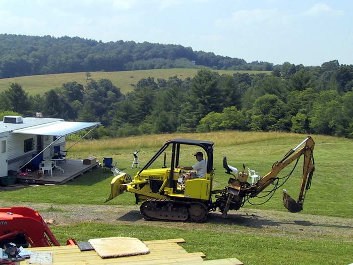

I've never seen anyone put a hoe on a dozer. Pretty slick!!
It was a wee bit bigger than the dozer should have had. 1199A Long backhoe...

How is that little dozer been for you? How old is that model?
Found a photo of removing the "massive" boxwood stumps... and right before the bolts stripped out of the back of the Nortac dozer!
   / Popping out bushes? #23
About 2005-ish... helped with road building and paths into the woods. Mainly light duty work but work, none the less. Right now it needs a steering clutch on the right side...
It's a friends' dozer but I was offered it, for free - just need to fix the right side steering clutch (I declined the offer!)
