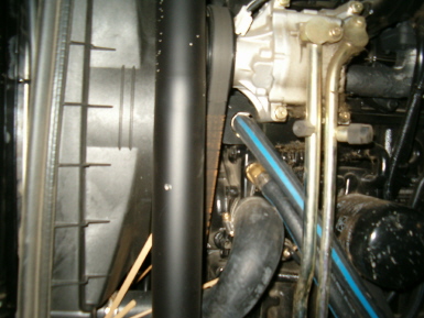

dwmaster said:
outlets are on the left side. Their is a plastic tee with a cap on it just below the right side of the cab on the return line which must be for bleeding the line.
Thanks for the picture. Thats how it should be. To the pump or to the block. Not to the lower radiator hose. Maybe a different water pump could solve the problem and reroute the return hose.
/ Poor cab heat #83
radman1, your 3720 is a 3 cylinder diesel. dwmaster's 4320 is a 4 cylinder diesel. This is apples and oranges! Thanks, dwmaster for the piece of information, I guess I should have look at your profile. radman1 you can't use dwmaster's photo for help. I have looked at both engines and their water pumps on JD Parts and there really isn't any common shapes/designs for the coolant hose ports. 3720 has a casting with water pump, t-stat housing and outlet to cylinder block all in one piece. 4320 has water pump separate, then it bolts to the front housing which in turn bolts to the engine block. A 4320's thermostat is barrel shaped and looks light it slides down a tube where the upper radiator hose attaches on the front housing itself. radman1, hopefully the JD factory will help out with a solution for your lack of cab heat. I have cured a 40 foot motorhome's front heater lack of heat complaint(engine at the rear) by ignoring CAT's installation guidelines for OEM manufacturers, and plumbed front motorhome's heater inlet to upper rear of cylinder head (Note: t-stat at front of cyl. head) and put heater core return hose directly into the suction side of the water pump(CAT water pump has a port available). This solved the problem. Basically, I achieved this by getting maximum pressure difference between the inlet and outlet while still considering a reasonable compromise for a location that I can capture the heat of the coolant and push it 40 feet forward and then 40 feet back(returning directly to water pump helped here) Just a little info.
Yes, I agree the designs are different, but the concept of dwmaster's water pump with the return to the pump is more ideal than the return hose to the lower radiator hose. The return heater hose on my 3720 should be of the same design as the 4000 twenty series cabs. The ideal solution would be to have a different water pump designed for the 3000 twenty series cabs and plumbed directly to the water pump or have it return directly into the block. According to my service manager, JD knows that there is a problem but doesn't really have a solution. The bizarre part to me is why others on TBN don't seem to have the problem but my dealer has 3 known 3000 twenty cab tractors and all have this problem. Service guy told me they just ordered another cab 3720 for a customer and it will be interesting to know if this one also has the same issue. That customer had heard of a heating problem from another dealer but ordered it anyway. (My dealer has only sold 3 3000 twenty series with cabs and just ordered this last one. All were sold in the past summer and fall.)
