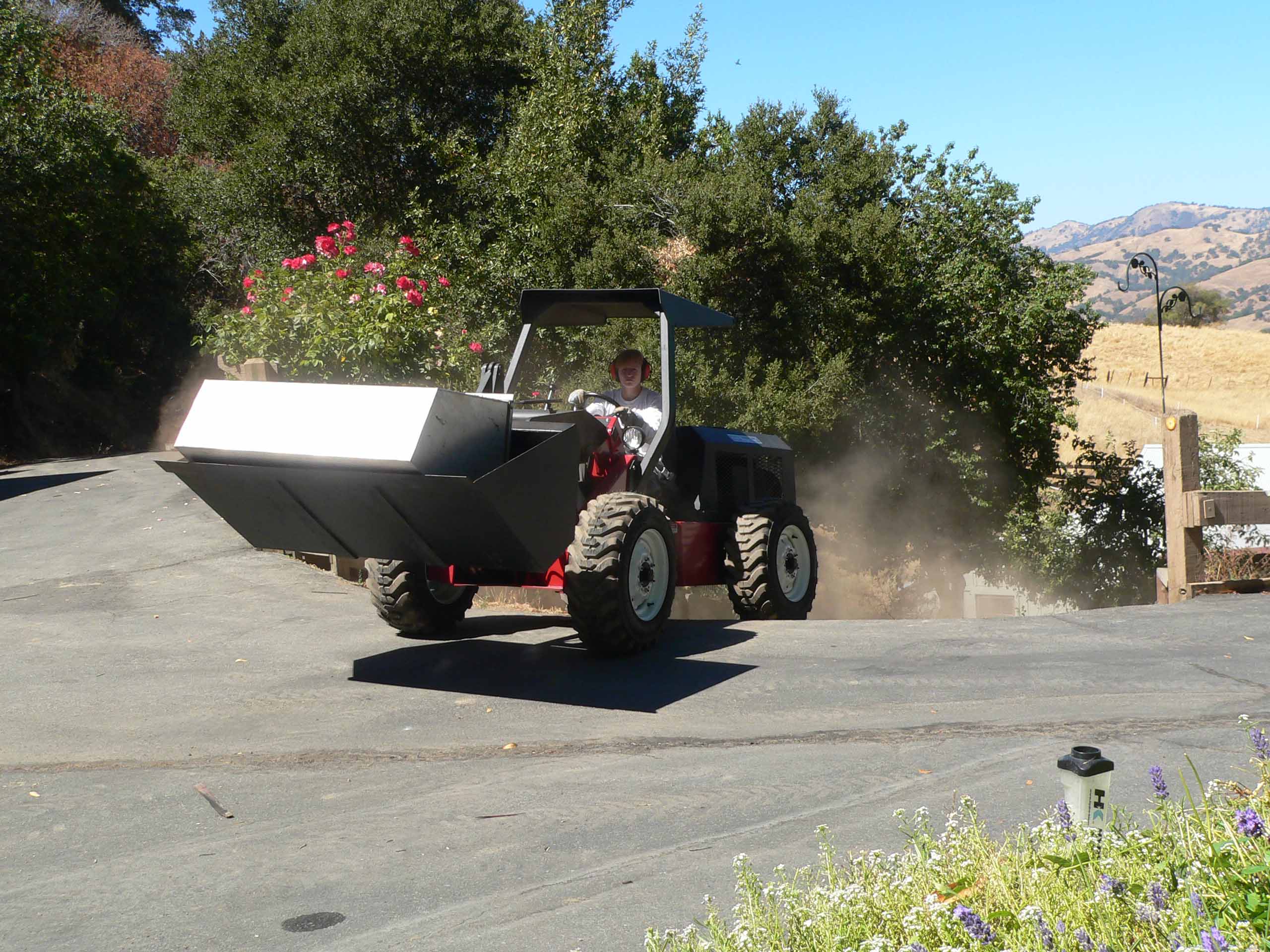

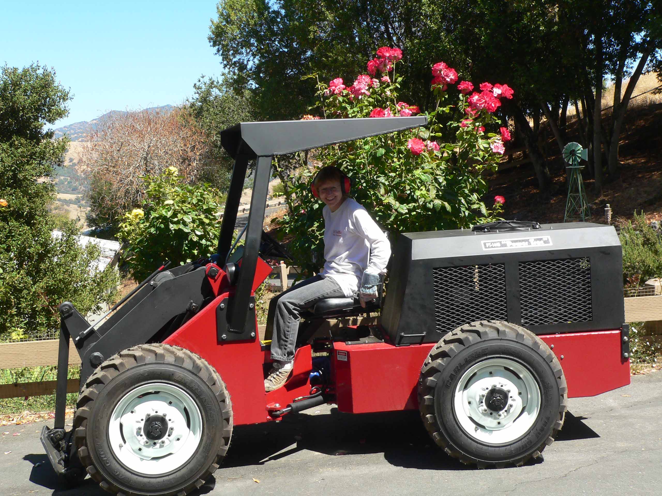

My humble apologies. Carl is right. You deserve some photos.
To put it simply, without the help and advice and assistance of this forum, I wouldn't have bought a PT. So thanks for all of the help so far, and all the help in the future!
The first photo is a hill climb, just as the PT1445 was cresting an 18 degree incline. Traction was an issue in the loose gravel, but with a little speed, no problem. I can forsee a role for chains. I can't convey how useful, and reassuring autobrakes are. My spouse lugged the engine near the top, and depressed the treadle farther, stalling the engine, but the brakes came on and held. She put the parking brake on, restarting the engine, upped the engine speed, and drove off.
A neighbor happened by on Sunday. One of his first comments was "Look, it has reversible wheels!"
Question: what is the name of the fifth hose on the lift arms, just inboard of the left side QA? (i.e. 2 PTO, 2 QA and ?)

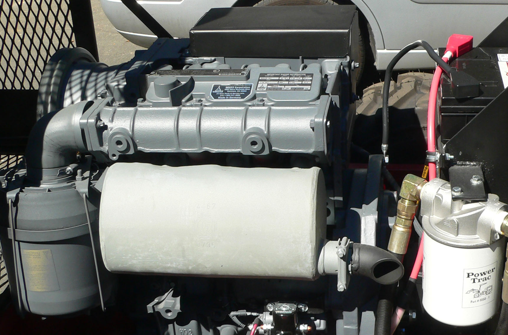

OK wizards. Can you explain the logic of these to a neophyte like me?
Starting on the left:
1) The air intake appears to be upside down so the water drain is at the top of the air filter. This is because...?
2) The intake is behind the exhaust, which blows on the tire. Is this to keep the right rear tire warm and clean?
3) Why do the battery cables cross?
4) Where is the ground path from the engine block to the frame?
Both the intake and the exhaust look as if they are 180 degree reversible, which would then enable the air intake drain to be at the low point of the filter.
Perusing the Deutz engine manual, I notice that Deutz supplies an oil cooler cowling that is
a) curved, and
b) directs the air flow across the engine and exhaust.
Does anyone have one?

It's the return line for motors with case drain. My mower has one.
/ Ponytug - Group embarrassment time #10
You got it, it's BECAUSE
Your tires are too big. I'll swap you a set of turf from the 1845.:D
Why not?
On my 1845, I had some strange electrical gremlins. I ran #10 wire fron the engine to the frame, then from the rear frame to the front frame. Gremlins went away.
Mine points down, but back in the corner. I've never had water. I suspect there's a reason for the configuration, but I suspect you wont find out much detail from PT. There tremendously helpful with problems, but pretty reticent about engineering. It's a Tazewell thing. :)
a) curved, and
Nope. At least I don't. I suspect they reroute it out rather than over the top of the engine to run the hot air away from the hydraulic cooler above the engine.
That is one muscular machine. It makes the 1845 look puny. I'm betting you'll love it.
#11
That is ONE HUGE tractor. I did not realize it size until you get a human in the pictures.
Glad you posted pictures, but two is not enough. Funny story on the freight issue. Trucking is such a mystery...
Your setup looks like mine in terms of engine and wiring. I am thinking of adding a second exhaust to my tractor to quiet it down.
But, thanks for the pictures. can't wait to see more.
Oh, you may want to do the mod that Alta or I did. Get your air exhaust plate up higher. It really helps.... And maybe make your side door easier to access. Only way to keep these larger engines cooler is constant maintenance of compressed air...
Carl

Thats nice with those wheels and tires on it.
Keep an eye on your temp, as you use it.
My 1850 overheats.....a lot. :(
But it still gets the job done.

So far, in light work, no problem, but I know that once I get out on the hillsides mowing, it is likely to be an issue.
Have you plumbed in your remote oil cooler?
Have you added ground straps from the engine cover and frame back to the engine block? It might help your fans run a little better.

Just to be fair, she's well under 6', but if you think that the tractor looks huge, you should see the brush cutter. It looks ready to mow the state of Rhode Island.
My first add on purchase was an air compressor, the second was another couple of grease guns.
If I fool around with the exhaust, I think I'll try to route it out the back, and move the air filter up front. I am not sure if the 1845/50 have enough room, but on mine, it looks like it could be done. This would route noise out the back, and get the air intake closer to right side up.
Carl, you and Altavista may want to go to the Deutz air shroud, which routes the post oil cooler air over the air intake and muffler, and continue it on over the engine to help blow exhaust heat out. That would give you a 'cool' engine side to help with the hydraulic cooler, especially if you had a secondary fan push cool air into the engine compartment.
The Deutz shroud is shown in the manual with a slip on weather strip to help seal it. It might be a good start to help with the air leakage around the hinge. I guess it has to be a reasonably heat resistant rubber.

Wow, Peter. That's a MONSTER!! (when someone is used to a little 422 anyway)

Good idea on the ground strap. Mine will be getting that next.
/ Ponytug - Group embarrassment time #19
At work, I once spent the better part of a year chasing a gremlin that ended up being related to poor EMF shielding and a bad ground design. Once, I figured out it was grounding, the solution was a snap.
It's really cheap insurance against electrical gremlins. Make sure you put one from the battery grounding point on the engine to the back frame, and another from the battery grounding point to the front frame. You want to have one point where all of the grounds come back together.
It is a little off topic, but I added a couple of ground straps to my old pickup and my battery charging problems went away, as did dim lights on the dashboard. A set of relays for the headlights, and presto! Headlights that actually lit up the road.

I ran ground wires around the 1845 at least in part because of experience with Corvairs. The symptom: breaking clutch cables. The cause: bad ground strap, so the clutch cable was the negative wire to the starter -- got hot.
That was reinforced by experience with trailers. Those I've wired now have negative wires to every light, and my truck has a #10 from the negative battery pole to the trailer plug (which is also grounded to truck frame.) And that is because of the trailer I rewired when it didn't need it because of bad grounds on three tow vehicles.
If you have a strange electrical problem, I'll always bet a six pack it's a bad ground. :cool:
