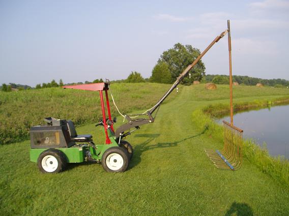

Here is a pic of the pond rake before it goes into action.

That's right LOL when I get ready to paint it, it will be red. I will make some more pics of this rake if anyone is interested. I know not many people would have a use for this thing. I know I sure do and so far it is working great!!!

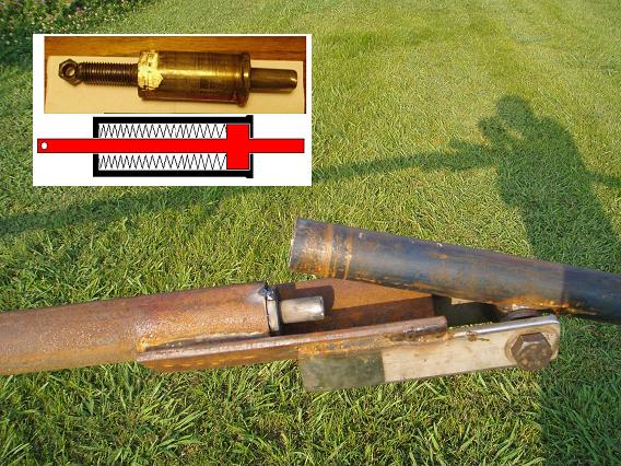

Here is a pic of the knuckle. You just let the rake fold out on the ground or pond bottom as to take the pressure off the slide catch, pull the rope that runs through the pipe(connected to the slide catch) and lift or lower and pull and let off the rope. I hope this makes since.

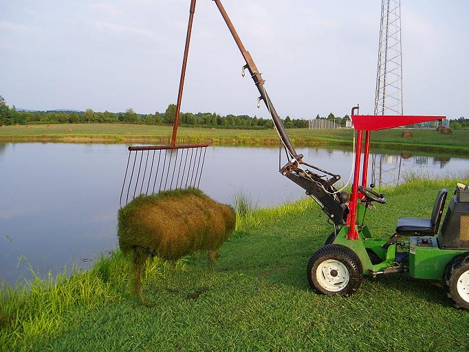

After I have knuckled and dragged. Here is a pic of the lifting. The knuckle lets you lift many times more.

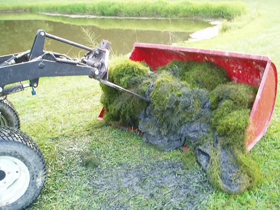

Here's Ya some more moss.
