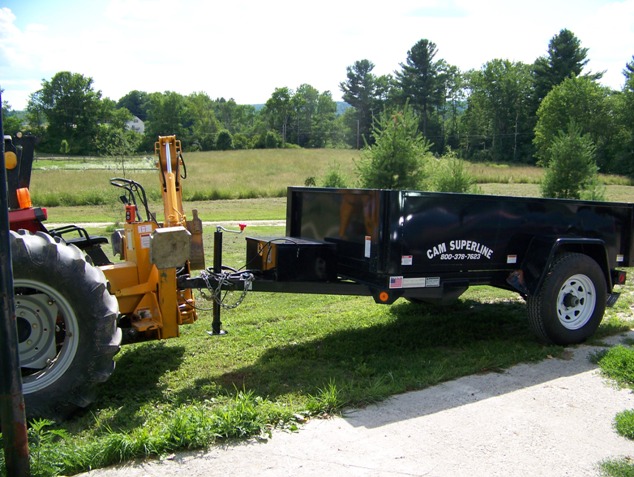

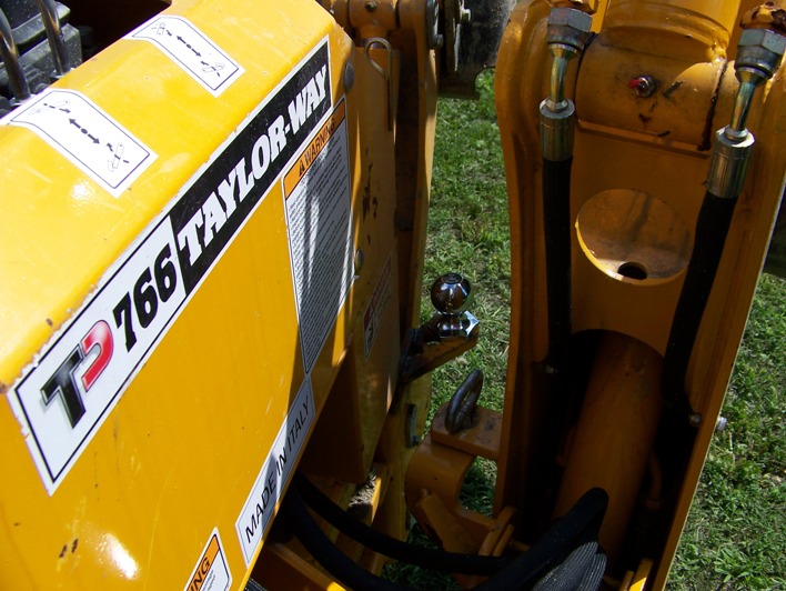

Would be interested in how you'll put a hitch ball on the taylor way 766. Seen here is mine, it looks a lot bigger on my little jd than it does on your MF1260...:D .... .................................................

How do you like that taylor-way? I find mine to be strong for it's size. Are you using the 3-pt setup or do you have a sub frame?

Like it !! YES ! very strong for it's size, dug some quick holes in very rocky soil. Think eastern ct and thousands of miles of stone walls, pulled some big stumps..I did have a problem with leaks. See this post..http://www.tractorbynet.com/forums/...s-leaking.html?highlight=relief+valve+backhoe ... all better now except I needed to get use to the touchy controls, I'm better with it, but there is always need for improvement....Years ago (early 70's) I used a Ford backhoe, either I was smoother then or the smaller hoe is less forgiving.. I just take it nice and easy and all is fine.
I welded up a 200lb subframe, not the prettiest or easiest to attach or remove, but for now (til I modify it) it keeps the forces spread out from drawbar mount to FEL mounts and have no concerns about normal uses damaging the tractor................................................................................ ..........

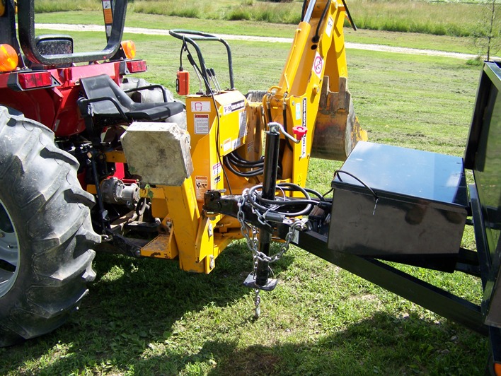

Great Phil, glad ya finished another project (bh subframe) the picture doesn't show how the bh mounts to frame, but what I can see the frame looks very professional. How did ya get the bh top pin mount to connect to frame?.

I hope these pics will tell you what you would like to know.
This one has the BH frame attached to the new sub frame prior to welding it to to BH.
As you can see I design it to lift the tractor off the ground by going under the rear axle. It attaches with 3 pins. 1 top link and the 2 that you can see in the picture. Those are the 3pt pins that came with the Tayloy-way BH.

Very nice... I like the way the frame hooks up to the drawbar, nice touch.;)

Thanks I did that because it allows me to support and slide the Bh forward and then pin.

These pics are of the trailer ball that I added to the taylor-way bh.pond6 16 07 054.jpg
I put one on each side. After using it I now think that I will lower them about 10" to make it have a little more clearance.pond6 16 07 055.jpg

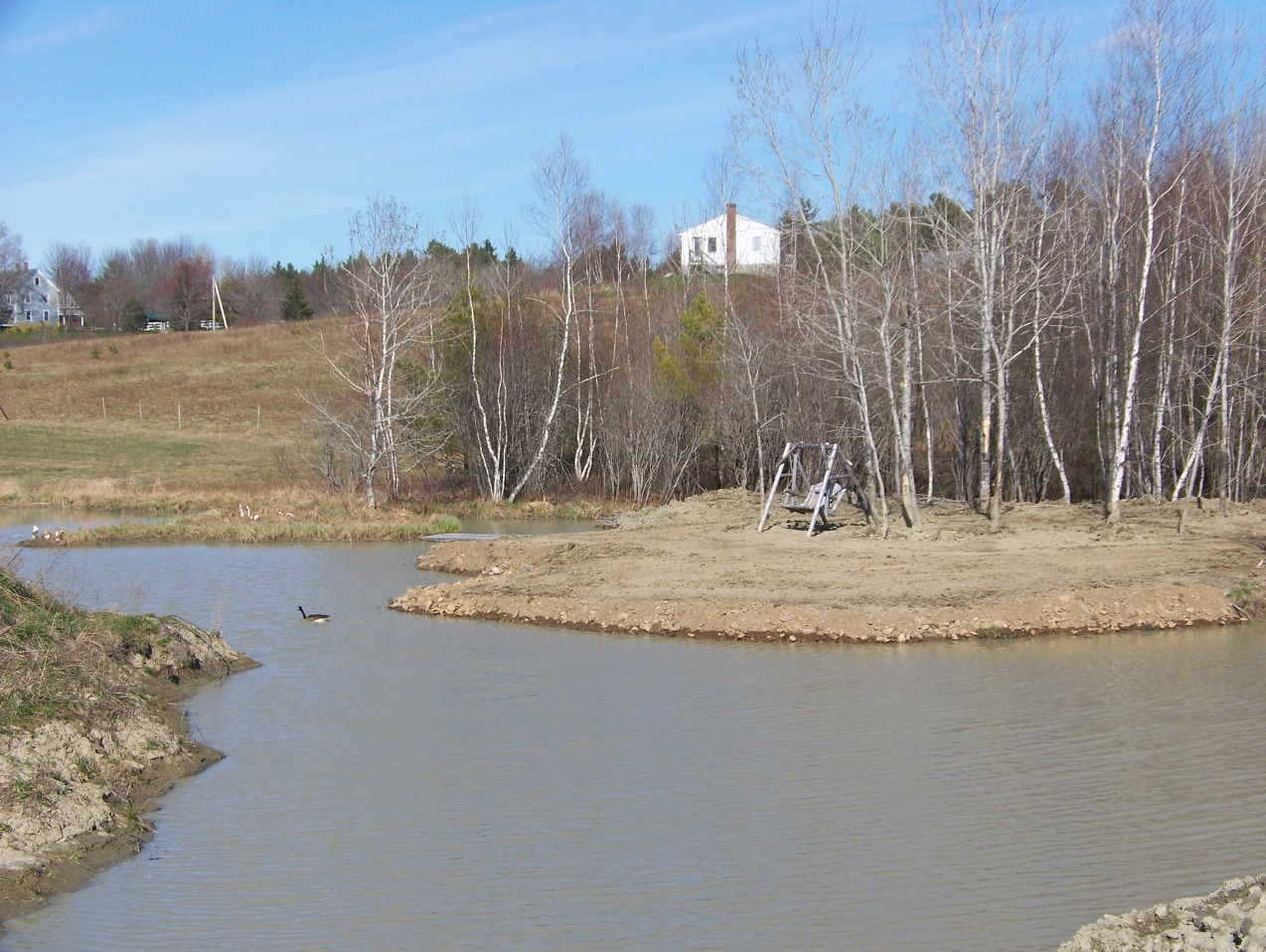

Hi all,
Sorry that I haven't posted as the summer and fall months were CRAzy:eek:
There have been a few changes. The little time that I had off we worked on the house. I Finnished the siding and soffet work on my garage as well.
the tractor and trailer worked well together. I believed that I relocated about 200 yds. of dirt.
I can't seem to get the pictures to post so I will have to reboot and try again.
Phil
/ Pond dreaming is over
#95

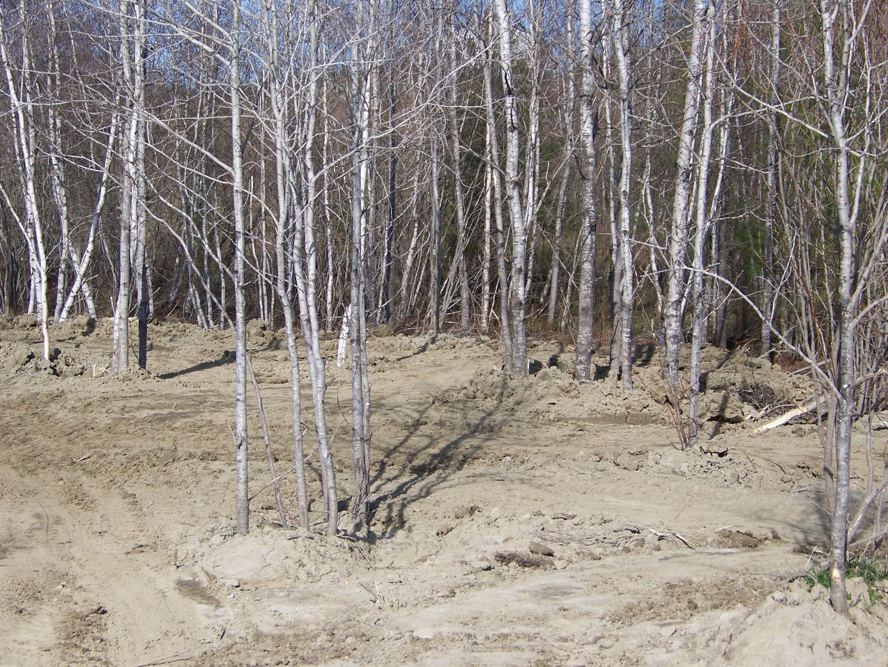

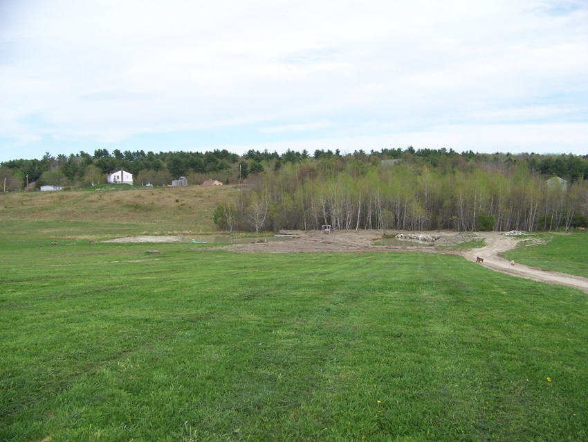

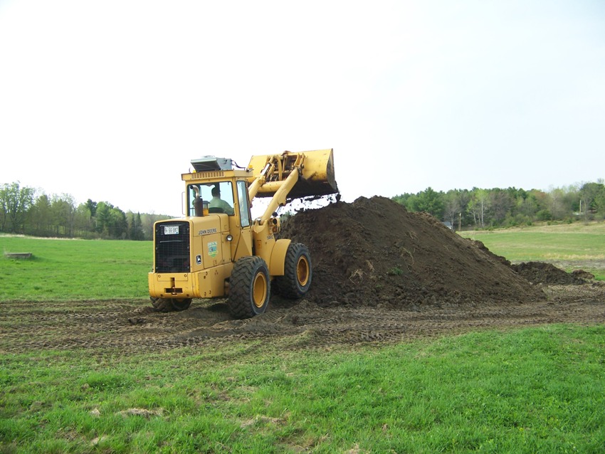

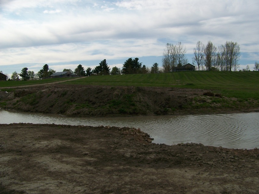

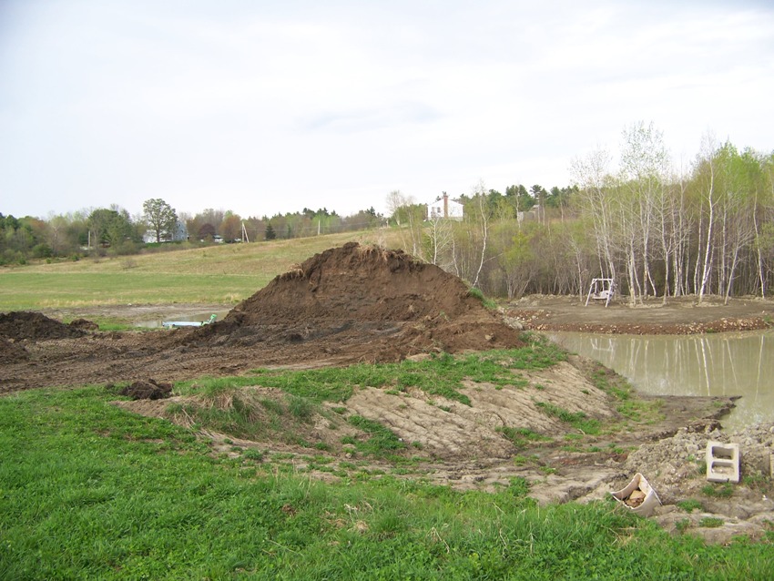

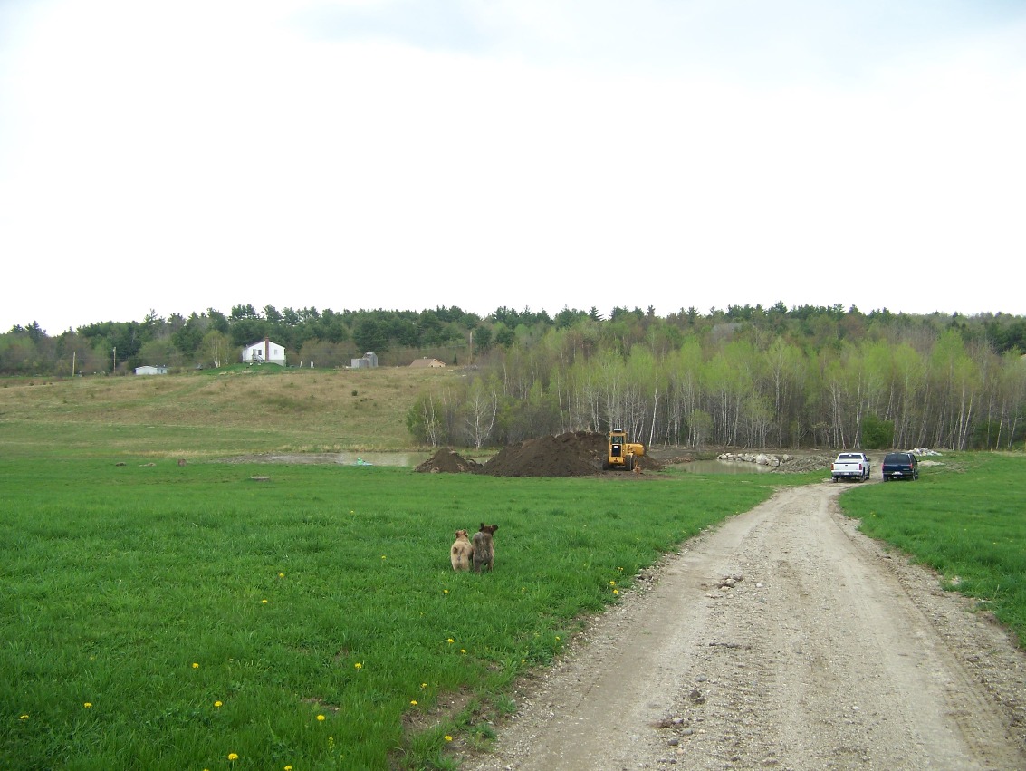

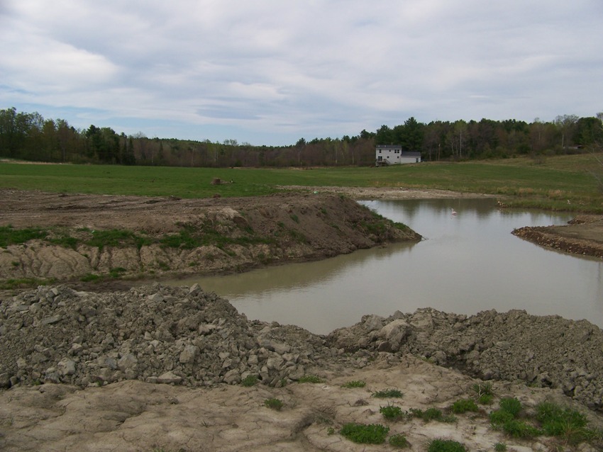

I opened a photo bucket account per my daughters suggestion.
The first pic is looking from my back yard. I have done some digging on this end with a rental track hoe mini. The job site work was 45 min and the pond work 7 hrs . This added about 400 more sq ft. and a back line river through the woods to the other end of the pond.
Here's the mini NICE

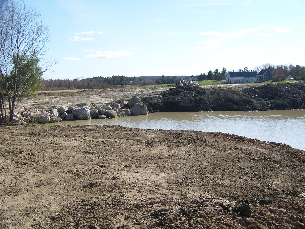

Here is a rock that I dug out of the drive.
The Massey had to drag the rock it was too heavy to lift.
This rock will be added to the ponds edge in the spring.

Phil,
Nice to see you're still digging!!!

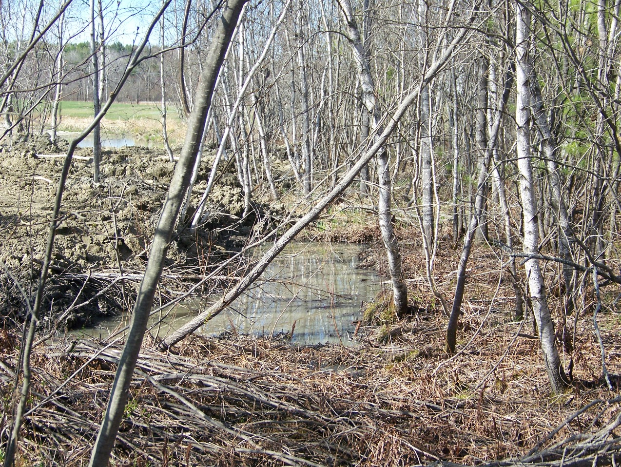

What is the purpose for the line through the woods? It looks like a great place to build a bridge!!!
Eddie

Eddie,
The water way through the woods is to create an alternate and scenic path with the paddle boat. The Pond is small and can be quite boring for the kids. I also hope to capture water from the far back corner of the wood that drains away. We will be having 2 bridges one will cross this path and the other will be much larger out to the island.
