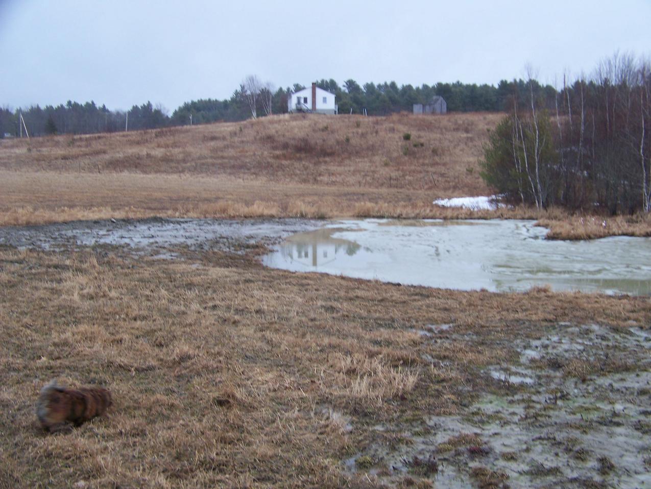

Now for the road to the pond. Late fall of 2005 i used my 48" tiller and tilled the future road to the pond. Summer of 06 I started to dig it out about 10" deep from the surface. There is a gravel pit about a mile away so I traded with the owner on a 1 to1 basis. That was about 150yds. fortunately I have a SS and 5yd dump truck at work that made it easy SS in the pit and my Massey at home. It took about 3 days off and on. my wife and daughters helped load the baseball sized and bigger rocks in the fel to be used for riprap at the pond.
The last pic is a low spot. ( pond road 4)Now can anyone tell me what a french drain is? I've seen that posted on another thread without explanation. I hope it's something I can use to drain this down to the pond.

Phil,
Why did you dig out the dirt ten inches for your road? Was that all topsoil? From what you've said about your pond, your land is clay?
For a road to work, it needs to be dry. To keep it dry, you build up the middle of the road higher then the water that will drain along side of it. In areas with allot of rain and water, you dig that trench down as deep as you can and build up the crown as high as possible.
You didn't do either on your road. Since you already have more then enough gravel, I'd consider digging out trenches on either side of the road. This is not an area for a french drain. This is where you need open drainage to handle as much water as possible and to keep the road surface as dry as possible.
You did it backwards, so it's going to be tougher to dig the drainage. Is it cheaper to bring in another ten inches of rock?
If you need to water to cross your road, put in a culvert. If you get allot of rain, put in a big culvert. I get quite a bit of rain here, but rarely need anything bigger then 12 inches.
A french drain is a way to get water from a yard without it looking like a drain. It's expensive and in time, it will fail. You can spend more money and make it last longer, but it's still gonna fail. It's just a matter of how long until the silt and sediment blocks the entry holes to the pipe, or the pipe clogs up.

Others will no doubt describe a french drain, but it appears to me that you will need a culvert first. That water in the fourth pic obviously wants to cross the road. You'll need to do it put a ditch along the uphill side of the road (better to do one along both sides, actually). Then you need to put a culvert under the road to divert the water from the ditch you just made. The culvert doesn't have to be big - 6" or 8" is usually enough. It looks like it would want to start on the left next to that young tree and cross the road at an angle down hill.
After the culvert is in you can do a french drain or a tight line down to the pond to dispose of the water.

Eddie,
I do have about 6 to 14" of top soil that is why I removed it.
I understand the trench method on each side fo the road but, I don't want that. My neighbor has horses and they have someone hay the feilds. I like to maintain as natural a feild as possible so he won't have to lift his equipment. The hillside is groomed with horzontal rolls.(I bought the land this way 20 years ago) I assume it was done that way to help prevent errosion.
lopezian
A culvert would also creat a ditch in the field making the mowing harder.
Please keep the suggestions coming something should work.
Phil

The road has dried up must have been some frost below it no longer has standing water.
