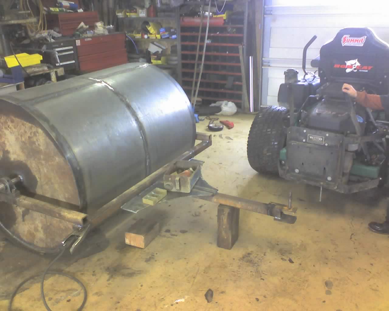

Diameter is what determines the ground compaction, NOT width. A 36" wide roller @ 24" diameter is going to have the exact SAME compaction as a 60" wide roller of the same diameter.:thumbsup:
Larger diameters get greater compaction because of added weight. But NOT larger widths. So if you want the MOST compaction you can get, get the largest diameter you can.
We made one 38" diameter out of 1/8" steel. Very heavy duty. It weighs more empty than most 24" do filled. AND we can add ~1850lbs of water. It is only a 48" roller as well:thumbsup:

You got it:thumbsup:
Length dont mean squat as far as compaction. It's all in the diameter.
Enjoy:thumbsup:
