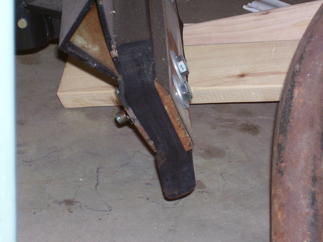

Builder, have you ever thought of using the rubber edge? I got a piece of this very hard rubber like material that was used on a county truck. A friend of mine who works for the county got it for me. It certainly does not clean as well as metal to asphalt but then again you don't have to worry about damaging stuff. I've also noticed the state road crews that plow I-95 here in Maryland use the rubber edge.

I have been using a rubber edge on my Kubota for years.
The Kubota rubber is soft.
I found the folks at Smith Industries very helpful. They took an email picture from me and cut a replacement edge for me. They were great to deal with despite me just being a homeowner in CT. If you Google it you will find them. They live in Rockford ,IL.
The new squeegee was 100.00 and has lasted. The Kubota one was/is 230.00.
I have plowed ice, rocks, and it still cleans my asphalt driveway clean and without damage.
