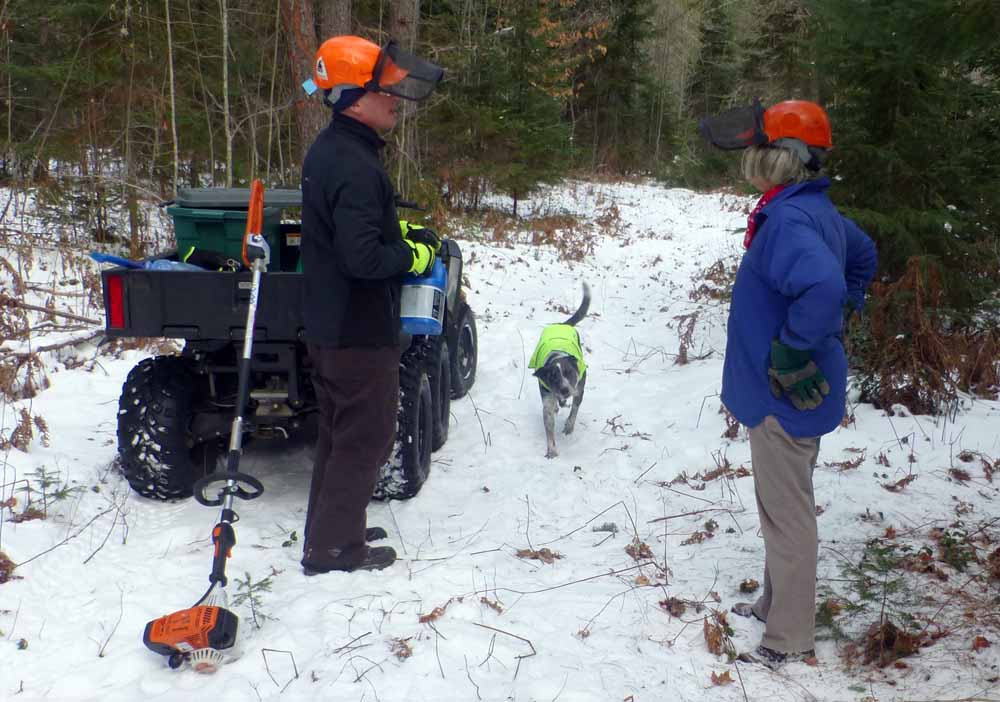

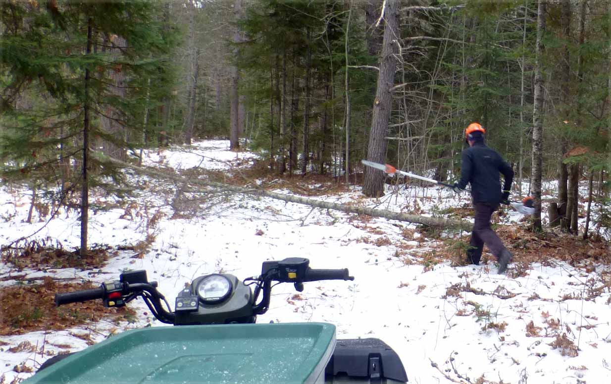

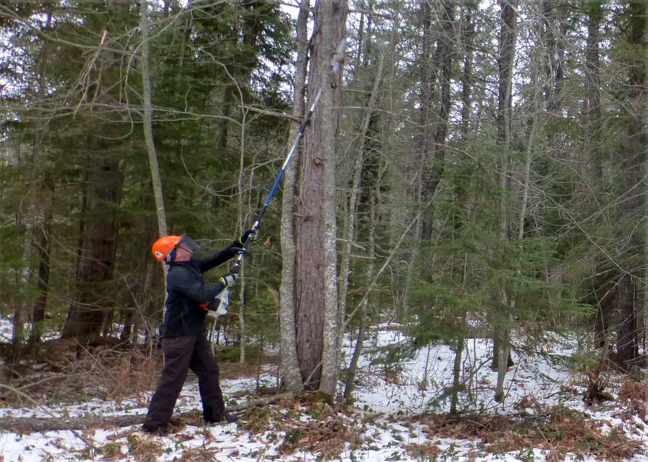

Our clearing some ski trails today. Pole-saws rock!

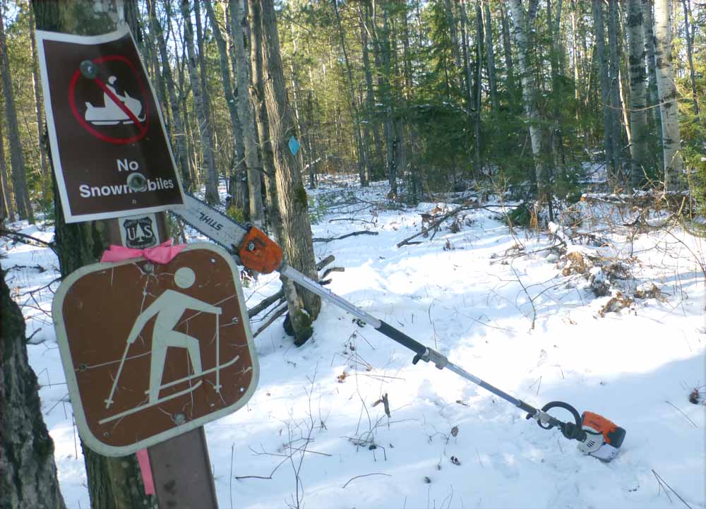

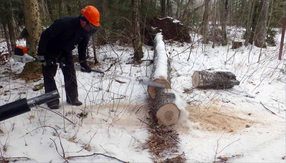

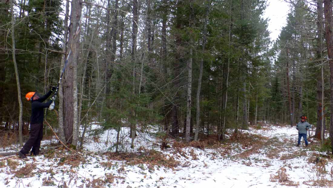

Today in the field with da saw.

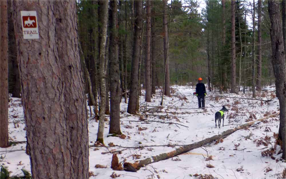

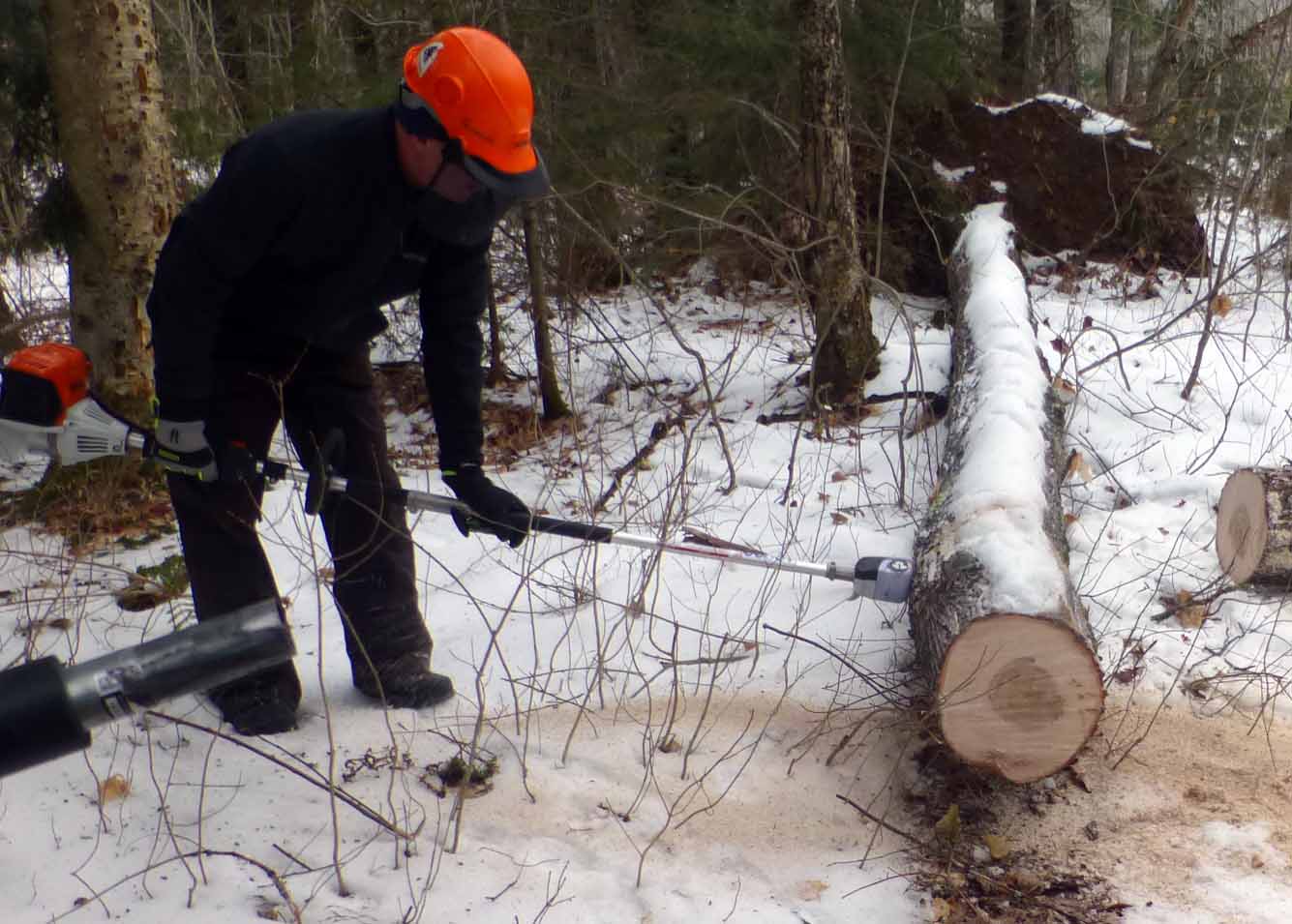

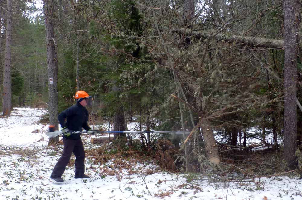

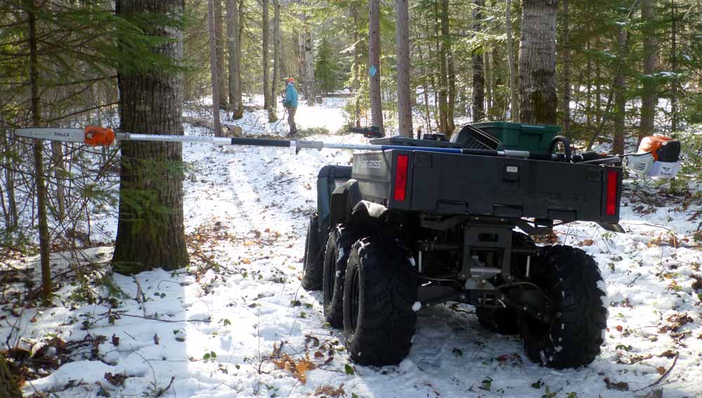

A few taken today while clearing a XC trail in the Ottawa NF. This is in the UP of Michigan.

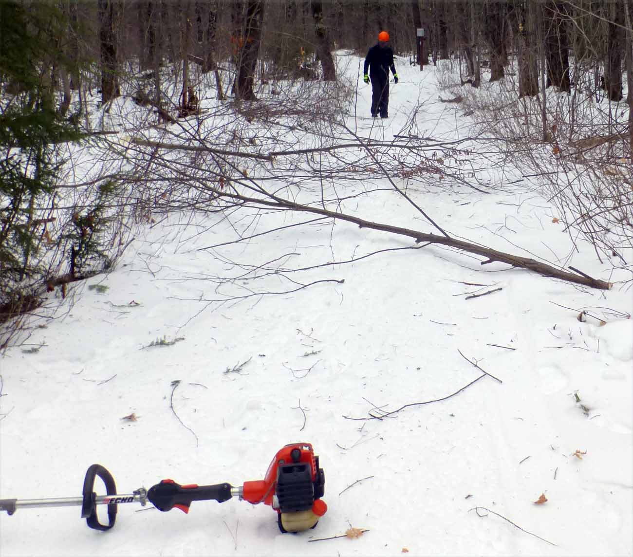

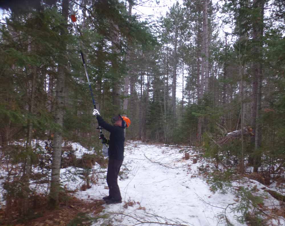

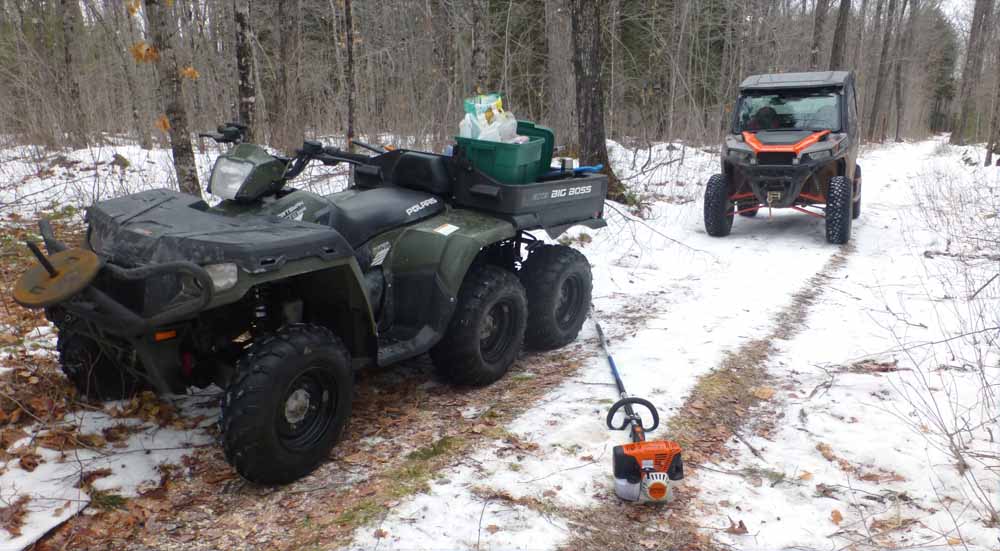

Some trail clearing photos taken today. Long live the pole-saw.
