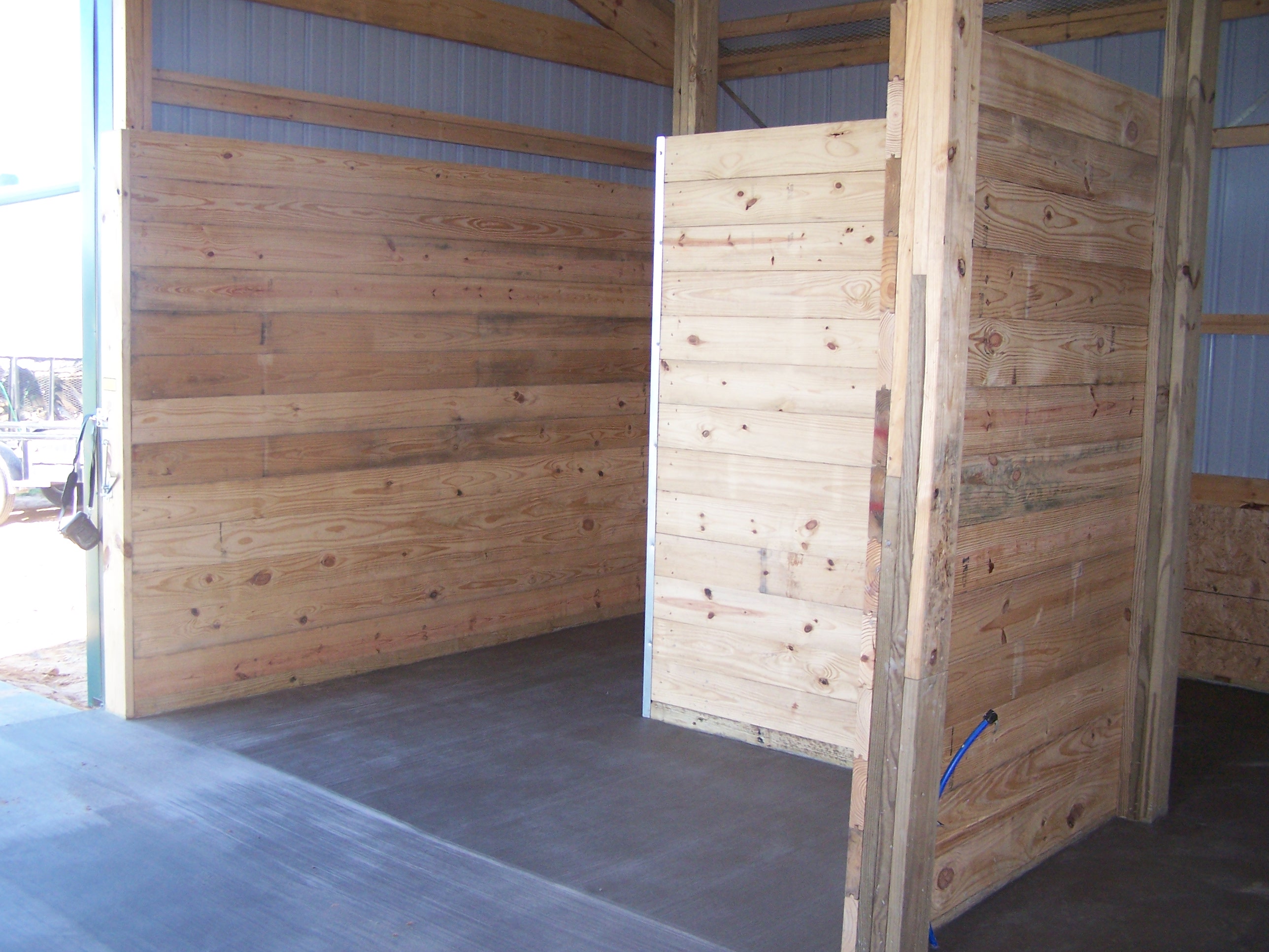

Morton built our stables 48'X36'X10'. They build their posts by laminating 3 2X6 so there is not any warping. They are on 12' centers.

The trusses were built at the Morton factory. Two 18 wheelers showed up and offloaded the materials and the trusses were already built. The posts were built onsite, glued and nailed. If you zoom in on the left post in the second picture you can see how they cut the center 2X6 short and place the truss in the notch. They then bolted the truss to the outside members. The 2 2X6 inverted Ts between rafters is how I mounted my 8' flourescent lights.
