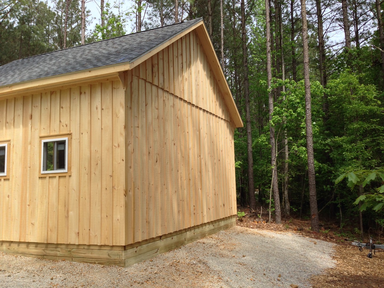

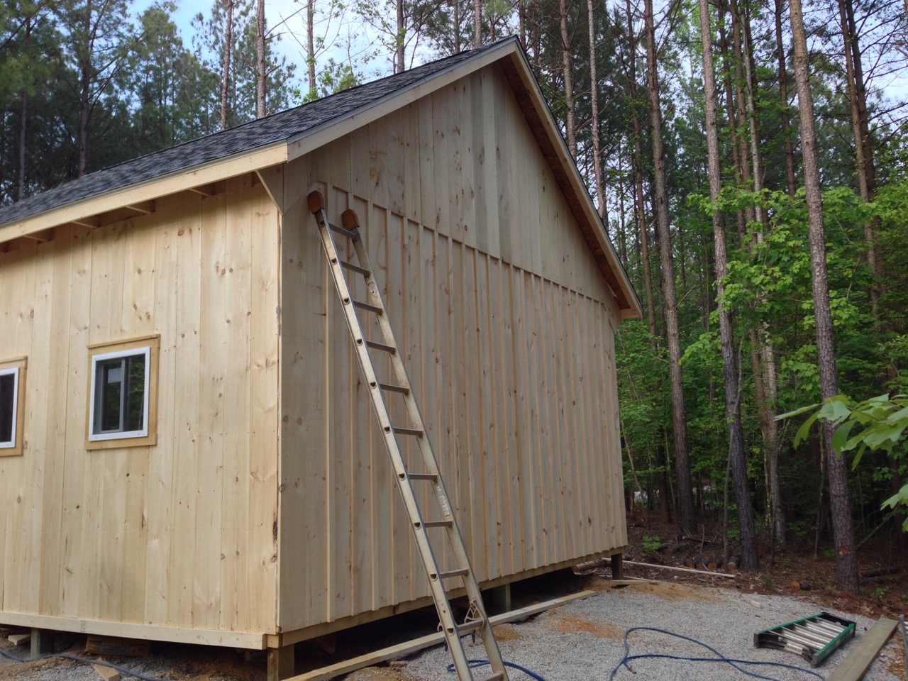

For a pole barn you only need to make the worksite level enough to work on. You can backfill inside the barn (inside skirt boards) afterwards for final leveling. Whether or not this makes sense depends on the barn, the site, available pole length, and other factors, so I'm just giving general advice. I have built a couple on sloped ground and the downhill side just gets an extra skirt board. Fill and level the inside with gravel.
BEFORE SKIRTS INSTALLED:
AFTER:
AFTER:
Thanks - this is basically what the builder would like for me to have prepared. Another option for me would be to rototill the sod first, and then scoop it out with the loader. That might be a little easier. After I removed the base sod I would level it out with either the box blade or soil pulverizer.
