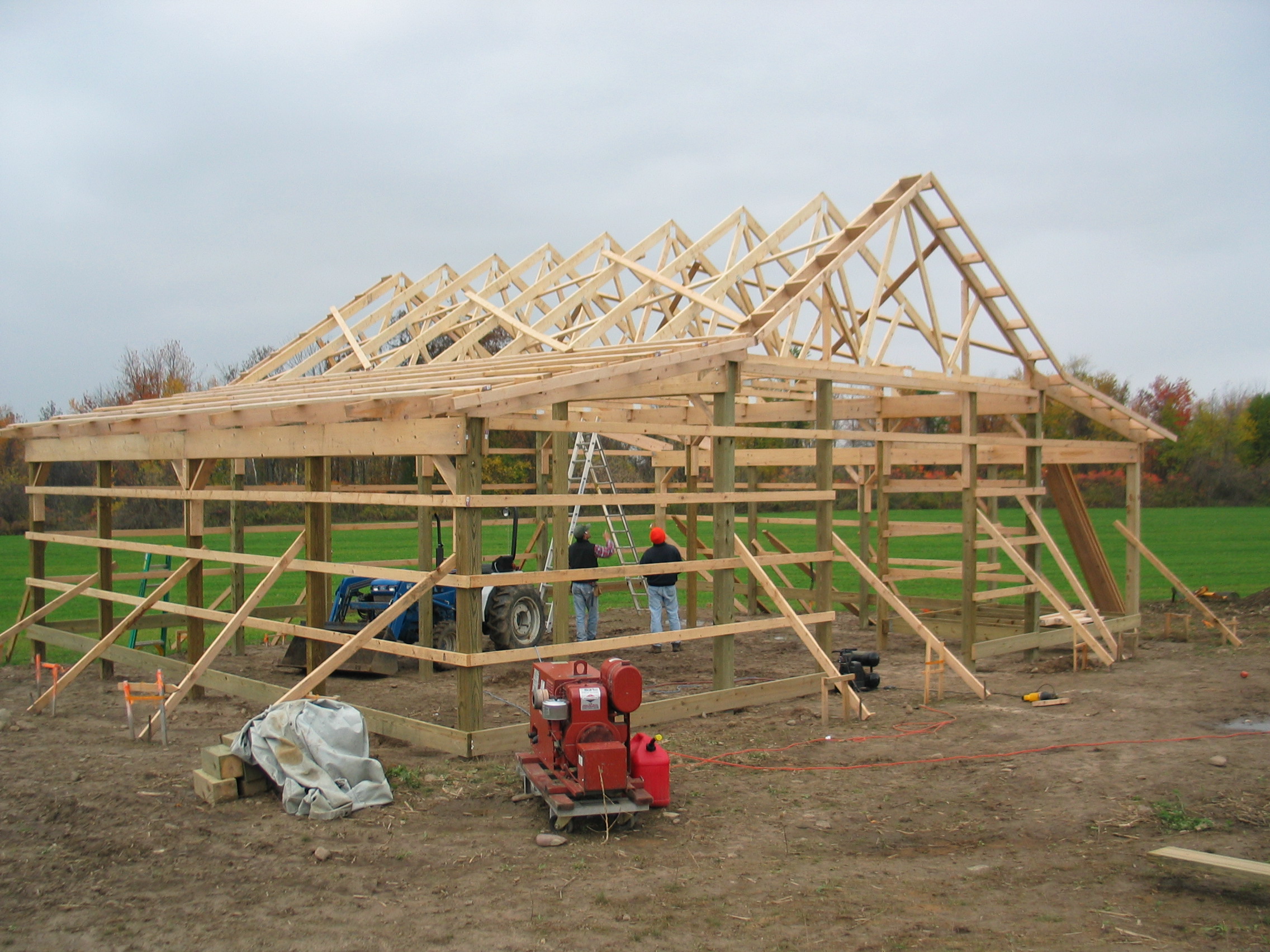

   / Pole Barn question??? #8
As others have said, you can do it many different ways. On my 32 x 40, I pulled off the top soil, set the poles, and framed it. I then back filled in small lifts, compacting between. Once I had it close to grade inside and out, I sided and roofed it. Why in this order - seemed like the way to do it at the time. It's now been 6 years, and I never had an issue with settling or otherwise.
A friend of mine built a similar sized barn and hired an excavator to come in, level the area, and put stone down prior to anything. He quickly found he couldn't use his PHD (same one I used on mine) as the fill that was used was very rocky.
Many ways to skin the cat.

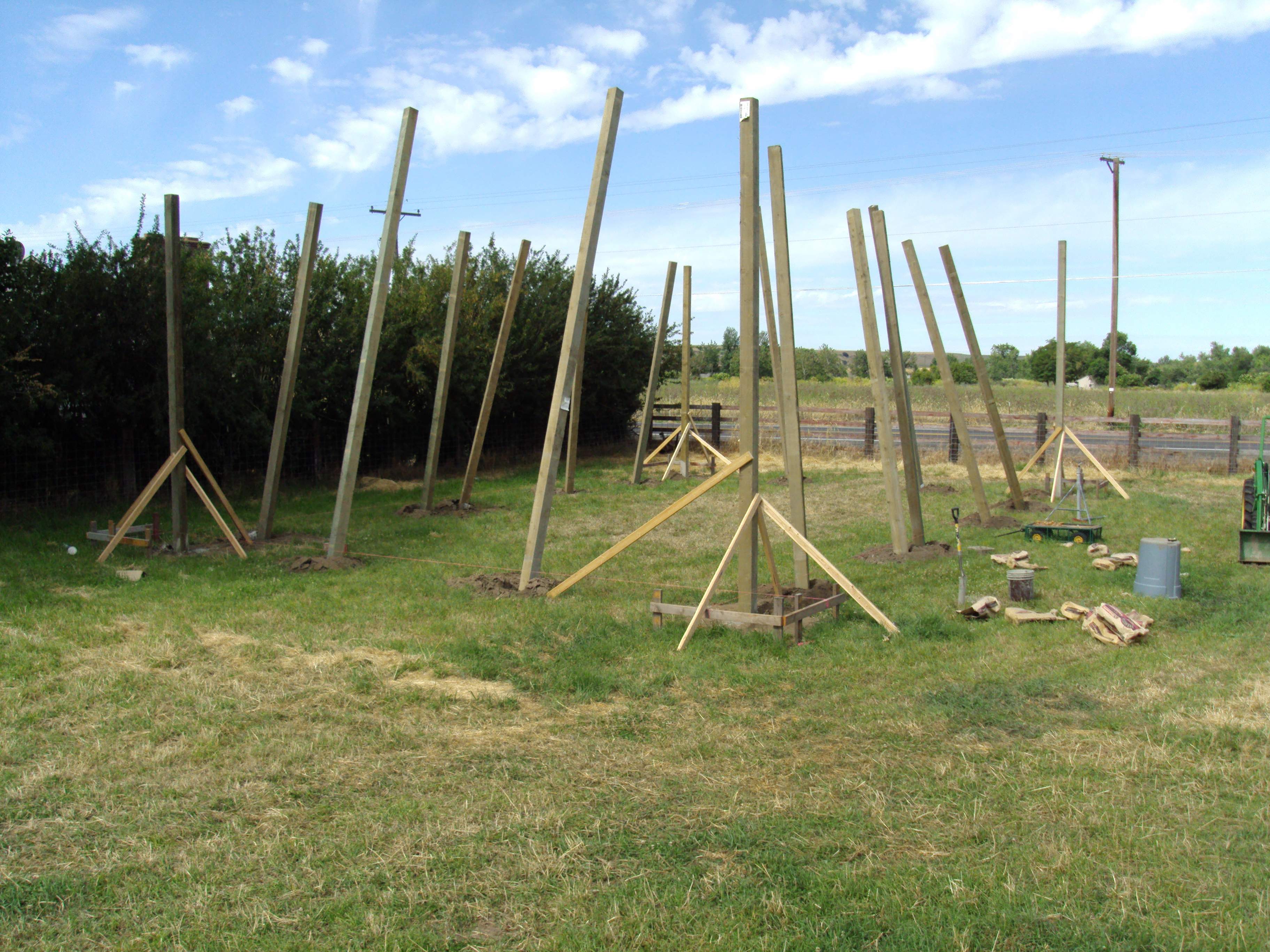

Well i decided to install the poles first. I have the corner poles installed and braced.... plan on putting the 4 gable posts in today but i have all the posts temp installed right now and so far so good.
The begining of a 30x50x16
