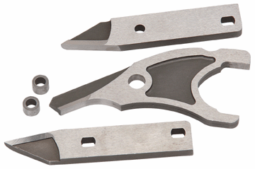

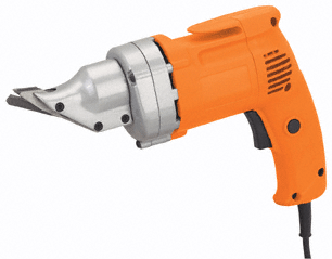

The professional crew that built my barns has been doing it for 35 years. They use this tool, a metal shear that costs $39 at Harbor Freight. They build about 75 barns a year. They told me they get very good service with these tools.
Harbor Freight also sells a replacement blade and anvil set for it for $19.
I think this qualifies as a Harbor Freight tool that doesn't suck.
It has a swivel head to make cutting curves easier.

The HF shears shown do not work (for me at least) cross panel, they do not have enough bite to make the ribs. You need to bend the metal quite a bit to get them to go through. They are however EXCELLENT at going lengthwise on the panels, better than the air shears, they have a different head on them.
Cross cuts on the ground, two people and the hand shears worked about as well as anything for me. (like doing the 45's where the panel meets the roof)
