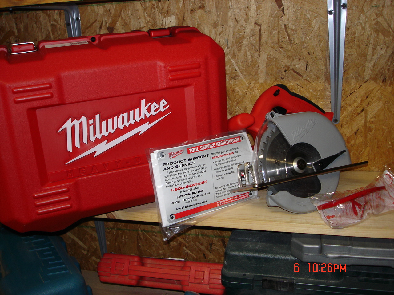

I have a Milwaukee metal cutting circular saw that uses the 18 volt batteries.
It makes very smooth cuts quickly in pole barn metal. I purchased it from Amazon.com. I had a very bad experience with one of the vendors,
:mad::mad::mad:
I returned it and bought it again from Tool King a very good vendor.
I cannot fault the tool it works better and faster than I have ever imagined. I wrote a very extensive review on the Amason site and uploaded pictures to show the details. Please visit this site and take the time to read the review and look at the pictures. And please vote if you found the review helpful. :D
I don't get anything for writing the reviews but it makes me feel good when people find them helpful. I have a lot of reviews on Amazon. Please look at them if the products are of an interest to you. ( am a "tool guy" so there are a lot of tool reviews.):D:D:D:D:D
This is a link to the tool on Amazon
Amazon.com: Bare-Tool Milwaukee 6320-20 18-Volt Ni-Cad 6-1/2-Inch Cordless Metal Cutting Circular Saw (Tool Only, No Battery): Home Improvement
