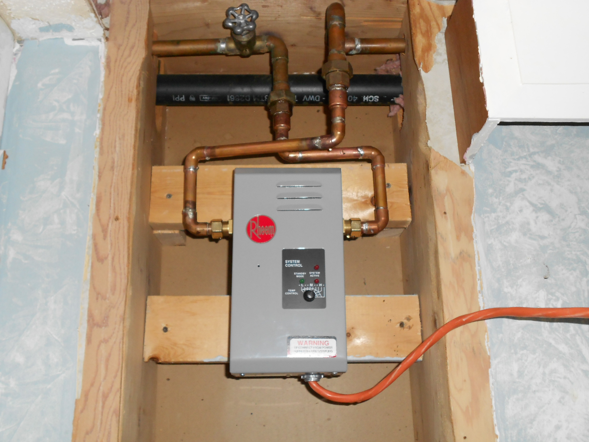

Here is a pic of mine.
Too bad the supply line is on the wrong side. :(
I coulda mounted it facing the wall or upside down.
