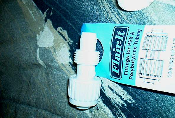

The best thing to do is junk it. I've heard people say that the only problem with it is the banding they used to put it together but that is BS. I have had lots of leaks in the middle of a run, nothing near it to punch a hole in it, it just starts spraying. Practically, though, unless your dogs have totally tore the underlayerment out from under the house, you need to patch it if it starts spraying. I use PEX to splice bad sections. A lot of plumbers just love PEX just like they loved PB when it came out. We'll see how it turns out 15 years from now. I use Flair- It fittings to splice the PEX into the PB. When you use the fittings it makes life easier if you soften the ends of the tubing with a lighter before you stick it on the barb on the fitting.

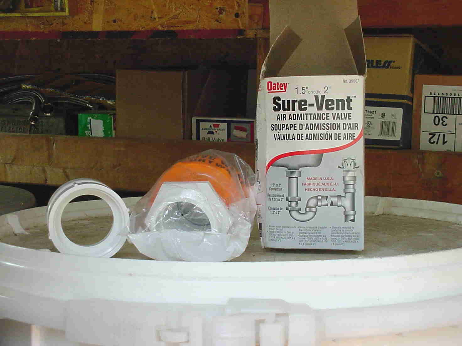

On three inch pipe you only need an 1/8" per foot grade. That 1/8" saved adds up quick if your tight on room. On 1-1/2 and 2 inch you need 1/4" per foot grade.
The black air addmittance valves aren't legal in this area for jobs that are being inspected. On those jobs I use a studor valve, look the same but will not let water leak out if their is a blockage in the drain line. I've got one in my plumbing truck if you want a pic of it. You need to put a san tee inside the vanity about 18" off the floor to the center of drain and coming out of the top of the san tee have at least 4" long piece of pipe going to the air valve. This helps to keep junk from building up in the bottom of the valve.
By your drawing I would just put a 3x1-1/2 wye in your toilet arm for your lav. You can run 2 inch but 1-1/2 is all that is needed. The lav is only one dfu. It's a simple wet vent.
Good luck if you need more help just holler
Gordon
   / Plumbing help please... #15
Yes, I would love to see a picture of that Studor valve. I was just checking my local MH supply house's catalog and they don't seem to list the Pro- Vent anymore.
   / Plumbing help please... #16
Here is a pic of the valve.
Gordon

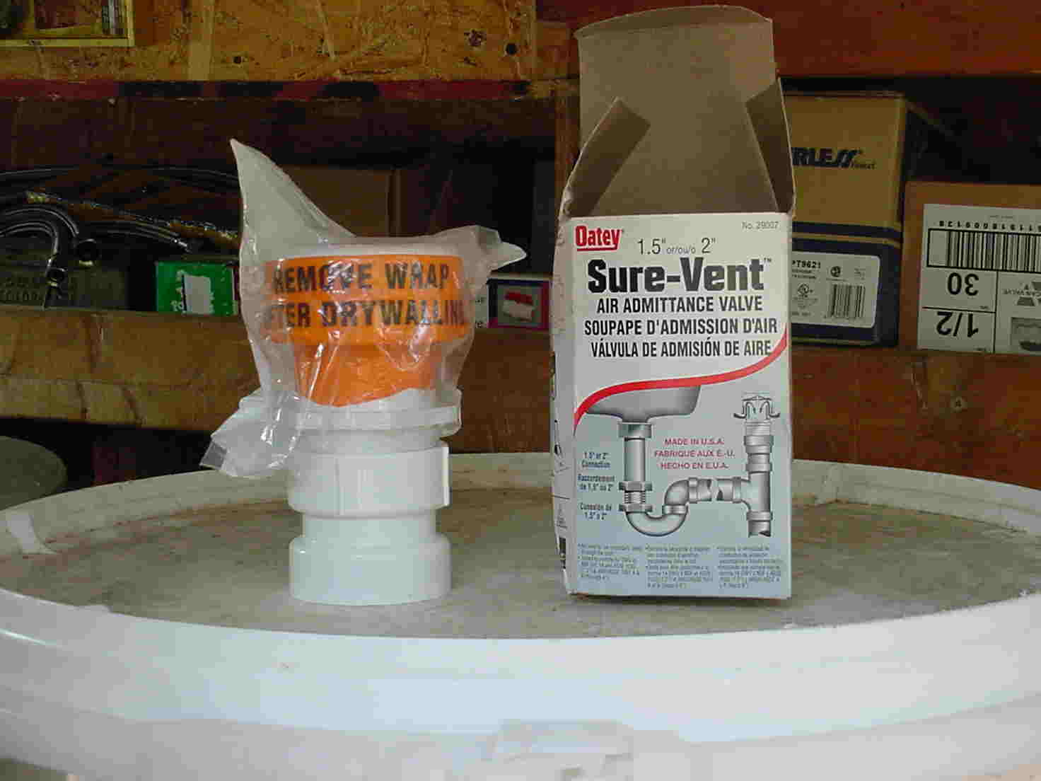

   / Plumbing help please... #17
Here is a second pic with the 2" female adapter removed.
Gordon

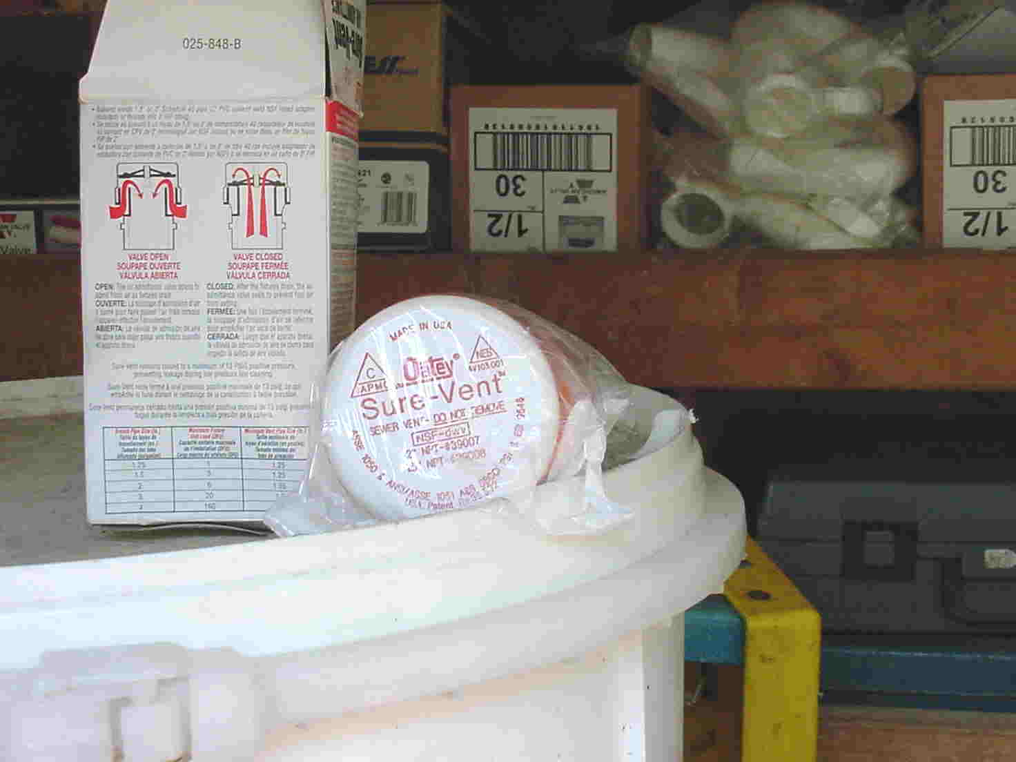

   / Plumbing help please... #18
Here is the last picture. Hope they help
Gordon
