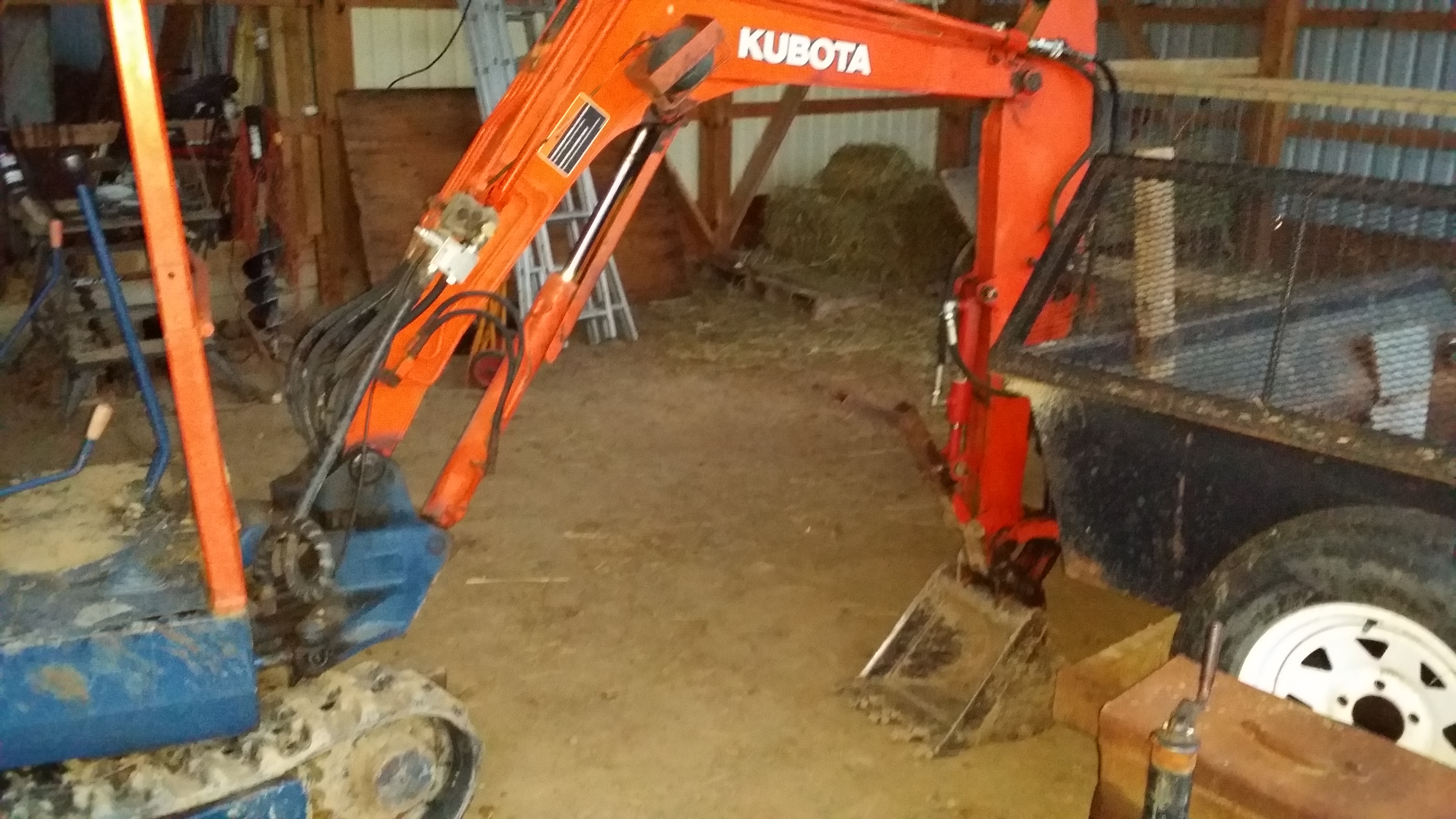

On my mini excavator I have put an Adjustable Relief Valve in the hydraulic line to the thumb cylinder. I did this to restrict the forces on the thumb/bucket bushings. I have adjusted the pressure so that it still (barely) holds what I am lifting. The bucket will push back the thumb. This setup would prevent the destructive dead heading on your machine.
To plumb it in: put the Relief Valve in series with thumb cylinder, than ad a hose from relief valve to tank. Cost about $100

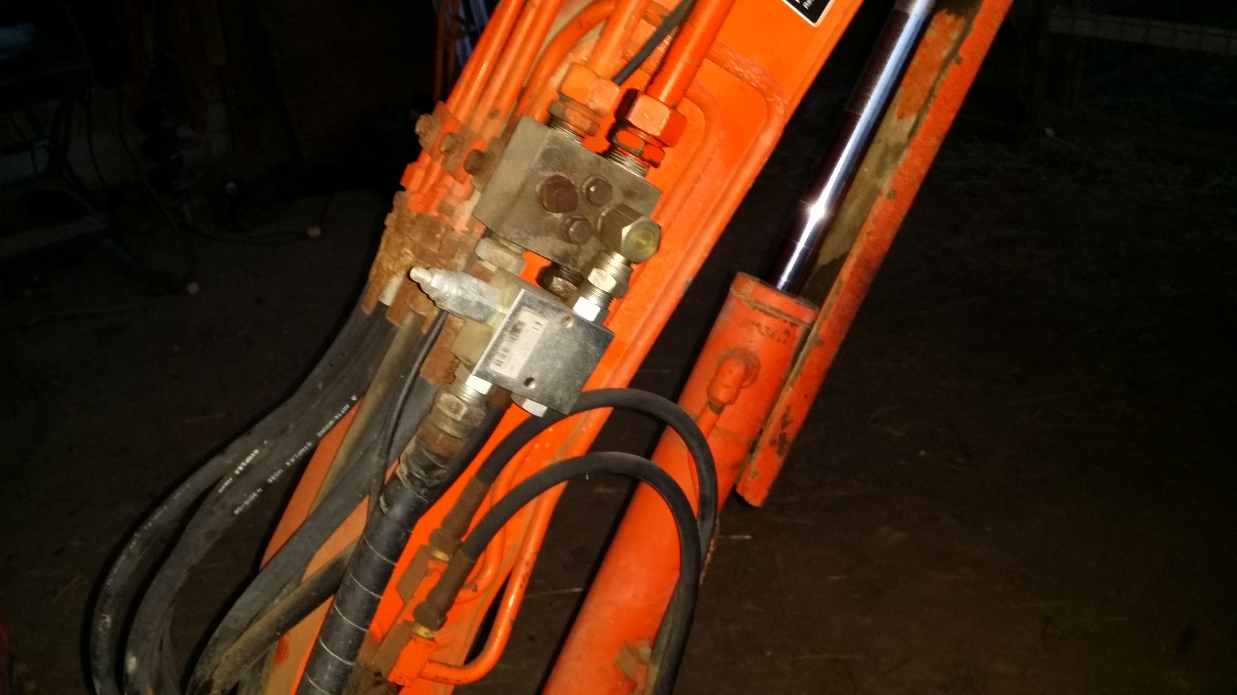

A relief valve P-T-P (pressure- tank-pressure, no check valve, only relief) could be plumbed in series into either cylinder port.
On the second picture you see a connector block with plugs where the hoses connect to the pipes. I took out one of the plugs and plumbed in the relief valve. The hose on the relief valve goes to tank.
Had the block not been there, then I would have plumbed the relief valve in series where the hose connects to the pipe. It doesn't make a difference if the relief valve is in the extend or retract line, because the pressure is equal on both ports. Only the flow is opposite for extend or retract.
