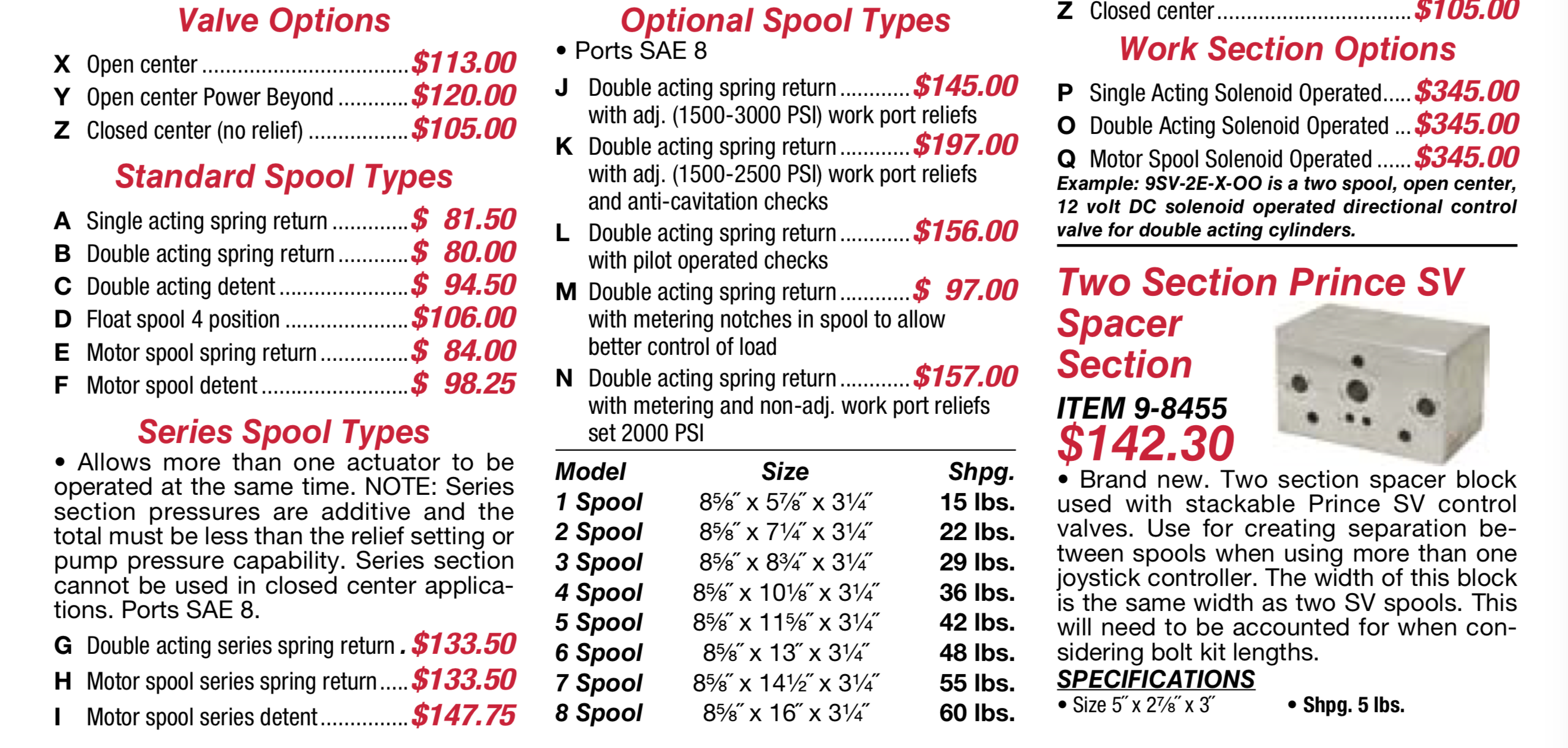

Next time you need an extra outlet, consider replacing or adding onto the existing control valve. Lots of inexpensive to medium priced tractor/loaders come with a standard two-spool double-acting control valve - hopefully with spring centers, one spool with float, and "Power Beyond" capabilty. Contrast that to higher end machinery which often comes with sectional control valves of the type that you can add as different types of parallel circuits and control valves as you want - all with a common pressure feed and common return.
Sectionals valves are great. For rear remotes, for example - you can run your existing Power Beyond to the inlet of a bank of sectional control valves mounted on the fender back by the 3pt hitch.... and then you have the option of adding as many hydraulic circuits as you desire by simply adding more valve segments and longer bolts.
Hydraulic outlets and controls are where tractor dealers seem to make a lot of their markup. Hydraulic parts are inexpensive, universal, and easy to mount..... but for some reason they are a mystery to the average tractor owner. That's good for dealers but not so much so for owners.
I was just quoted $1250 parts plus 8 hours shop time at the dealership to add one extra rear remote to the existing sectional control valve on a JD tractor.
Judging from the prices I see for adding rear remotes to new tractors on TBN, that's not so uncommon.
But compare that quote with the actual cost of the standard Prince sectional valves and bolts which is about $200 per additional circuit. The wrench-time it takes to add the section might be as long as two hours - but only if you stopped for lunch. So it pays to study up.

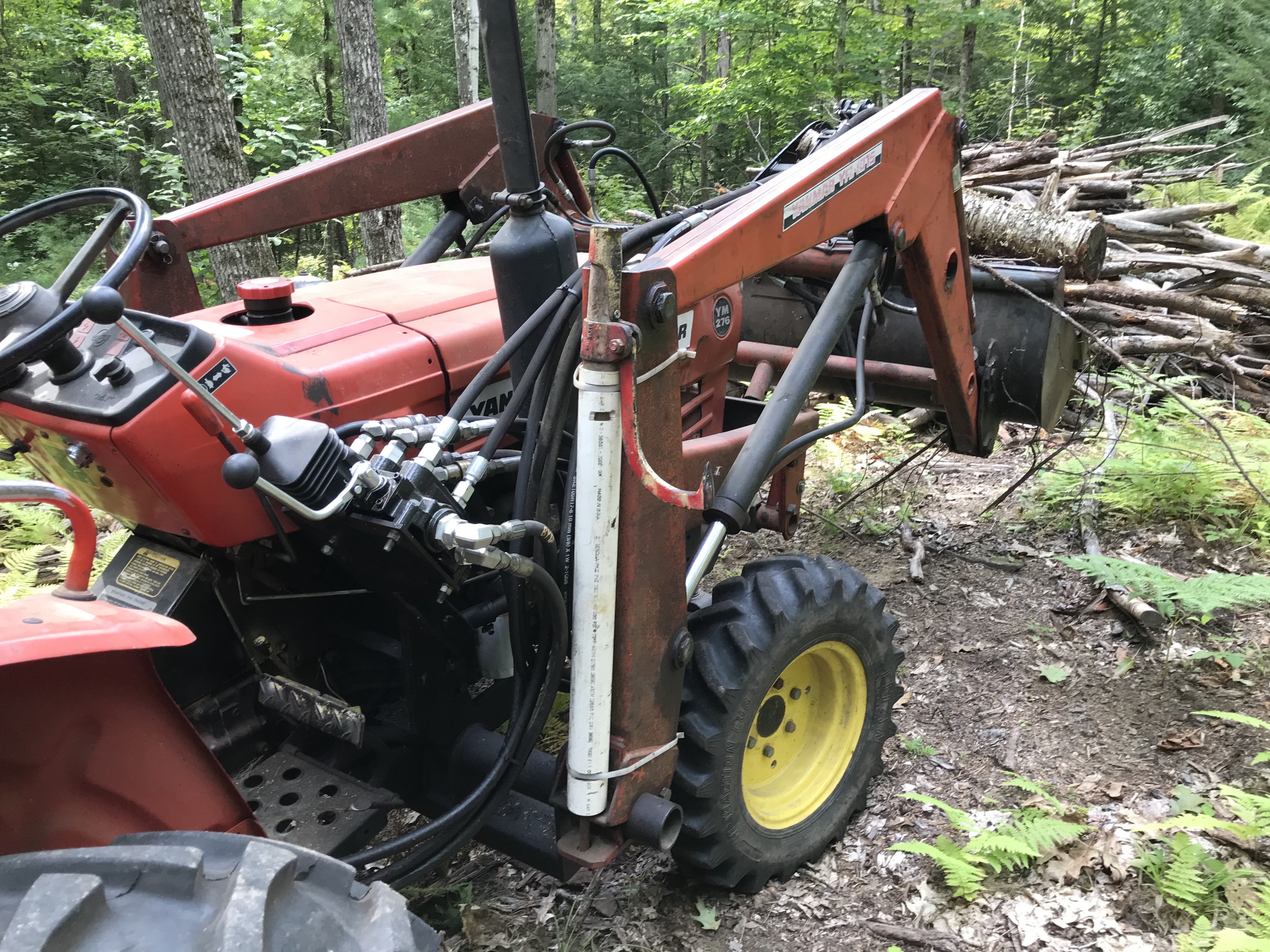

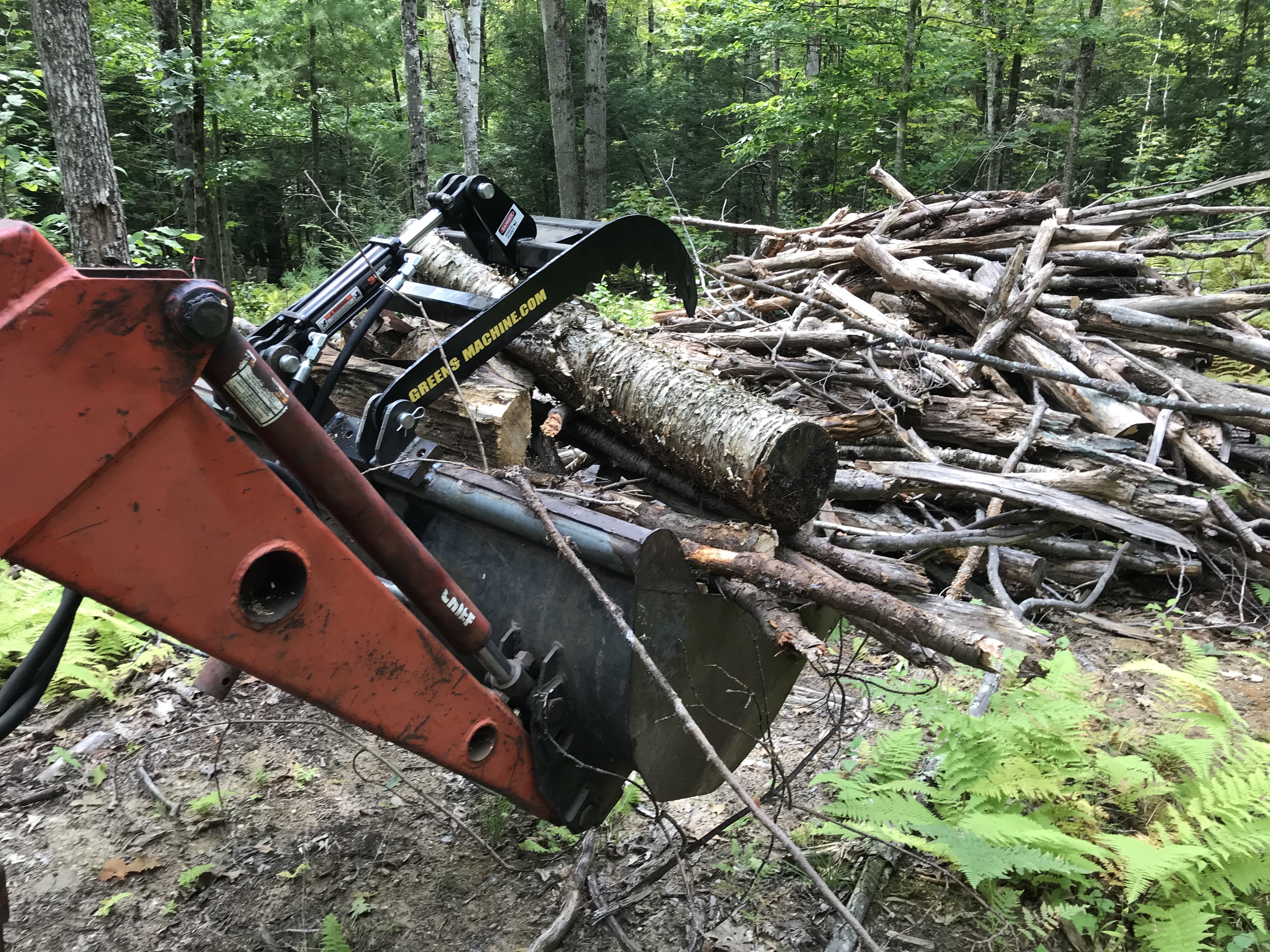

Finally got it done with a lot of help from you all. Made the first post December 2018.
I quit work in March when the virus started. After I got this years wood in and split next years and maybe some moreI thought it’s was time. I went with the “elegant” solution suggested by Winston. Think it did cost less than a third function rig.The old valve was weeping. I bought a new 3 spool valve from Surplus Center and a bolt on grapple from Greens.
I made a template of the bracket to determine the length of the thumb but failed to notice that a pipe welded to stiffen the top of the bucket made it impossible to bolt on. It had to be welded.
Tacked it on and determined the bracket was askew and the clevis wouldn’t fit. Greens made good on it with no question except did I want to wait a week for it to be painted.
I picked up a snow plow that angles. It hooks into the grapple connects. Two for one! We’re getting the first snow today.
So it’s done and it works great. Blows my mind to get into that seat and pick something up that weighs half a ton.
Thanks for all your help.
