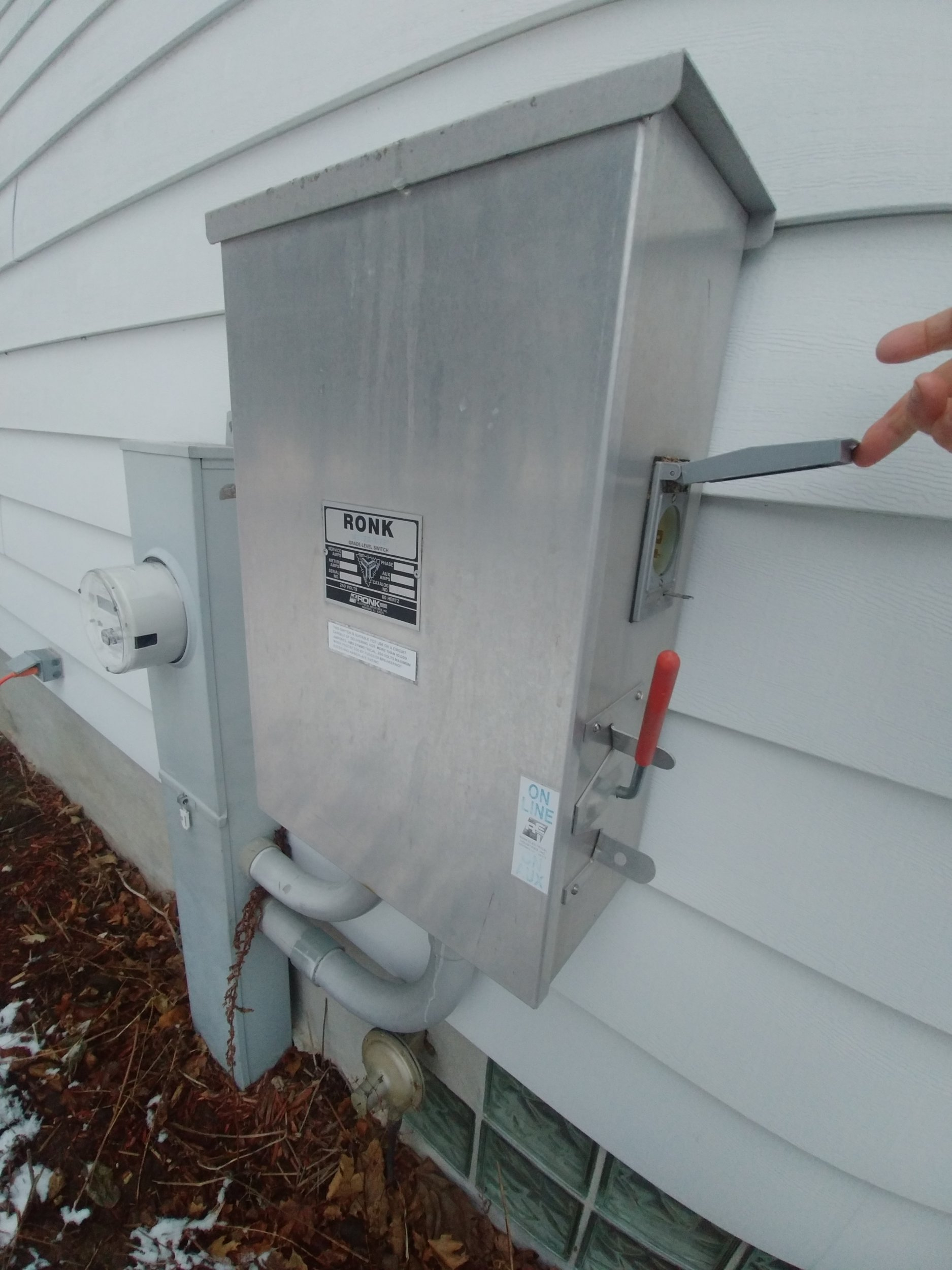

So I have another thread about generators/inverters and looking at getting my place set up in case of emergency.
So that got me thinking that the plug configuration is backwards? I have watched some YouTube’s on hooking everything up and most people plug into the generator then go plug into the house.
Well, seeing that the 14l-30 plug “tangs’ or plug metal is exposed and hot with power from the generator, that seems pretty dangerous and I think the whole configuration is backwards. I would want my generator to have a male plug and my house to be a female plug? Then I could safely connect everything. But I am sure it won’t change but I am surprised there are not more accidents with people fumbling with hot 14l-30 plugs and getting 30 amp pumped into them or their dog when they accidentally drop the plug trying to lock it into the house plug in a storm…
But at least anyone using a generator should know to plug into your house then go plug into the generator second…but maybe there is something I don’t know about a 14l-30 plug. Certainly possible.
Our connection box outside the house. Male end of the cord to the generator, female to the house connection. No chance of crossing the generator with the utility.
