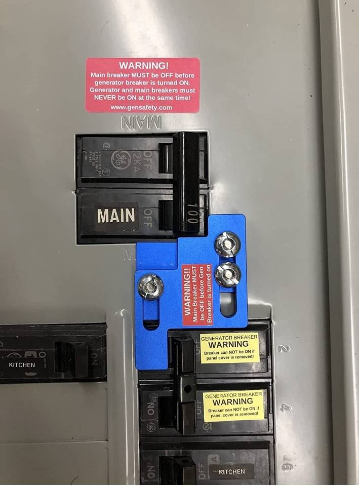

I’ve always wanted to see what kind of generator a homeowner has who could leave his main breaker on and feed all the neighbors, town, etc.. in the effected outage area (island), .. making it dangerous for linemen fixing the distribution line.
That would be some generator.
   / Plugging in generator to your house dangerous? #105
How about we stop insulting each other and, since we already discussed the issue of generators for home backup in several other threads, we should probably agree that the proper way to do it is a cheap interlock at the least.
   / Plugging in generator to your house dangerous? #106
Better yet what you posted! A super simple metal plate for main breaker. $62 Amazon or free if using scrap everyone has laying around .
