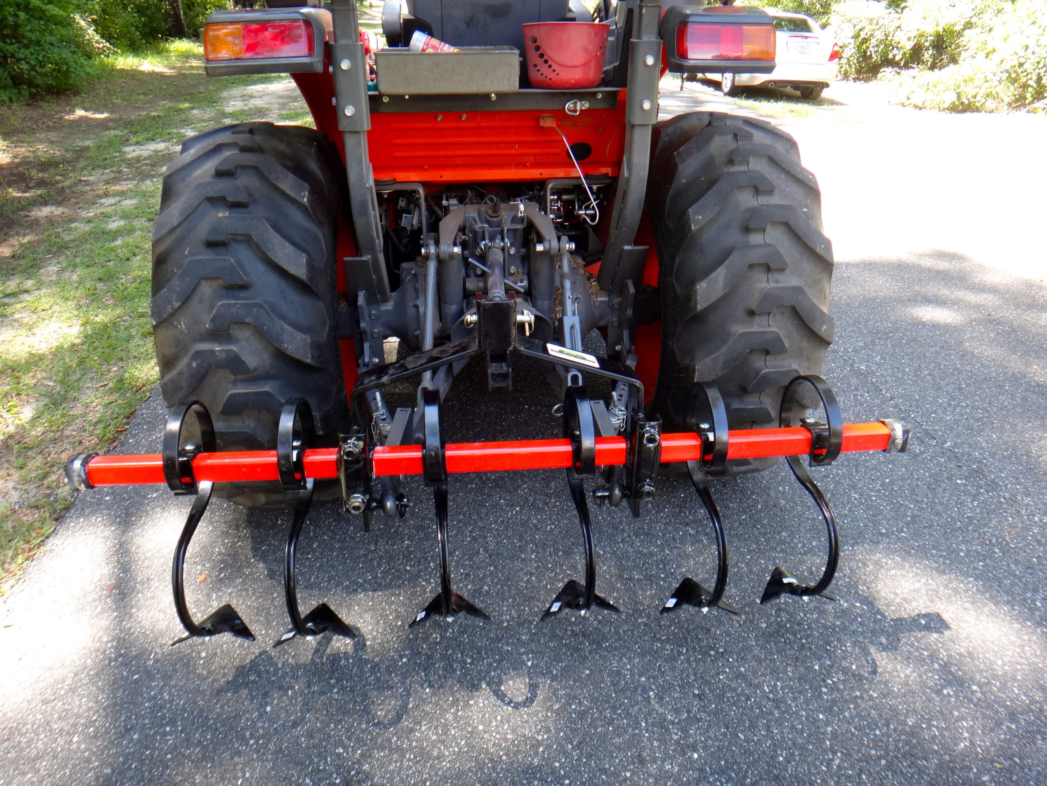

whats the difference between a plow and a cultivator witch is better witch is more productive whats the pros and cons of both
/ plows vs cultivators #3

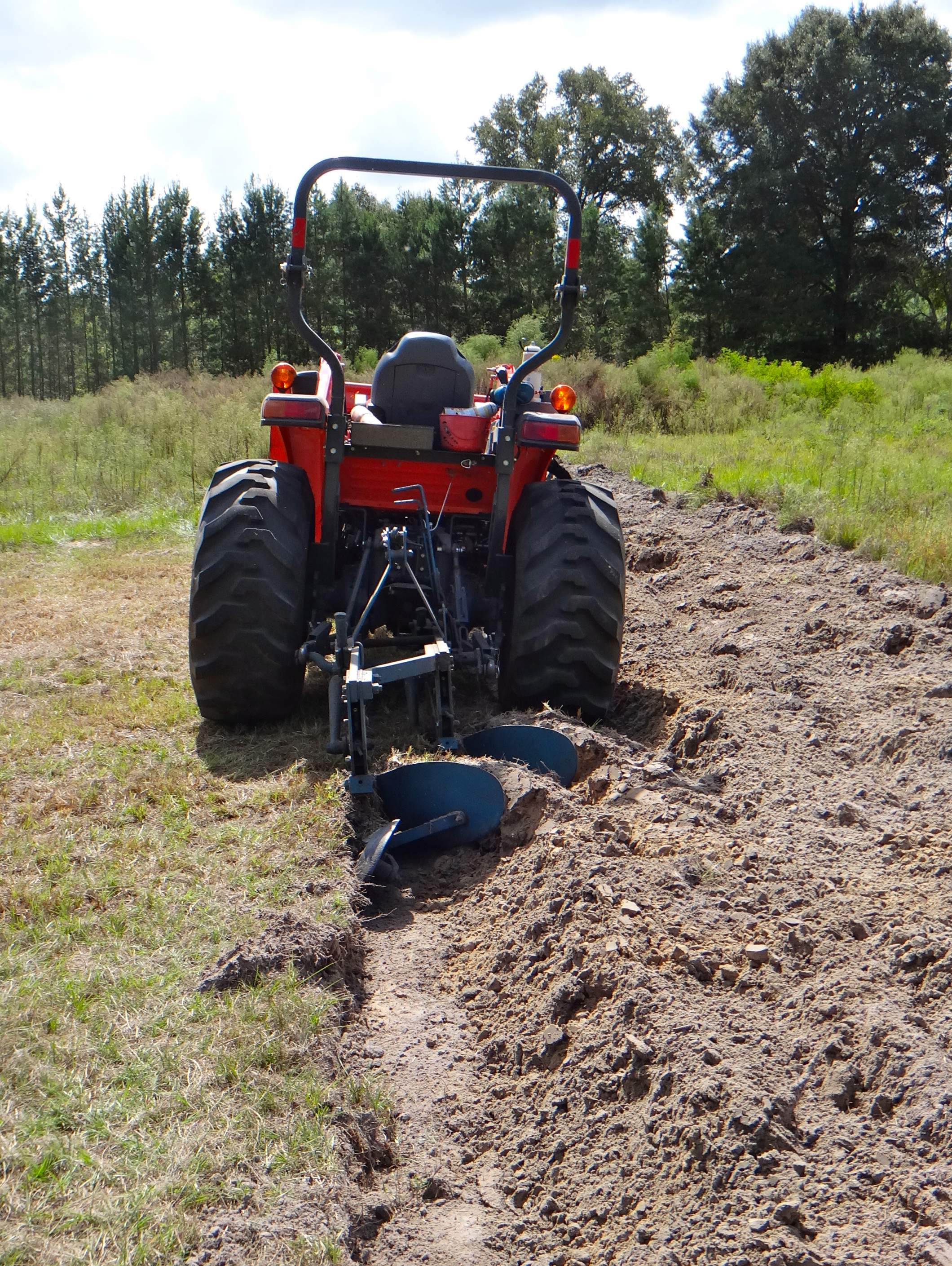

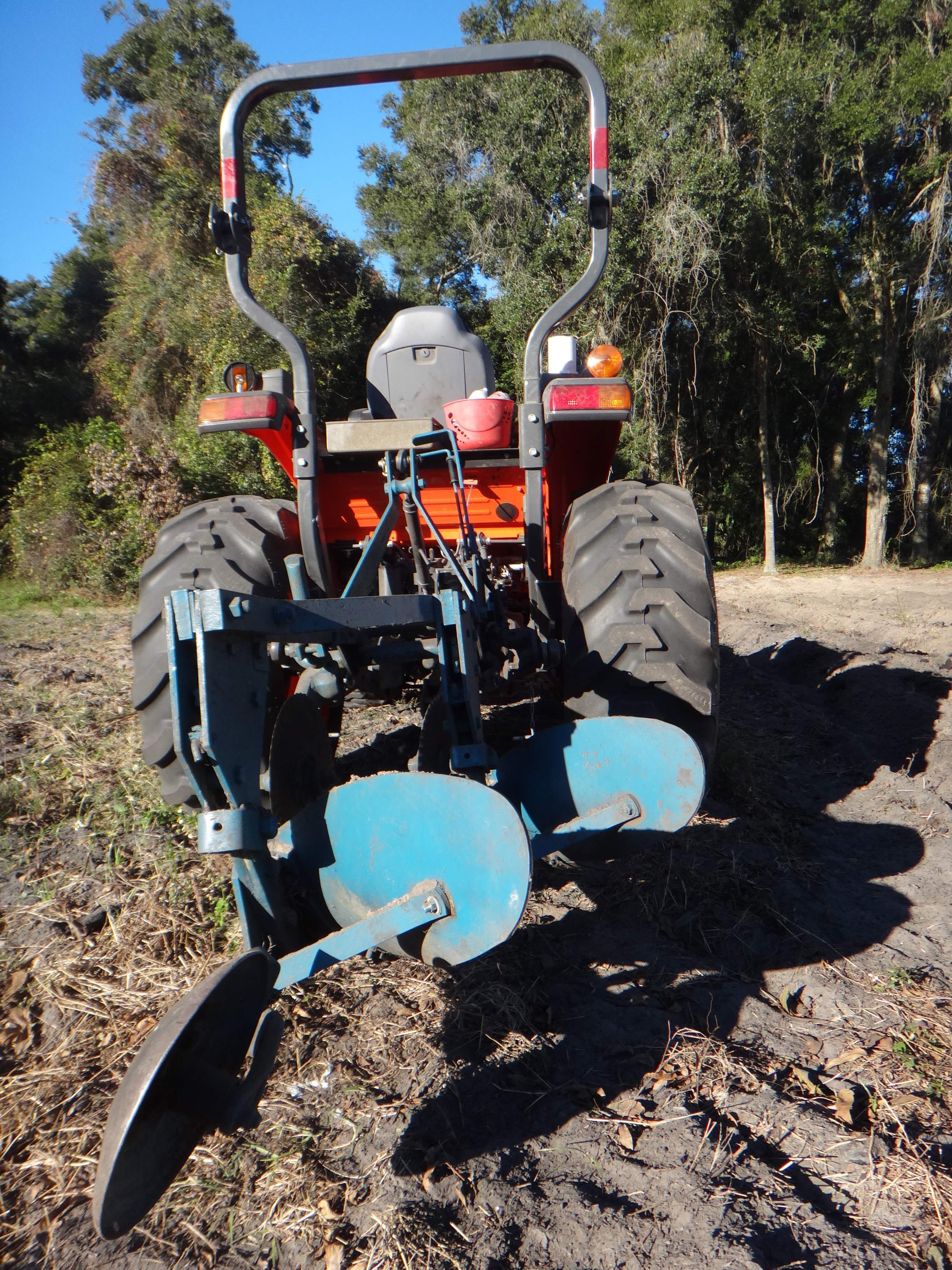

Plows are for opening ground, also known as sodbusting. Plows cut through the sod and invert the sod so the sod roots are up, hopefully killing the sod and sod root structure. There are two types of sod busting plows: Moldboard Plow and Disc Plow. (Disc Plow is NOT a Disc Harrow.) Plowing is the first step in preparing virgin land for agricultural use.
Cons: With the increase in no-till agricultural practices, using Roundup herbicide or equivalent, plows are mostly used just for opening ground, then they sit. It is getting difficult to find replacement wear parts for old plows. Learning to adjust a plow to invert ground correctly takes quite a few hours of experience and experimentation. After plowing the field has deep furrows in it, which require smoothing. Generally, a Disc Harrow is preferred to smooth furrows and mix the furrow soil after inverted sod has decomposed.

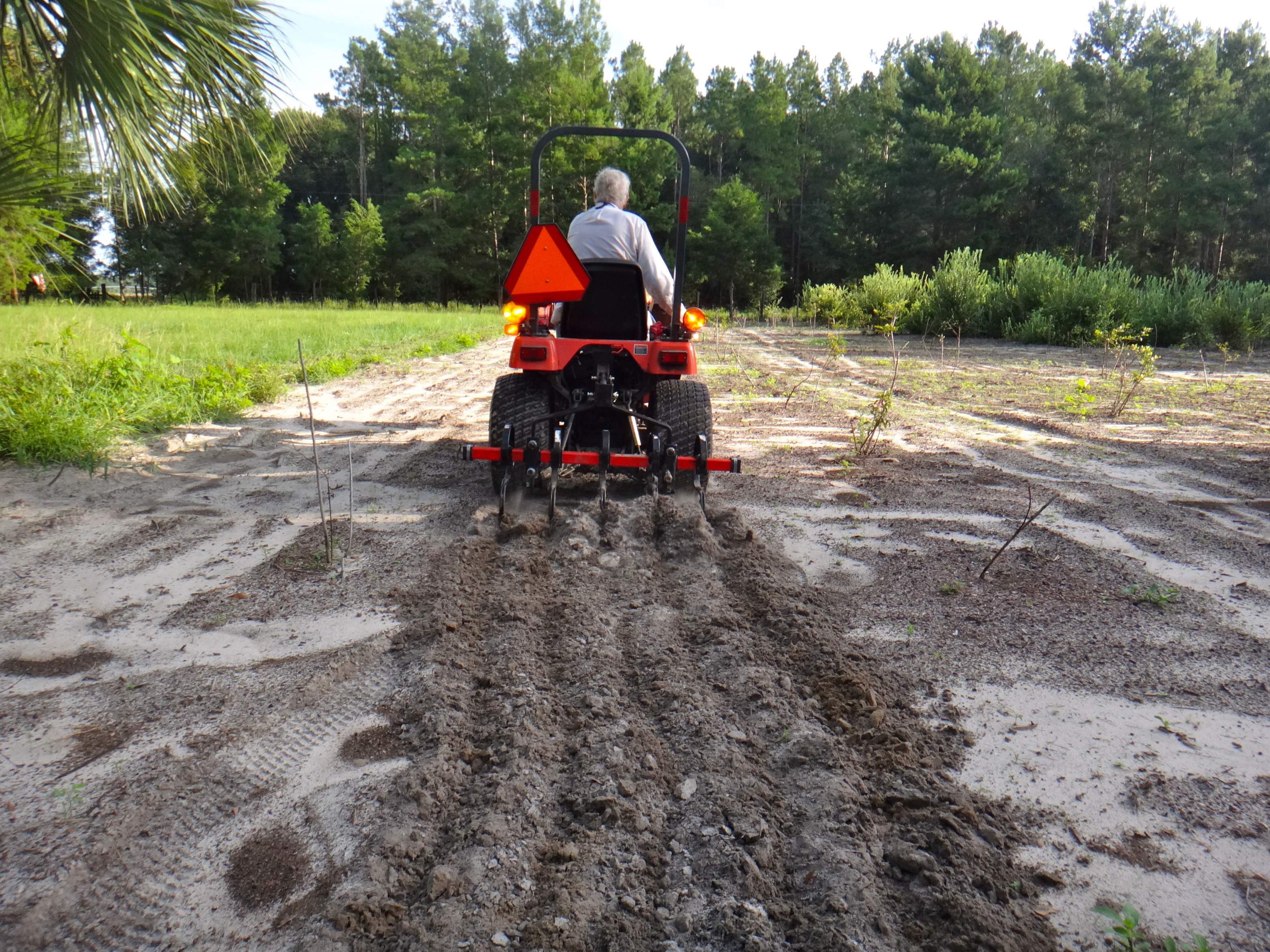

Cultivator tines pass through the earth in a mostly horizontal orientation. Cultivator tines will not penetrate unplowed ground. Tines are adjustable in spread, so tines can pass on either side of a crop row, pulling weeds, until the crop grows as tall as the tractors ground clearance. Cultivators weigh considerably less than plows. Using a cultivator requires very little skill. There are many different cultivator designs.
Photos #!,#2,#3 Kubota L3560. Photo #4 Kubota BX2230 cultivating blueberry rows.

A moldboard plow cuts and inverts the soil as in furrows , This is primary tillage , be it farming , food plots , gardening . There are row crop cultivators as bcp showed . Then there are FIELD cultivators with 4 / 5 bars of sweeps or shovels spaced so they work the ground the entire width of the cult . With a good harrow the F/C does a much better job than a disc . Understand this is secondary tillage before planting . Leaves the ground smooth, level good seed bed . Keep in mind a F/C SHOULD ONLY BE RUN 4" DEEP max . Hope to help . BTW . no mud ,will not work .

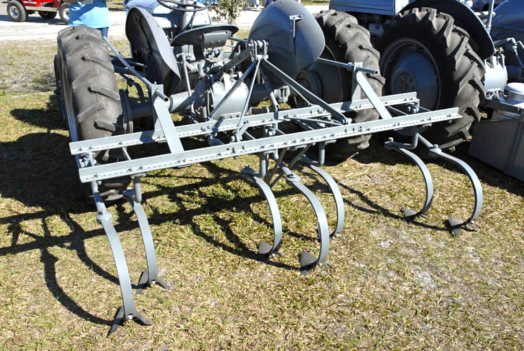

Are the very old (antique) Ferguson cultivators useful any more? Or just lawn ornaments?
/ plows vs cultivators #12
Ferguson used top quality materials and field tested his implements exhaustively. If you can find a Ferguson implement in good condition after all these years, grab it.
The Field Cultivator referenced by Ken Sweet in Post #9 is a copy of the original Ferguson implement, which Ferguson called a "tiller" and Ford/Dearborn called a "Field Cultivator". Designed and first built by Ferguson about 1934.
Ferguson CULTIVATORS are a bit different; see photo.
Ken Sweet occasionally offers original, old, Ferguson Cultivators.
