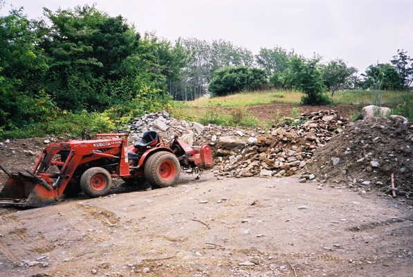

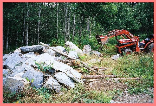

Rocks oh lovely rocks!
The roto tiller should have a slip clutch properly adjusted or use shear pins.
On my 42 in. Buhler tiller the large rocks are not a problem as the tiller bounces off them. The small rocks create problems if they are carried over and jam between a tine and the tiller shell.
Attached some pictures of areas I have tilled and some of the rocks removed.:D

I think Egon is spot on.
I know that when rototilling with a forward tine unit it will jump the large rocks and will occasionally jam a fist sized rock. With a properly adjusted slip clutch you will be okay.
For the cost of implements and the acreage you specified I would go with a tiller with a working depth about 8 inches and find a section harrow to smooth over seedlings.
I wouldn't think about chisel plows and disks for that size plot.
