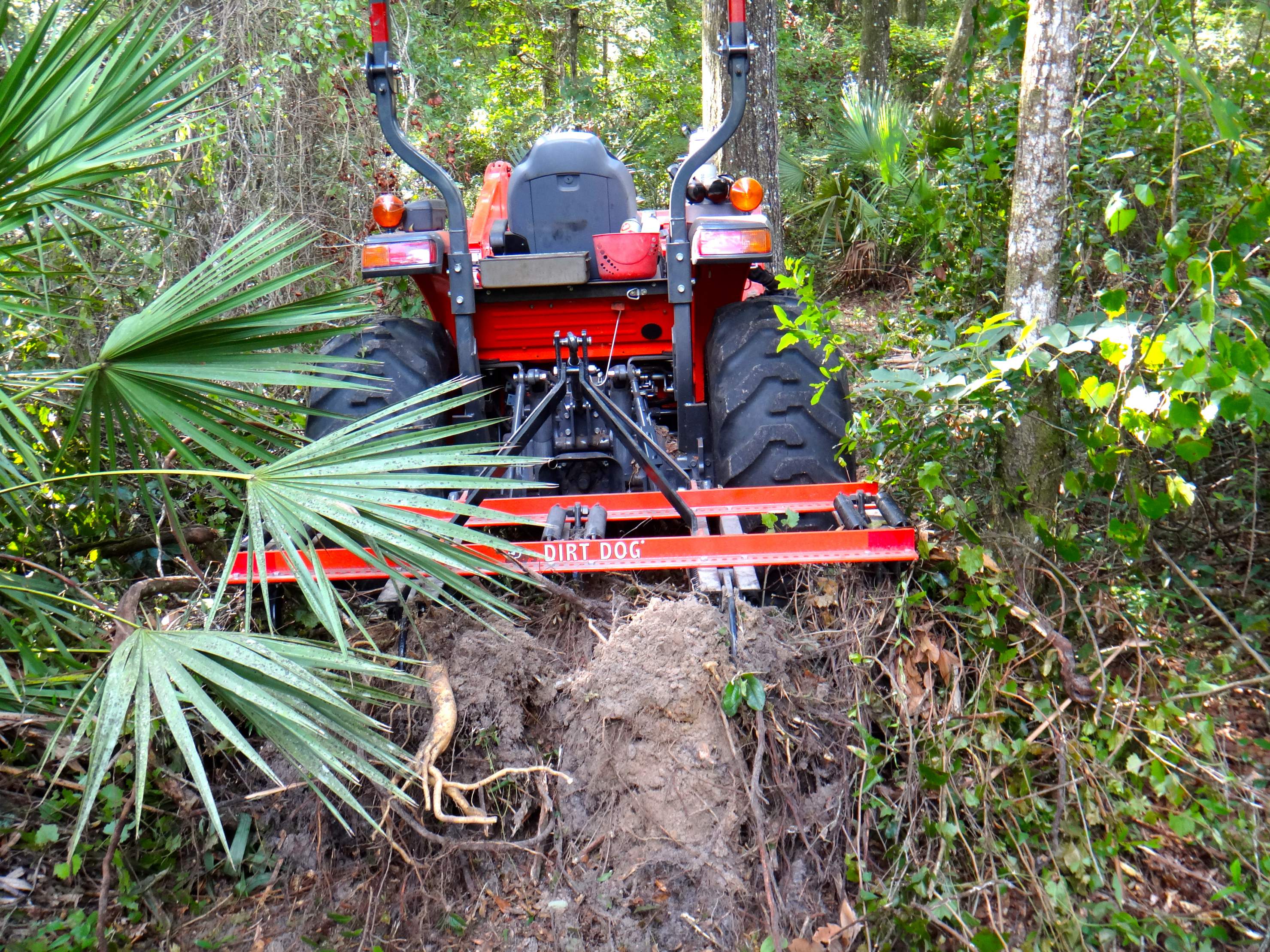

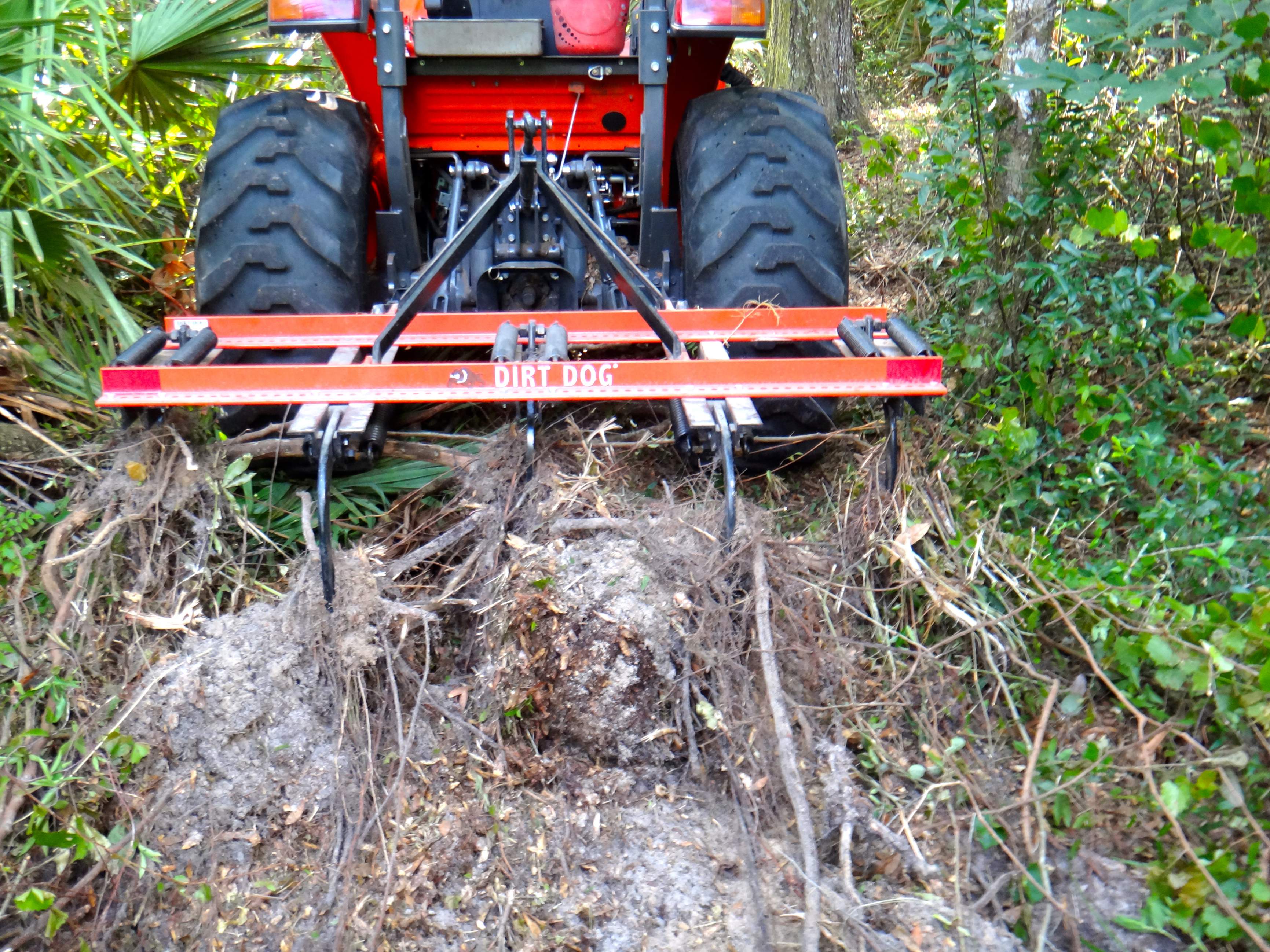

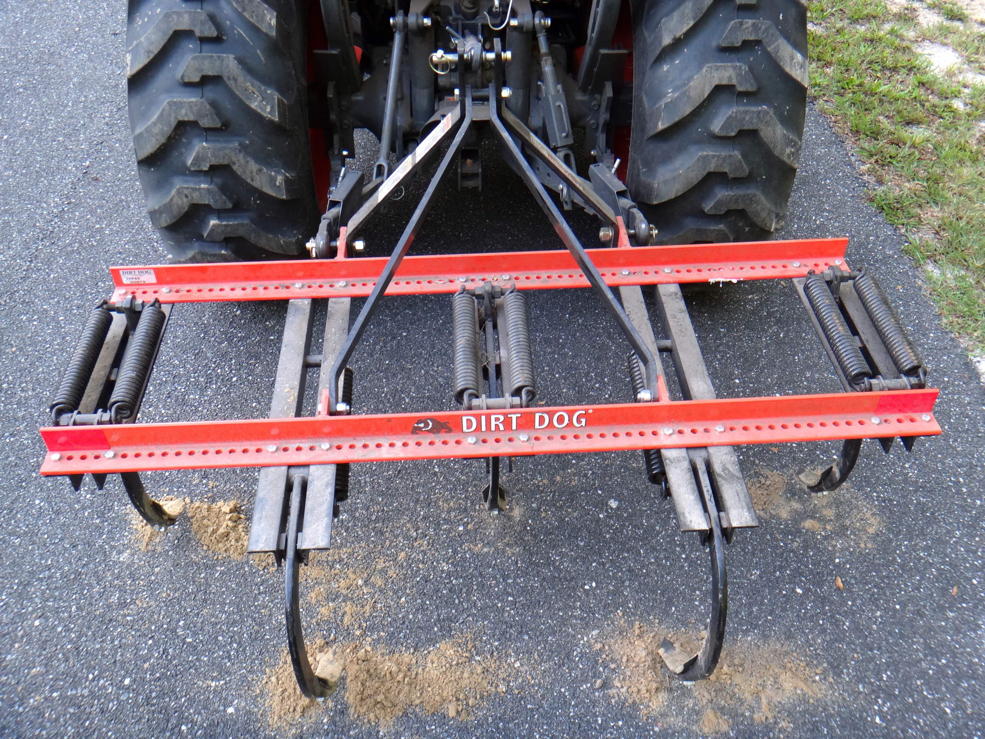

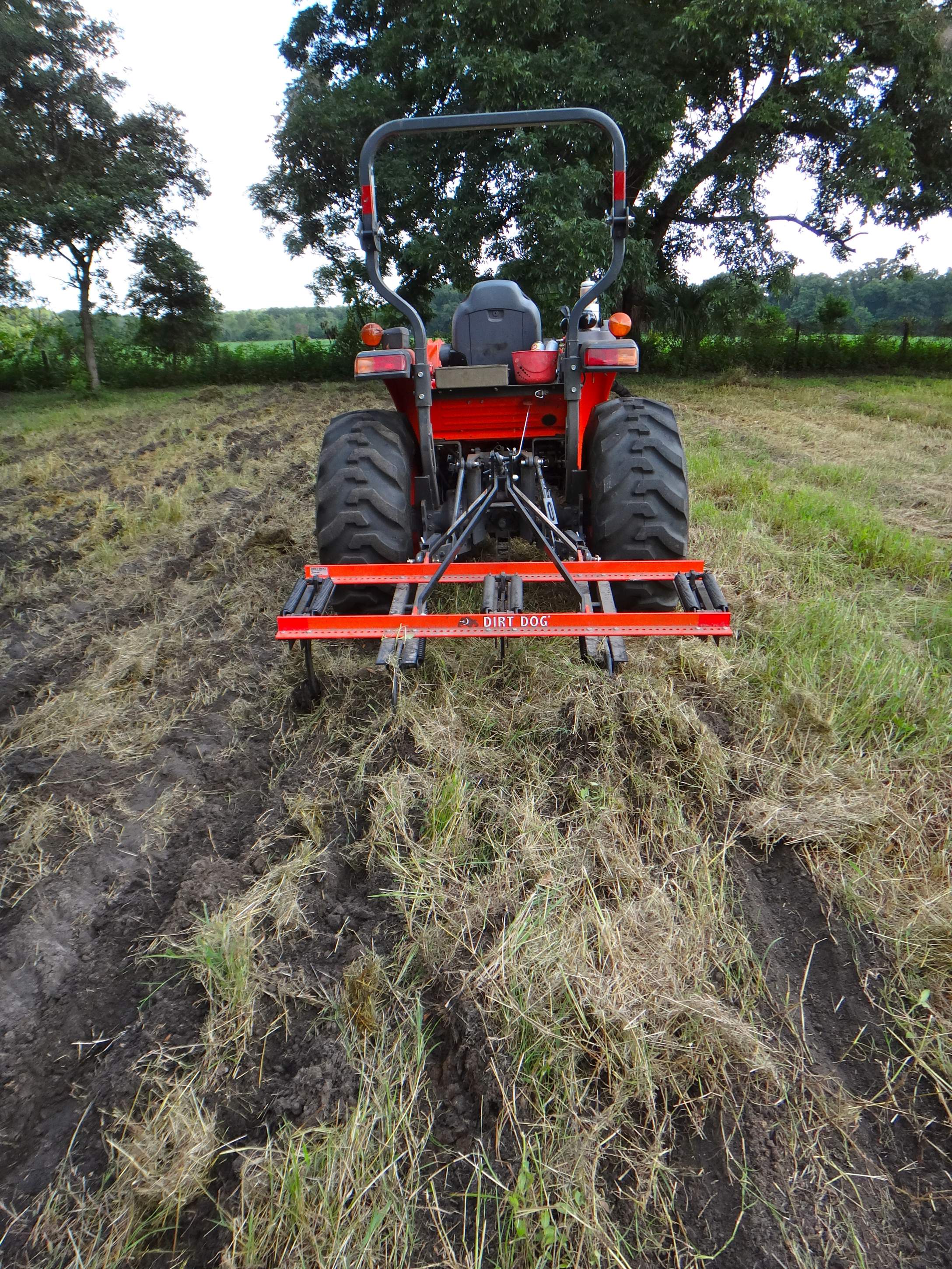

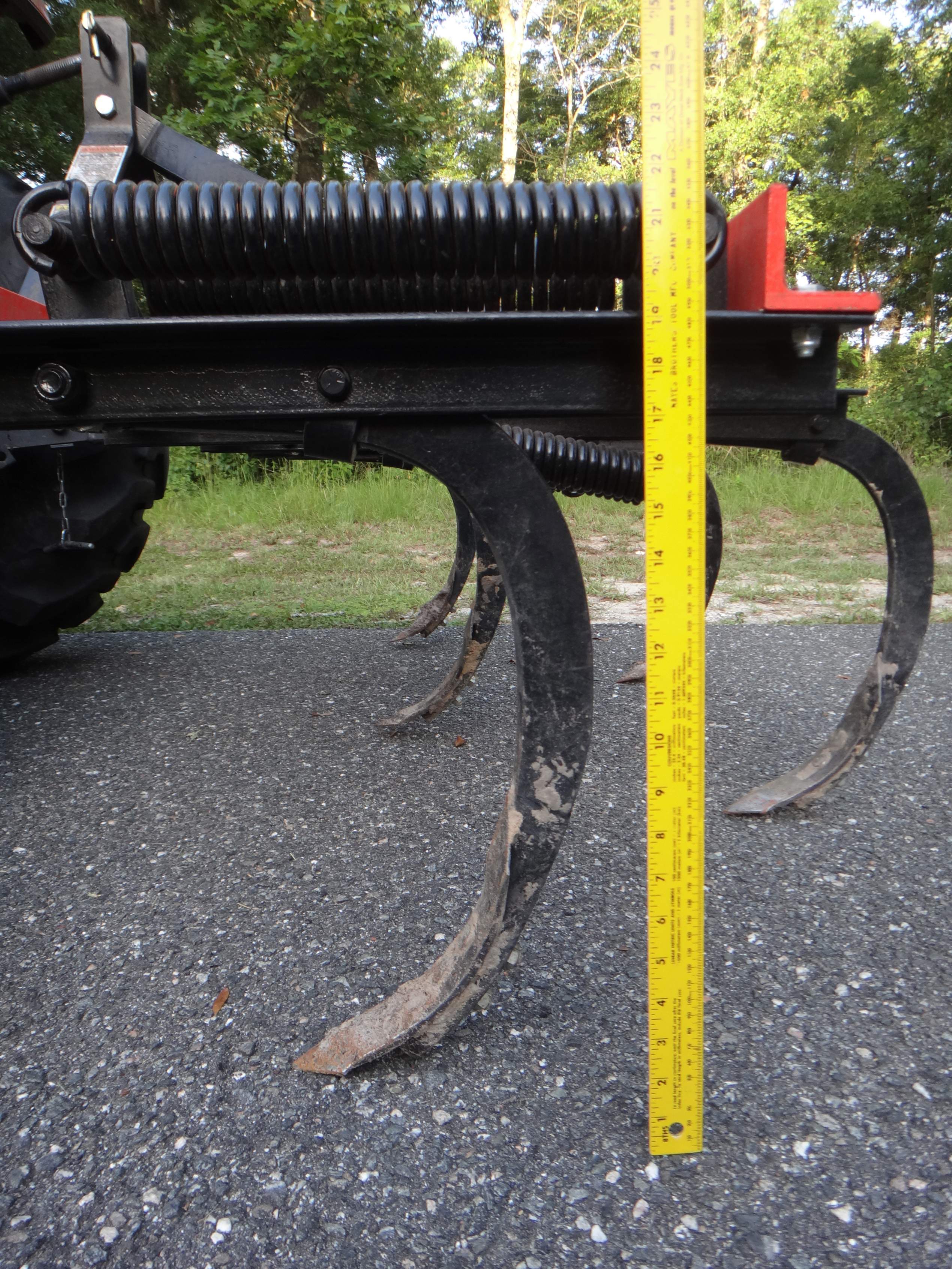

Also consider a spring-protected Field Cultivator. Tines of a Field Cultivator will penetrate 10" and require but half the tractor force to pull, relative to Box Blade shanks.
In the photos: 66" Dirt Dog Field Cultivator, AKA All Purpose Plow. (It is NOT a plow. It is a type of ripper.)
