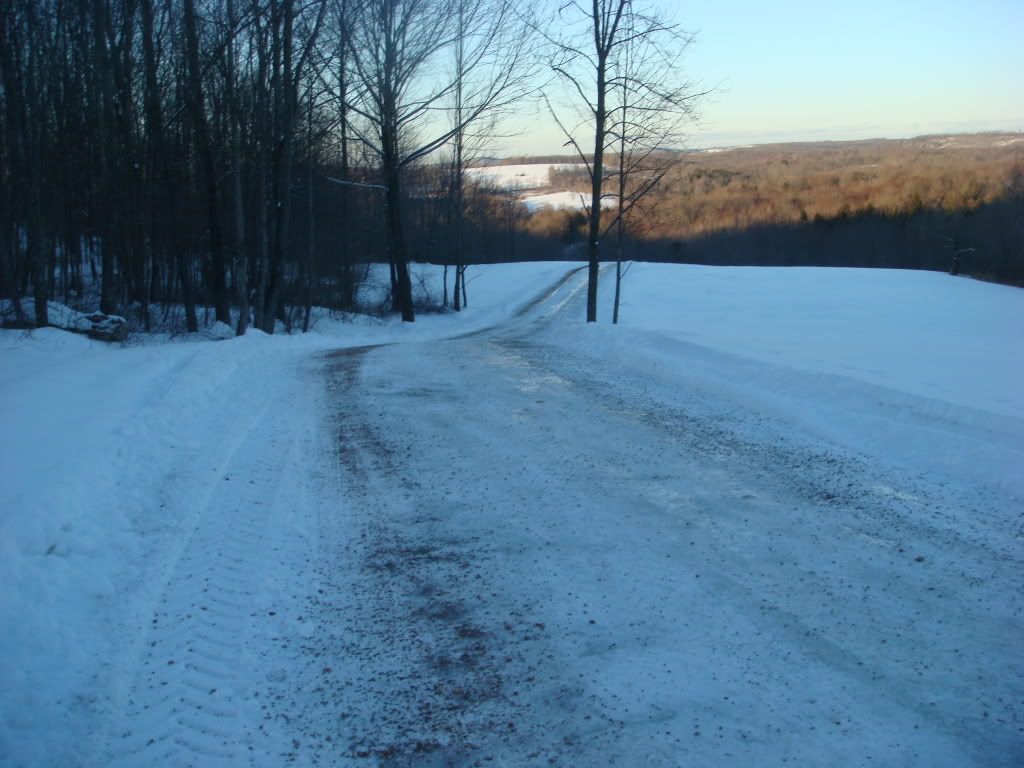

OK here are some shots of the handiwork. I did all this plowing in about an hour, and there was about six inches of snow on the ground.
In front of the house:
This is about half of the driveway:
The old farmhouse across the street:
The barnyard:
In front of the big barn. The PT's mobility really came into play here, as there are boulders placed along the road that I had to work around. A plow truck would have trouble in here.
   / plowing snow with the PT1460 #14
where is the machine in the pictures
