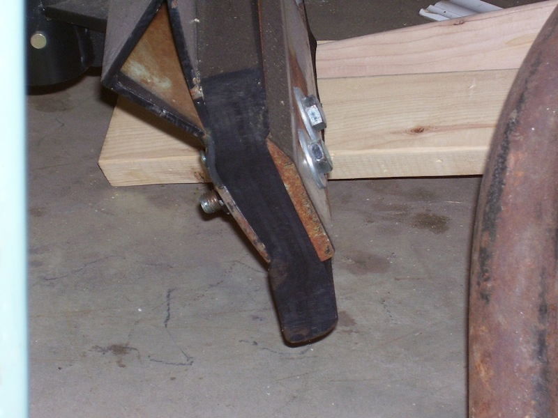

I added a piece of rubber (discarded by the local government snow plow crew) to the bottom of my plow. Doesn't scrape as clean as metal directly on the asphalt, but when the sun hits the driveway it melts any left over snow down to bare asphalt. Works great for slushy snow too.
