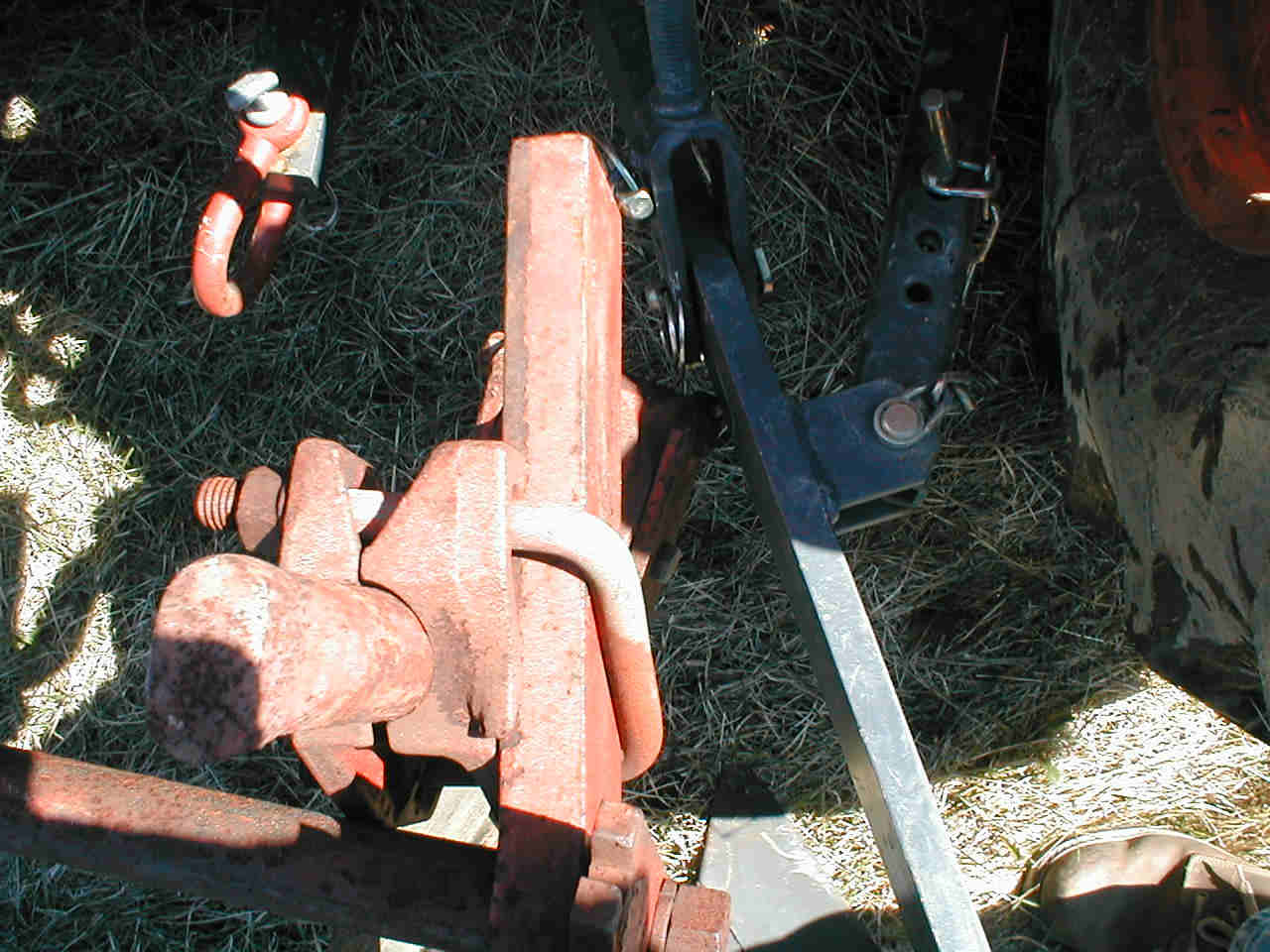

I plowed about an acre today. Here is a pic of the plow. It took some adjusting to get the plow functioning well. The narrow front wheels of my L4300DT required me to side shift/adjust the plow to the left so the first moldboard would have some ground to bite. I ran the left rear tire on a 7-8" cement block and adjusted the 3 point arms until the plow was leveled side to side and front to rear. This plow has a hand lever adjust which changes the direction the plow points. I found that plowing in high range, 2nd gear at about 2,000 rpm turned the sod over nicely. I fought with buried bailing twine (lots of it) which kept binding in the sod and dirt causing it to not release from the plow and create a giant dirtball that I had to stop and remove.

A picture showing the interference with the frame for the right coulter and the right 3 pt. arm BEFORE I side shifted the plow to the left. After adjusting the plow to the left, this was no longer a problem.
