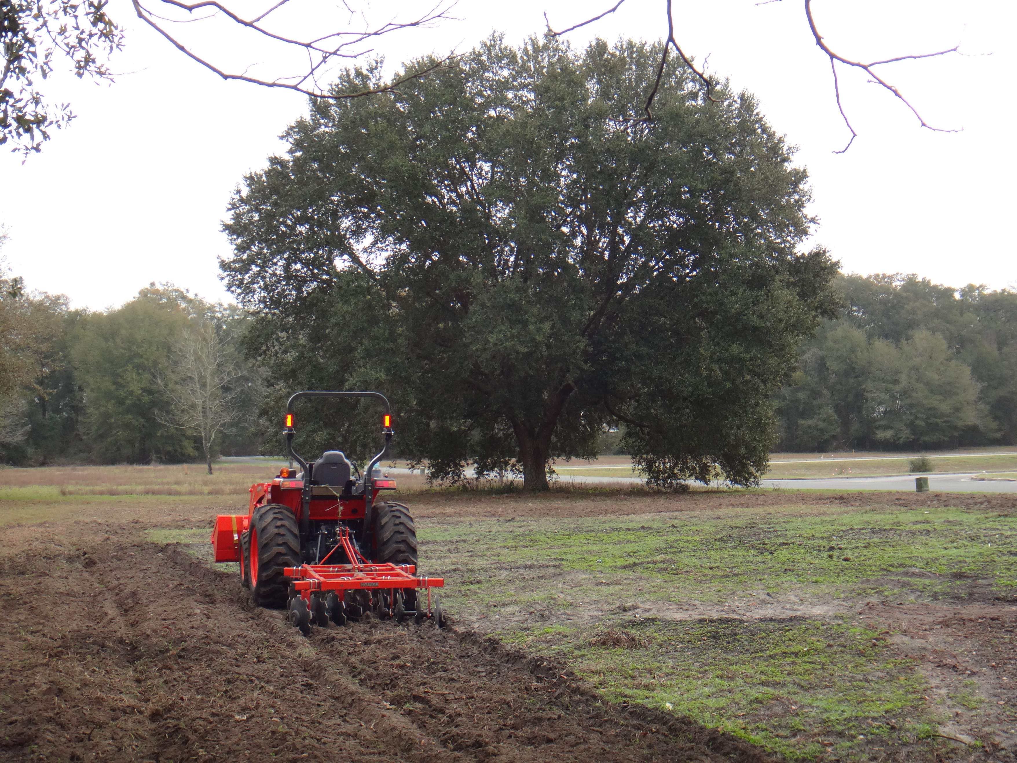

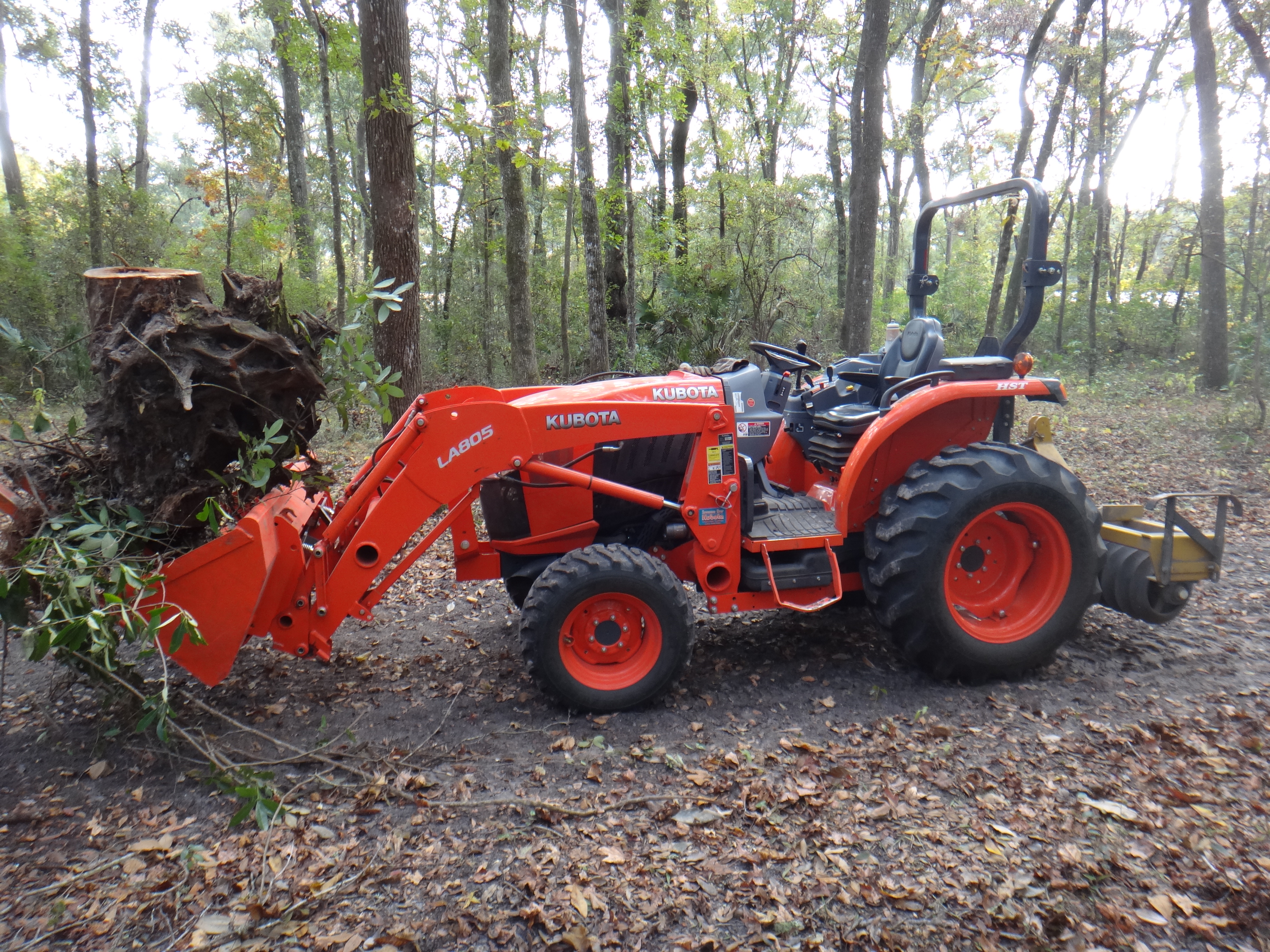

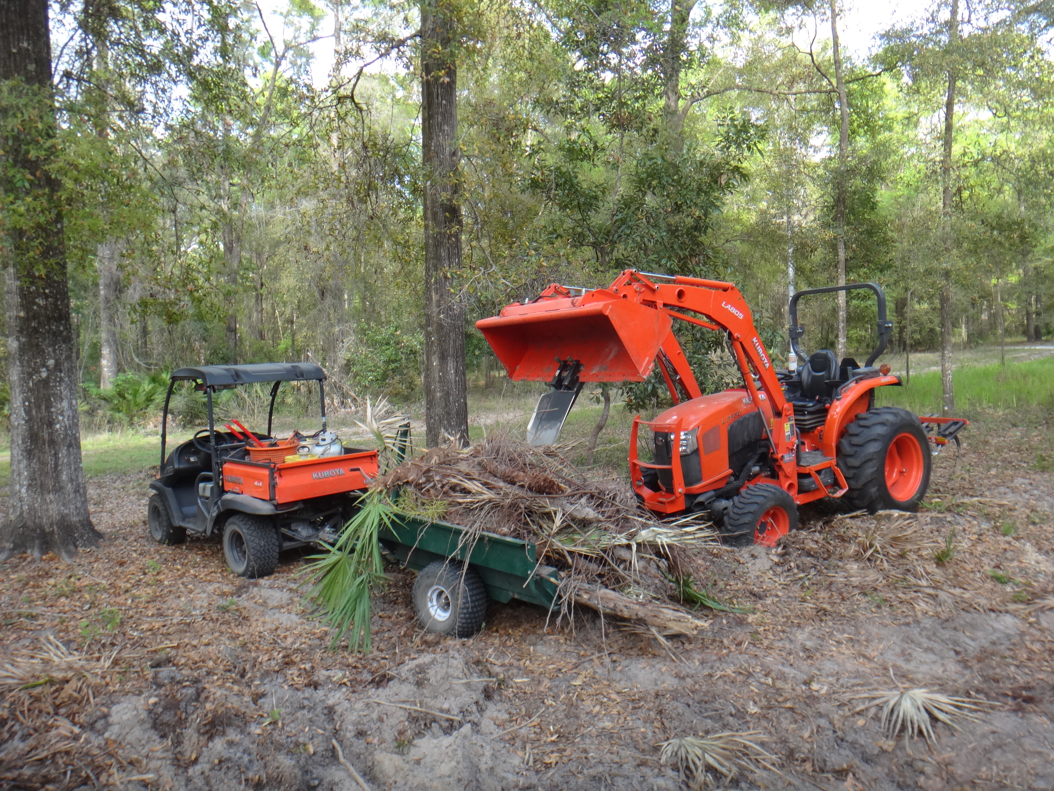

R4/industrial tires are a much smoother ride over hard surfaces.
Over soft surfaces, where R1 "bars" bite into soft soil, there is less difference.
R4s are marginally heavier than R1s loaded.
R1s yield a slightly wider tire spread than R4s, only for consideration working hillsides.
I am "way out there" in seeking to avoid soil compaction. I have never owned a tractor with liquid filled tires. That means I must carry counterbalance on the Three Point Hitch for any but lightest FEL work.
When pulling Three Point Hitch implements I minimally compact soil/lawns with air filled tires.
I never experience mud where i live in Florida, with perfect draining, porous, sandy-loam soil. This may sound lovely, but I have to irrigate six months of the year.
