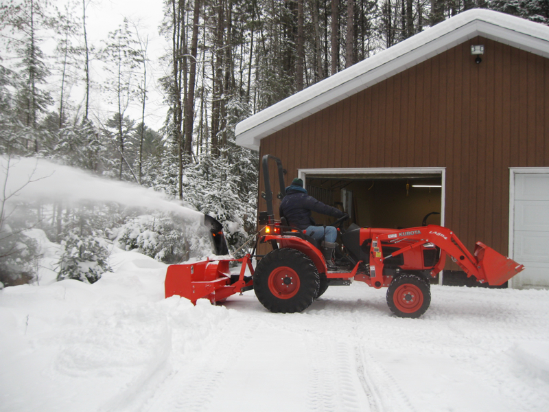

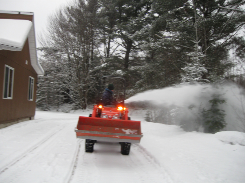

How about a third option.....
Snow thrower on the REAR of the B3200 HST?...
This is what I have and I love it. I don't find going backwards with HST a problem as I sit 'side saddle' and use my heel on the rear pedal. The rear setup is considerably cheaper than the front blower and I would think easier to find used if budget were really a concern. With the HST and manoevrability of the smaller tractor I find I can put the snow anywhere I want. Mine is a 64" wide model.
Here is mine in action....
You do need to wrap up well though with no cab....
Stewie

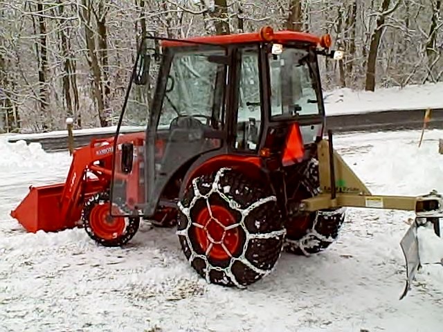

I was in a similar situation as you. I've got about a 200ft driveway but it is steep and paved. I plowed with a Toyota P/U then a Silverado P/u. My problem with plowing with a truck is that I needed to put chains on in order to plow. So, when the storm was over, I had to remove both the plow and the chains. I first used a BX25 with a rear blade to plow, then I bought a cabbed B3030. It was too cold for me to use an open station. The winter of 2010 was a blockbuster. I ran out of room to push the snow with the B3030 and back blade. I then bought a rear blower. I like the idea of the bucket for stacking snow and moving firewood, so the rear blower is great for me. I'm also able to keep the tractor chained for the whole season, if I want. It is nice having a dedicated machine for snow removal. Pic attached is of the block-buster winter.
