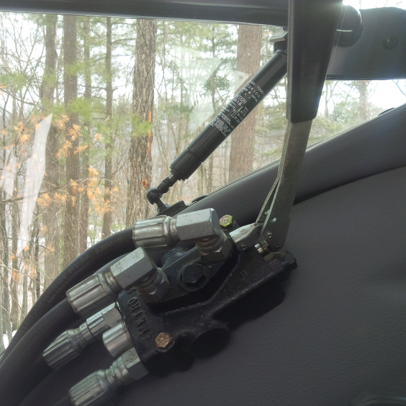

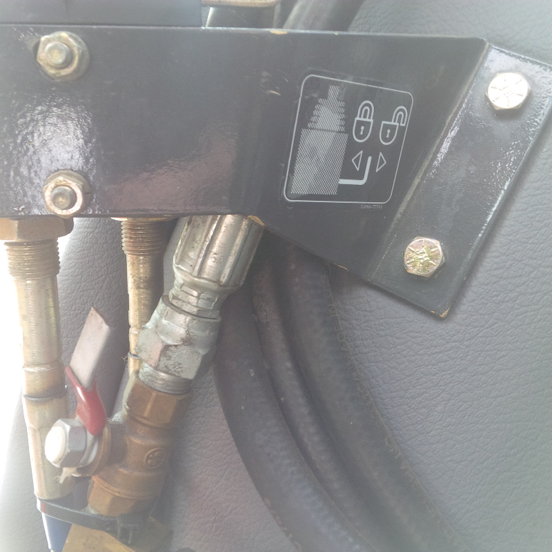

The FEL doesn't move left/right, hence additional controls. The plow is connected via quickattach and 2 additional hoses. Will check connections and brand in the morning. Picture of additional controls.
While I will don't know which way is open for the valve (despite the instructions), I played with all settings

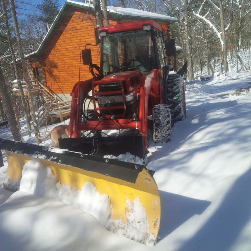

Plow pic
   / Plow only turns one way #10
Komrade, the ball valve in your photo doesn't look like something rated for hydraulic pressure use! If you can post a photo of you plow's cylinder(s) and the lines, someone may be able to help more. I have a single cylinder, and my plow (also a SSQA snow blade) will turn both ways even when engaged with a push pile of heavy snow.
