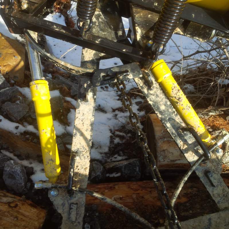

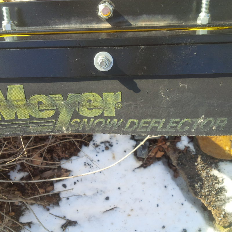

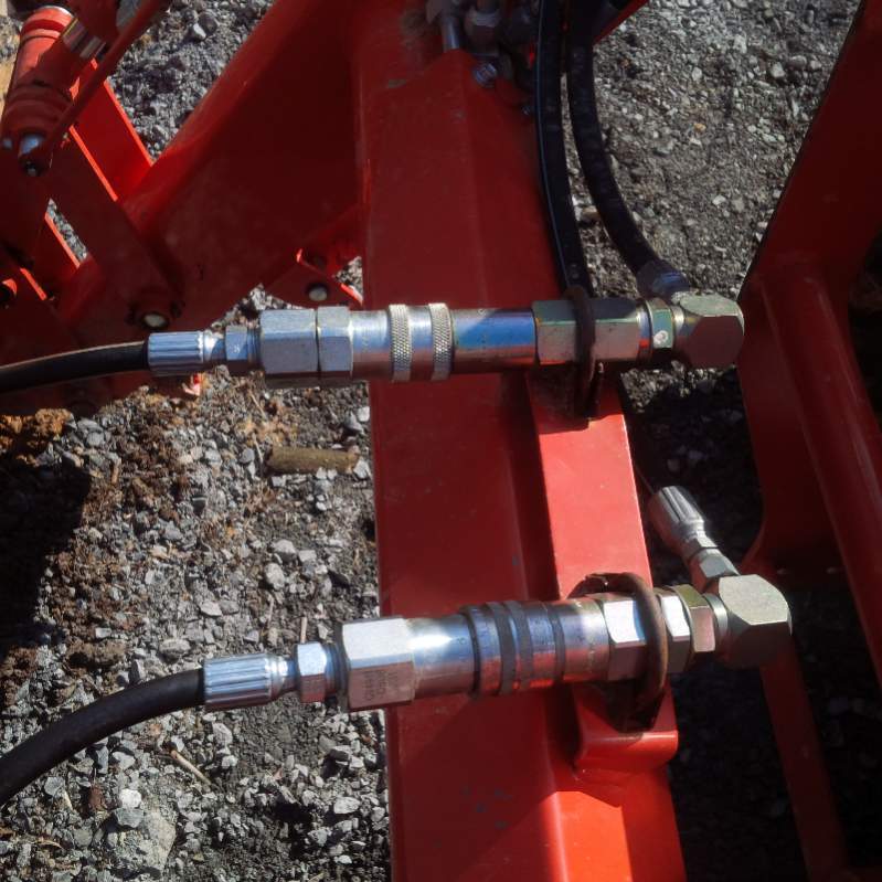

I am not sure of the plow's brand. That Meyer piece I took a picture off seems to be an after market addition. Here are some additional pics. Connections don't seem loose.
   / Plow only turns one way
#12
The answer is when you use the plow and turn that valve on, you have to turn off the flow to the backhoe.
It works now (and works well/fast), Thanks to my neighbor that came around to take a look.
We also talked about additional angling possibilities with FEL controls
Too bad I figured out the plow only in March :) Will get to play with it a lot more next year I am sure.
